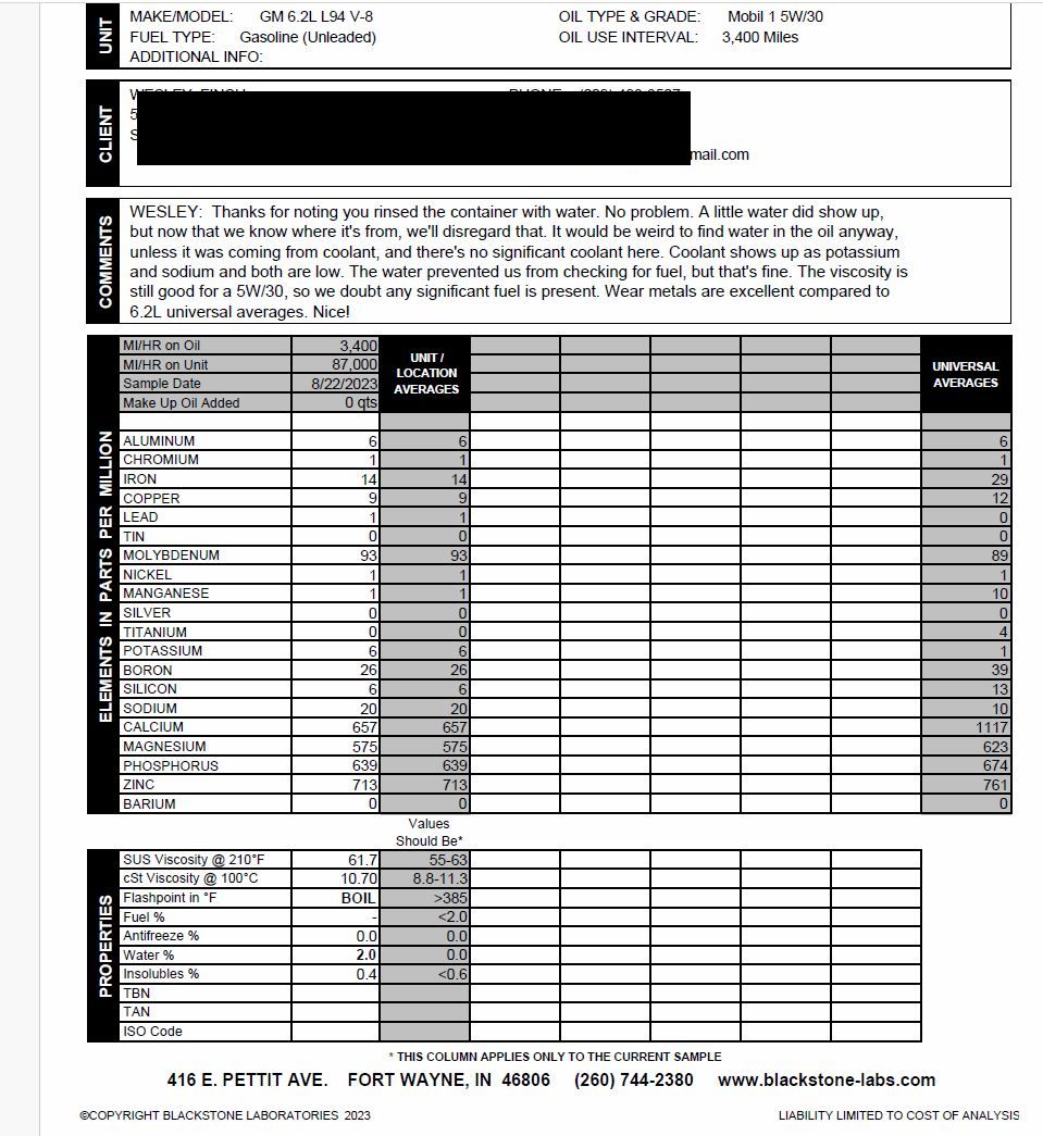

30,517
47,936
a test result would look like this, my sample had water contamination so they didn't check for fuel but was still fine
