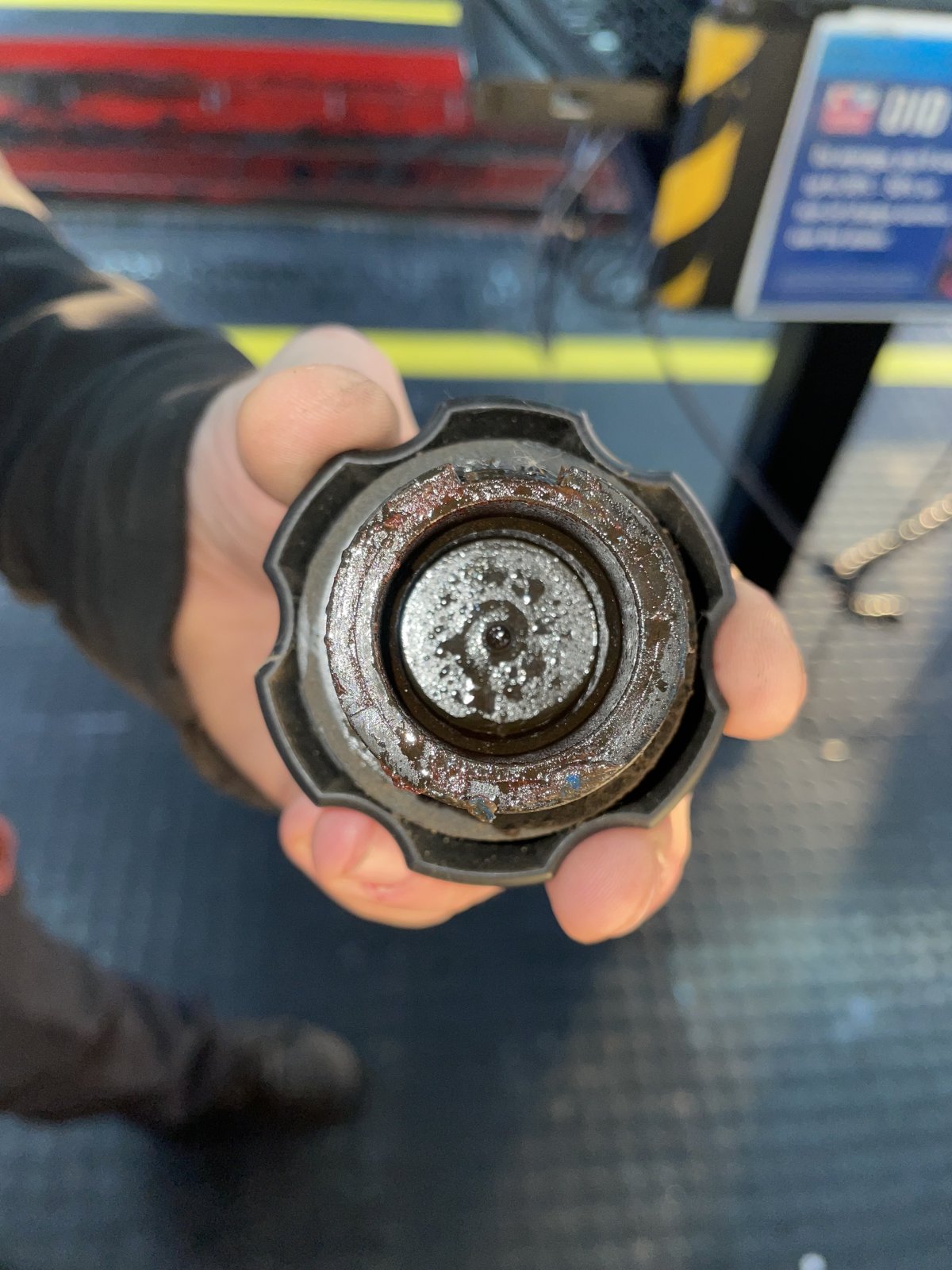

Just an update. Went and got oil changed today at valvoline. Since I posted this my oil has went from 37% to 32%. Got oil changed and did the engine flush as well. Mild condensation on oil cap. No coolant I don’t think.

Just an update. Went and got oil changed today at valvoline. Since I posted this my oil has went from 37% to 32%. Got oil changed and did the engine flush as well. Mild condensation on oil cap. No coolant I don’t think. View attachment 419275
I would pull that cap off again and wipe the inside off real good with a paper towel and post a picture of what the towel looks like afterwards.
hard to gauge the color with a black background. looks like oil but there is some redish/orange tint in the photo could just be the reflection. the inside center does looks like condensation but can't tell the color
also presuming that was before they did the flush?

I would pull that cap off again and wipe the inside off real good with a paper towel and post picture of what the towel looks like afterwards.
Next time I step out I will take a photo
Edit: will add that she is running like a top. Could just be the placebo effect tho haha
