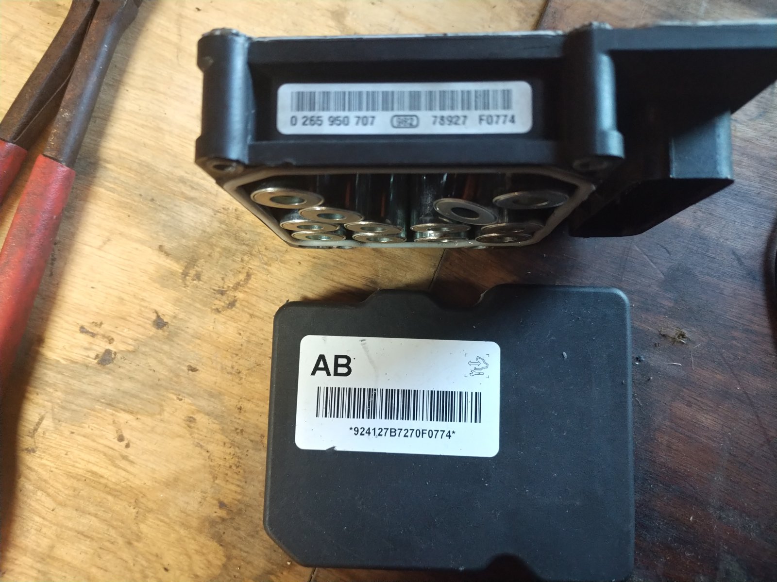

My 08 yukon xl aside from giving me the electrical gremlins has been a great truck. But recently I had to replace the abs control module and now about every 3rd start i will get 33 audible dings in a row. now I have not had it programmed as of yet because of this whole virus thing and everything being closed and what not. but they assure me driving it without it being programmed wont harm anything it will just be disabled. But could these dings be related? I am assuming they are as it never did it until after i installed new abs module.

I would assume, probably shouldn't but, the "they" you referred to is a tech or service writer at the dealer or shop telling you no harm will come by driving, should also be able to tell you what the 33 ding noises are. If you belonged to ALLDATAdiy.com you could get all info for your rig for a year for less than $30 and then have access to all info that shops do for your vehicle.
Have you also looked in the owners manual about this?

abs module shouldn't need programming, if it was replaced with the right module. not even sure if you can use one that is not identical to the old one

It was identical to one I removed. Dealer said it needs reprogrammed to vehicle. I'm going of what my buddy said who is a tech at a shop...

I could be wrong but I am pretty sure it does not require programming, the part number has to be a 100% match to your old abs module, not just look the same. unless something changed from nbs to nnbs, I swapped 3 on my nbs and never had to be programmed.

I don't know anything about the ABS unit but I'd take apart the old one, see if there's a plug in control module or circuit board that could be put in the replacement. The vehicle might recognize it and good to go - and stop.

Well I took it apart to see if was fixable. I read about cold solder joints on some that was doing what mine was with the abs and traction control lights coming on and dinging every few seconds which was annoying. But once I got it apart I realized it was nothing like that circuit board. So once it was apart there was no turning back

Also I looked at my old abs module. There seem to me different numbers. Which would be the actual part#
