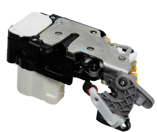

The ajar switch is part of the door latch, will have to replace the whole assembly.

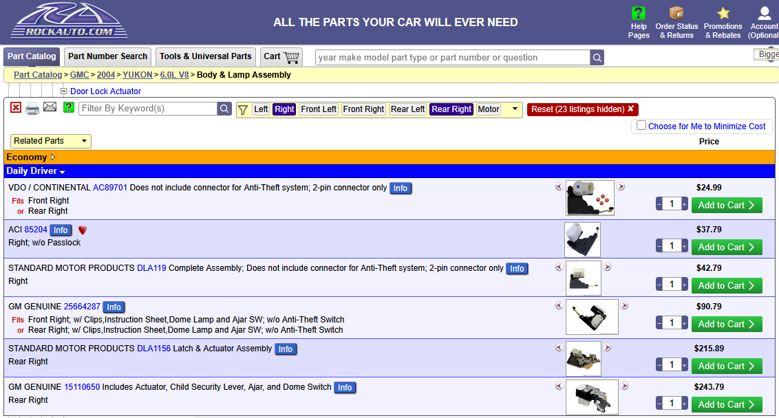

OK, @OffBrandCornDog, @915_Tahoe knows this stuff cold.
From GMPartsDirect.com, I this:
Passenger Side Rear Door Latch​
Part Number:
15110650
GM
Positions:
Center right
Other Names: Door Latch Assembly
Replaces: 15068503, 15761420, 16637324
Description: Silverado, sierra. Left. Without power locks. Suburban, Yukon XL. Right. Tahoe, Yukon. Avalanche. Escalade, Escalade EXT/esv. CREW CAB.... (...)
MSRP $348.25
$231.82
