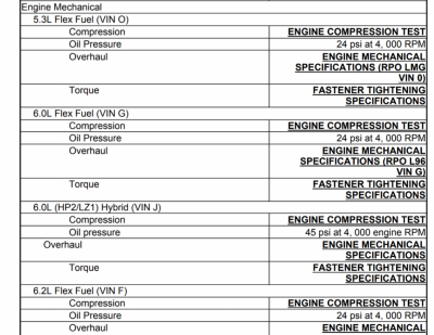

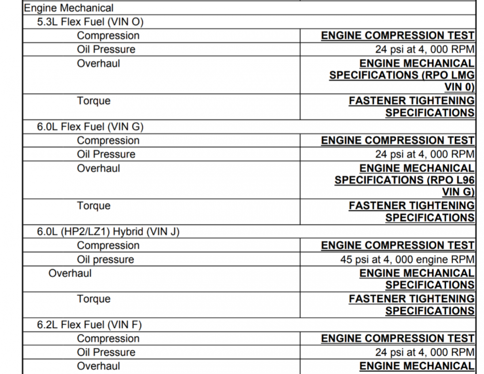

found this under common specs and procedures in my manual Screenshot_20200331-164604.png

As long as your over 20 psi your fine. These engines have lower pressure pumps.
Interesting. Even the LQ9?
Its not that I am concerned that its going to blow up tomorrow, more that @ ~200k miles and 15 years old I figure that I would rather do this before it becomes a real problem.
SnowDrifter
Sep 5, 2016
2,492
2,941
Sasquatch Country
33@hot idle is fine. You want it north of 30. Disregard the GM specs.
You have the same issue I had. Mine would fluctuate a bit, though mine was also verified with a mechanical gauge. Hook it up on your end to see if it's electrical or mechanical.
What I found on tear down was that the oil pump had some cavitation wear on the pump/rotor as well as scoring where the relief valve started to stick. New oil pump was the fix for my particular issue.
