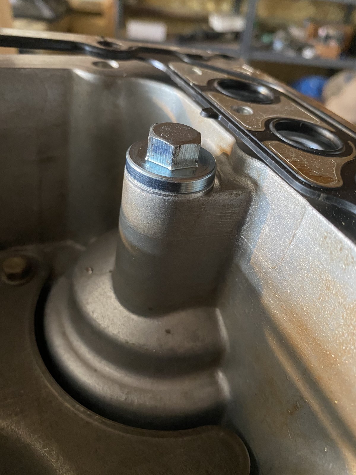

This sounds like a tell tail sign of a weak oil pressure relief valve spring (not the one in the pump - it is the one in the pan). It is THEE most missed and overlooked problem when it comes to oil pressure issues on these engines. In time your pressure may go down to zero or close to it and the low oil pressure alarm will ding. When/if that happens - it won't be the end of the world, because it is kind of a false reading. A weak pressure relief valve simply will dump more oil into the pan and it won't reach the sensor. You must drop the pan when changing this - so it is prudent to change the pick up tube o-ring while you are at it..
It is #455. Part #12594579.. OR you can simply install a plug and never have to worry about oil pressure again. My Tahoe did all of the above - and I changed everything (pump, pressure sensor and filter screen, pickup tube o-ring) before I studied the oil system and discovered the relief valve in the pan...

I plugged mine with (appropriately enough) an oil plug. Used aluminum crush washer and red Loctite:
