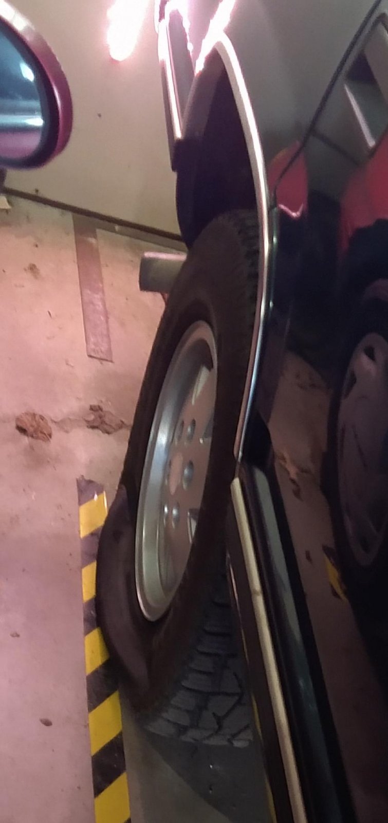

So, I aired the tire up ....
Stern has a slight list to starboard.
That's about as flat as a tire can get. Not fun. Aired it up and will see how long it holds. Hopefully I'll be able to drive it to a shop because I really don't want to deal with it here. The two fronts are low too, but nothing like that.
Not looking forward to buying new shoes either.
... and let it sit for two days. No sign of air loss again. Drove it 60-70 miles into town and back. It's been sitting for another couple of days. Still no sign of air loss.

Or again yesterday.
How can it only leak or go flat so rarely? Penetrated object wiggling and sometimes sealing? Valve stem intermittent?
