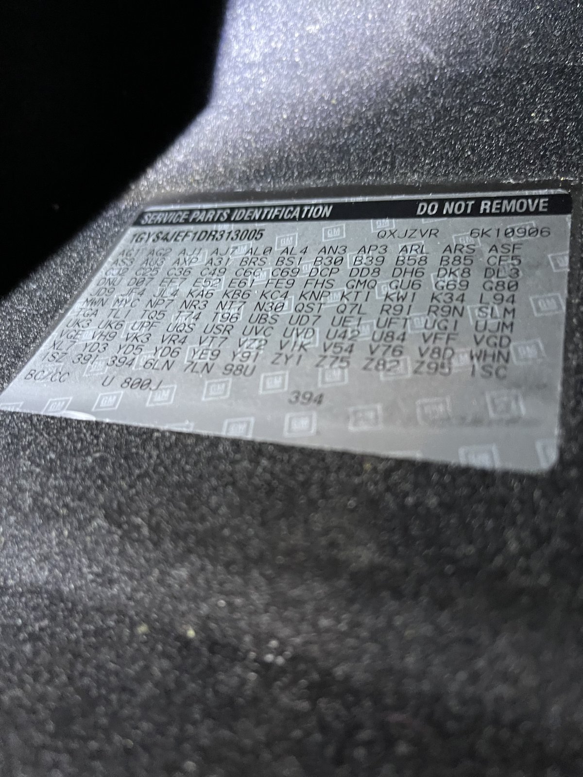

This is a terrible photo from my phone of the RPO codes, but it will work.
I will reply to all your comments the next time I am at my PC.
Thanks!

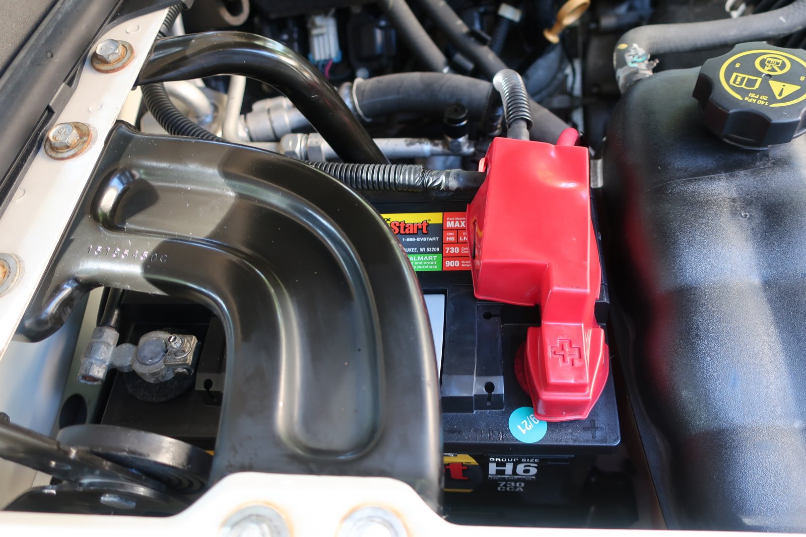

Yesterday: replaced the battery, installed an EverStart MAXX-H6. The old battery tested good, but I had no idea of its age. I sucked out the PS reservoir and refilled it with Lubegard 23232 synthetic PS fluid and 4oz of SeaFoam HydraTrans-Tune. I like it for helping to clean out sludge and such.

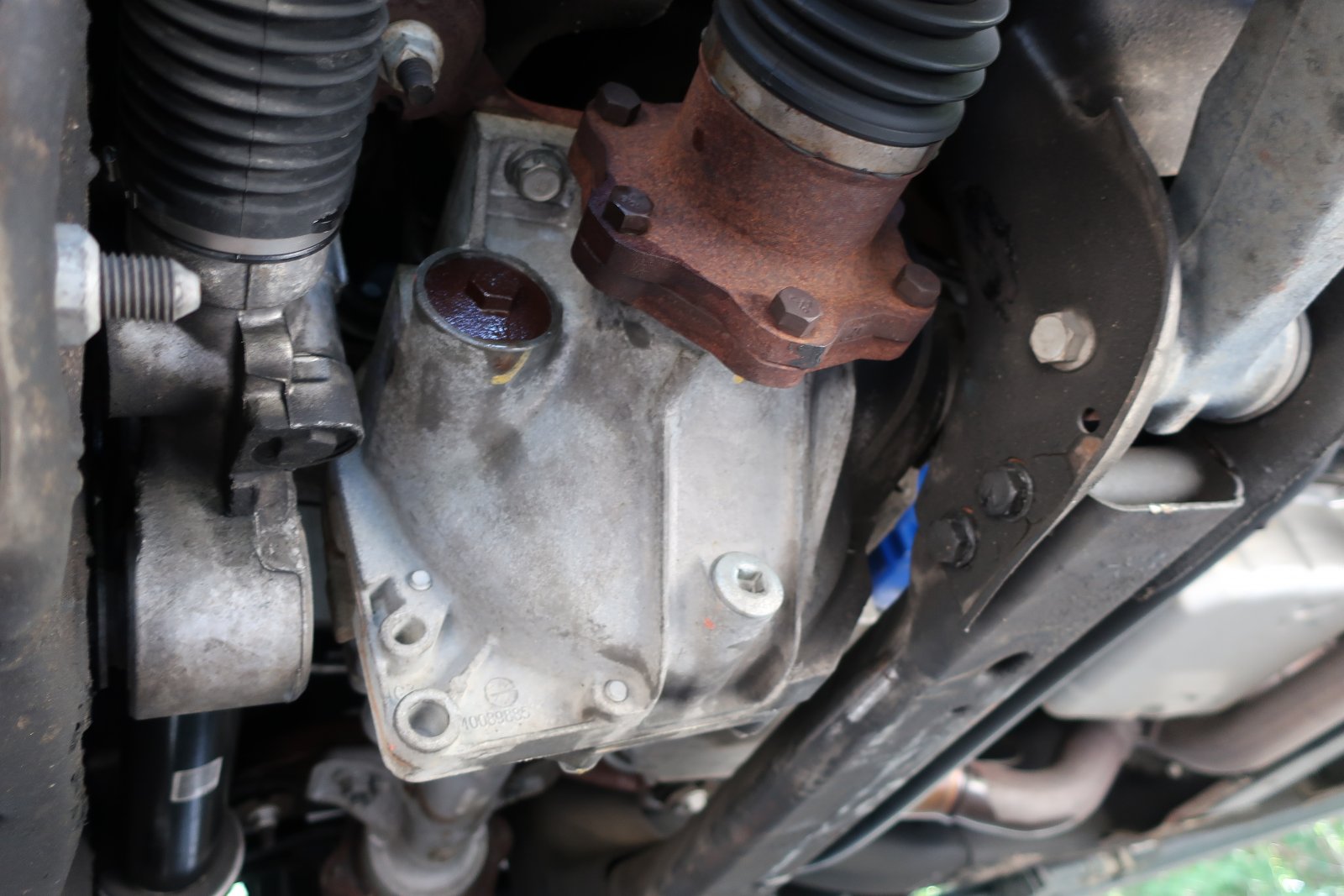

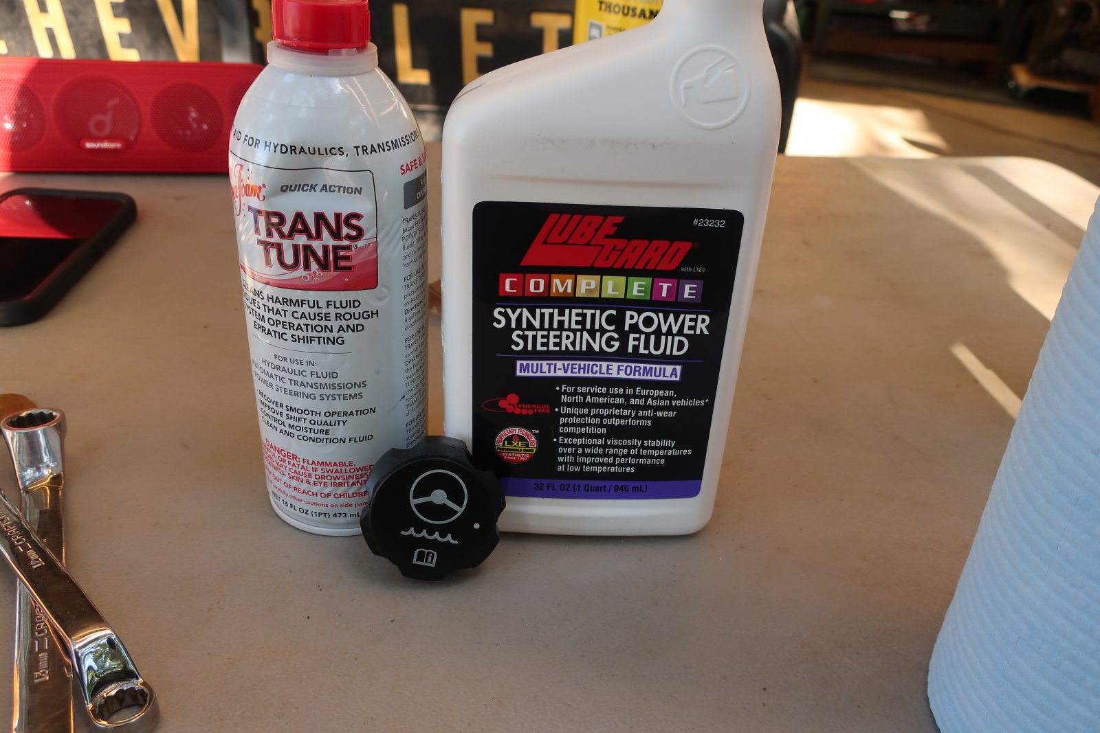

Today: refilled the front differential with Mobil 1 Synthetic 75W-90LS gear oil and refilled the AWD transfer case with ACDelco Dexron-VI full synthetic ATF 88865618.

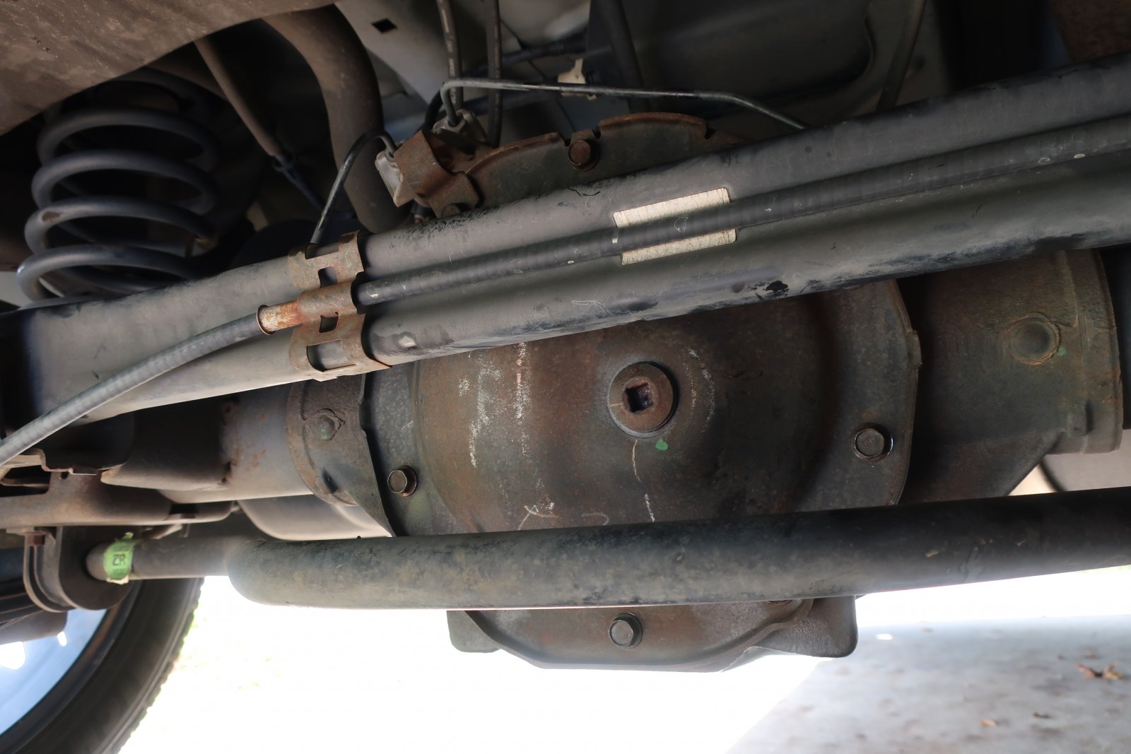

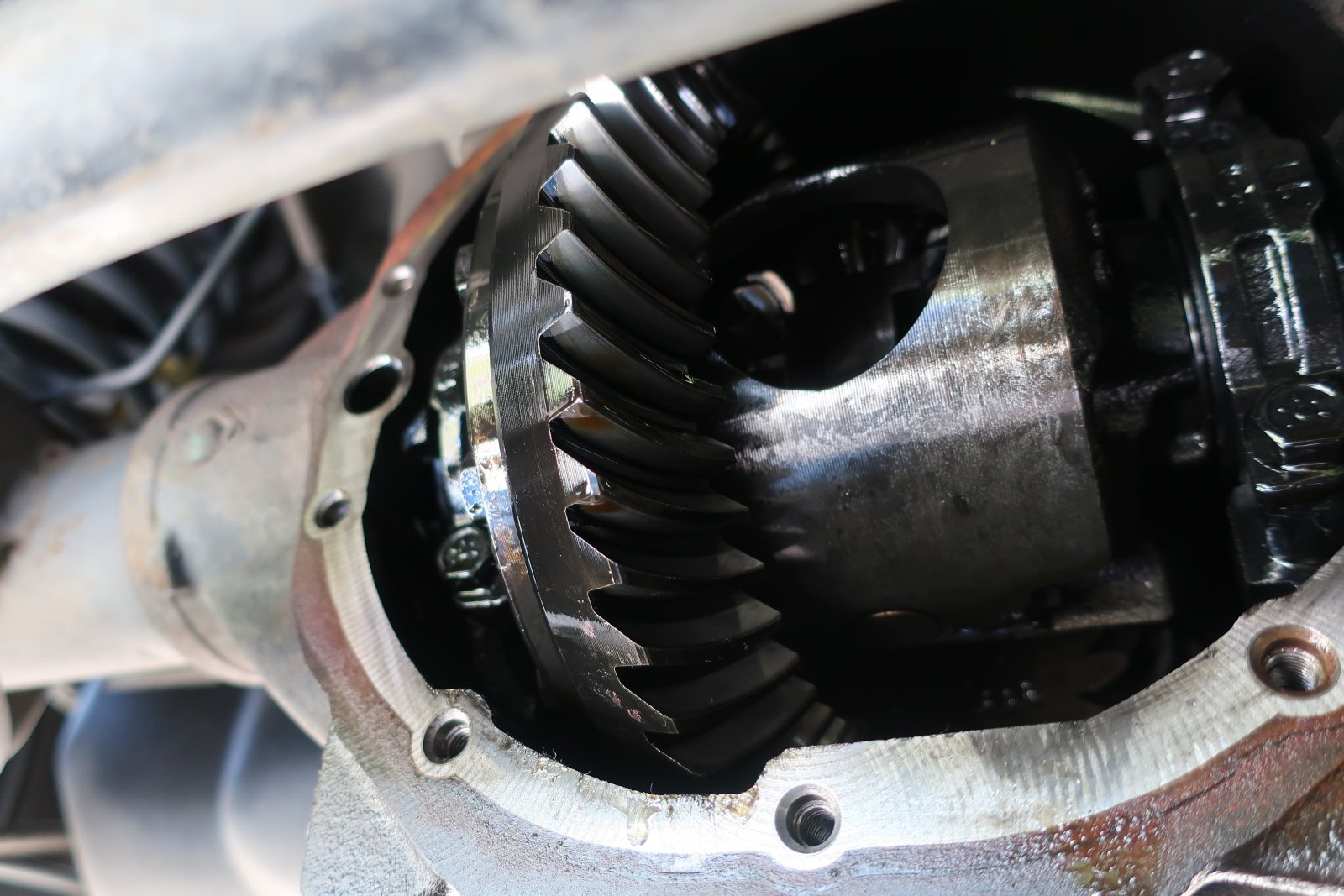

I removed the cover from the rear differential to drain the fluid. It did not look bad at all. It was the color of old gear oil, with no real fuzz on the magnetic fill plug or on the magnet inside the cover. I did get a look at the G80 locker in the rear differential. I am going to have to educate myself on how a locker works vs an LSD. Glad I have it, though.
As for the rear axle, I am not 100% sure, but I am pretty sure it is the 8.625" diameter ring gear unit. I can't figure out which RPO code is for the axle itself. However, my circumstantial evidence:
RPO C6C: GVW rating - 7400 lbs
10 bolt differential cover with reusable rubber/steel gasket
No drain plug at the bottom ( only 9.25" axles get that.)
Soo... that is what I think.
Anyway, it is full of fresh Mobil 1 Synthetic 75W-90 LS gear oil.

New battery install.

PS fluid change.

Front differential fluid change. I put a bit of oil on the fill plug to slow the rust.

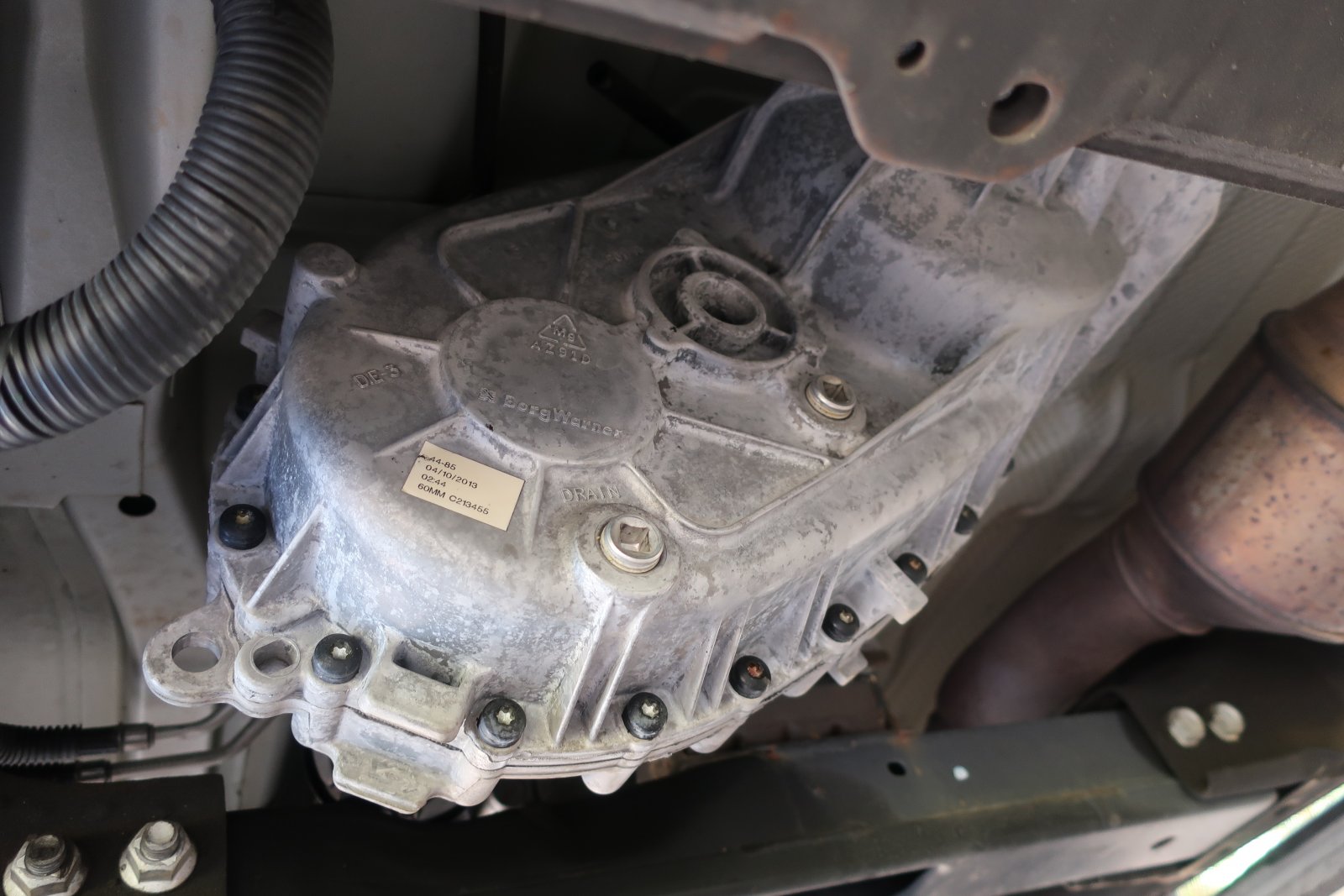

AWD transfer case fluid change.

Rear differential fluid change.

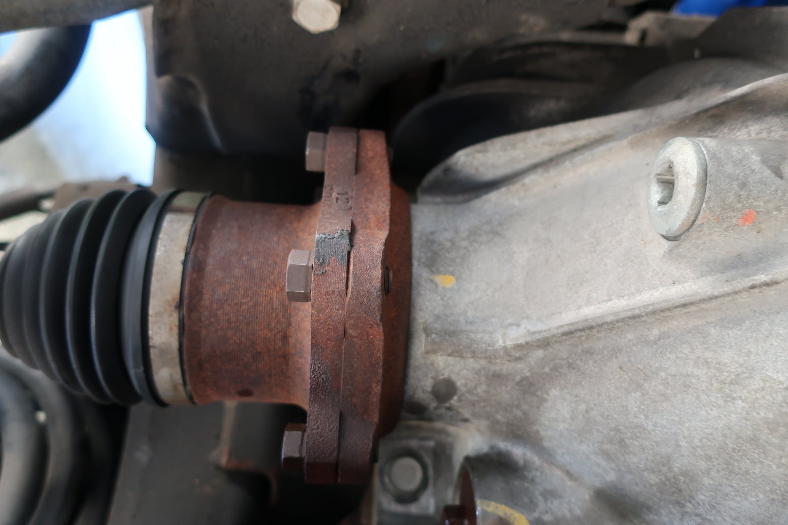

Now...I did run into what may be my first real issue with this SUV. I think the front differential left side axle bearing is loose.
I have started a separate thread on it in the engine/drivetrain section:
https://www.tahoeyukonforum.com/thr...erential-left-side-axle-bearing-loose.129896/

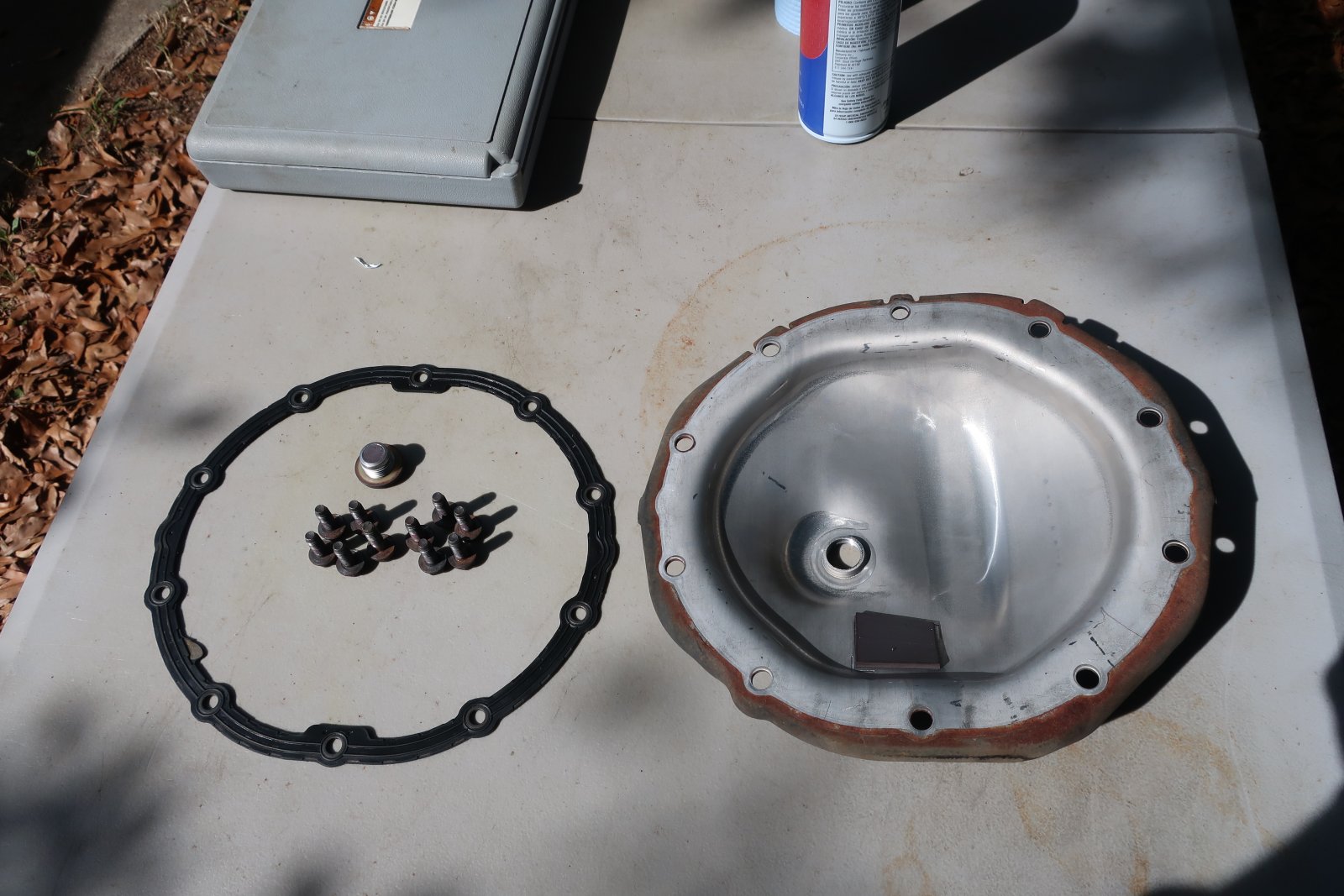

More photos here:
Rear cover, gasket, and hardware cleaned and ready to reinstall. NOTE: that rear differential cover is some THICK metal! Thicker than the GM 10-bolts and Ford 8.8" rear ends I have been dealing with.

Had to get a look at the G80 locker in there...
This is the front differential left side axle output flange I referenced above and am talking about in my other thread.
