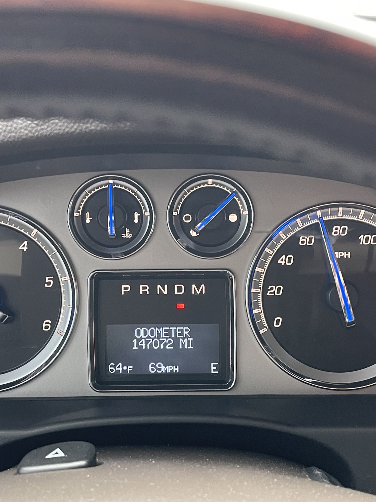

Well…she is all my problem now.
24 month/24,000 mile powertrain warranty has now expired.
:p
