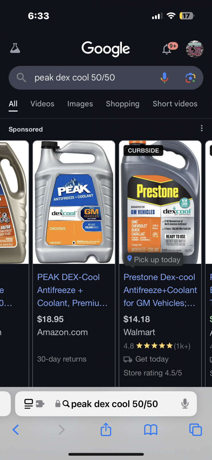

This is the coolant I used. Ready to use. One of these. It took two gallons all together. I imagine bc there’s some in the block and pump?
