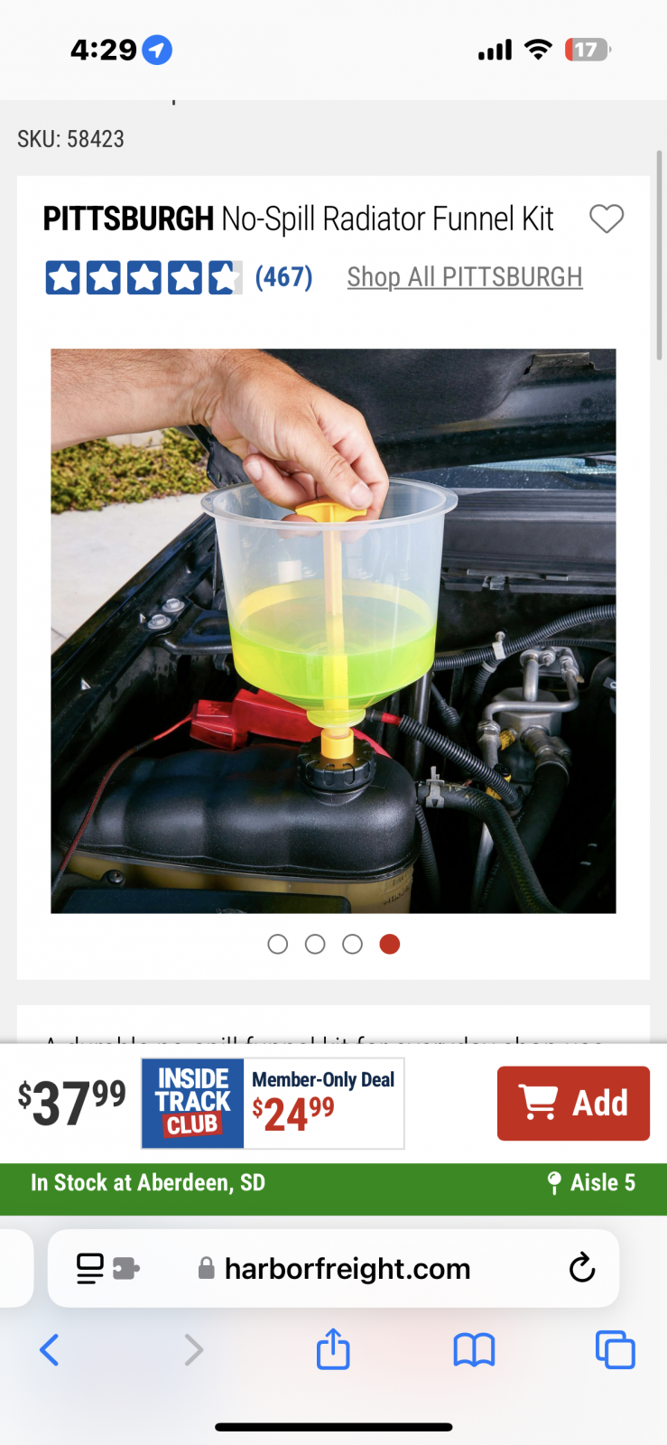

Is this worth grabbing or just normal funnel…

I bought one from Amazon forgot the price and used it when I changed the radiator on my mom's expedition. It worked great. No spills and no mess at all.

I’ve always just used a funnel without any issues. Refill is through the overflow tank which has good access.
