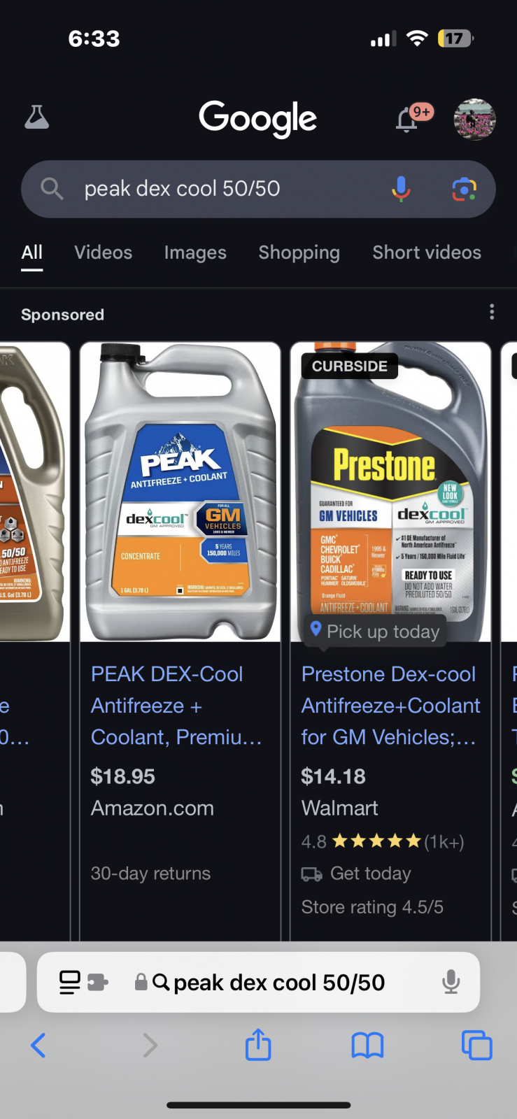

This is the coolant I used. Ready to use. One of these. It took two gallons all together. I imagine bc there’s some in the block and pump?

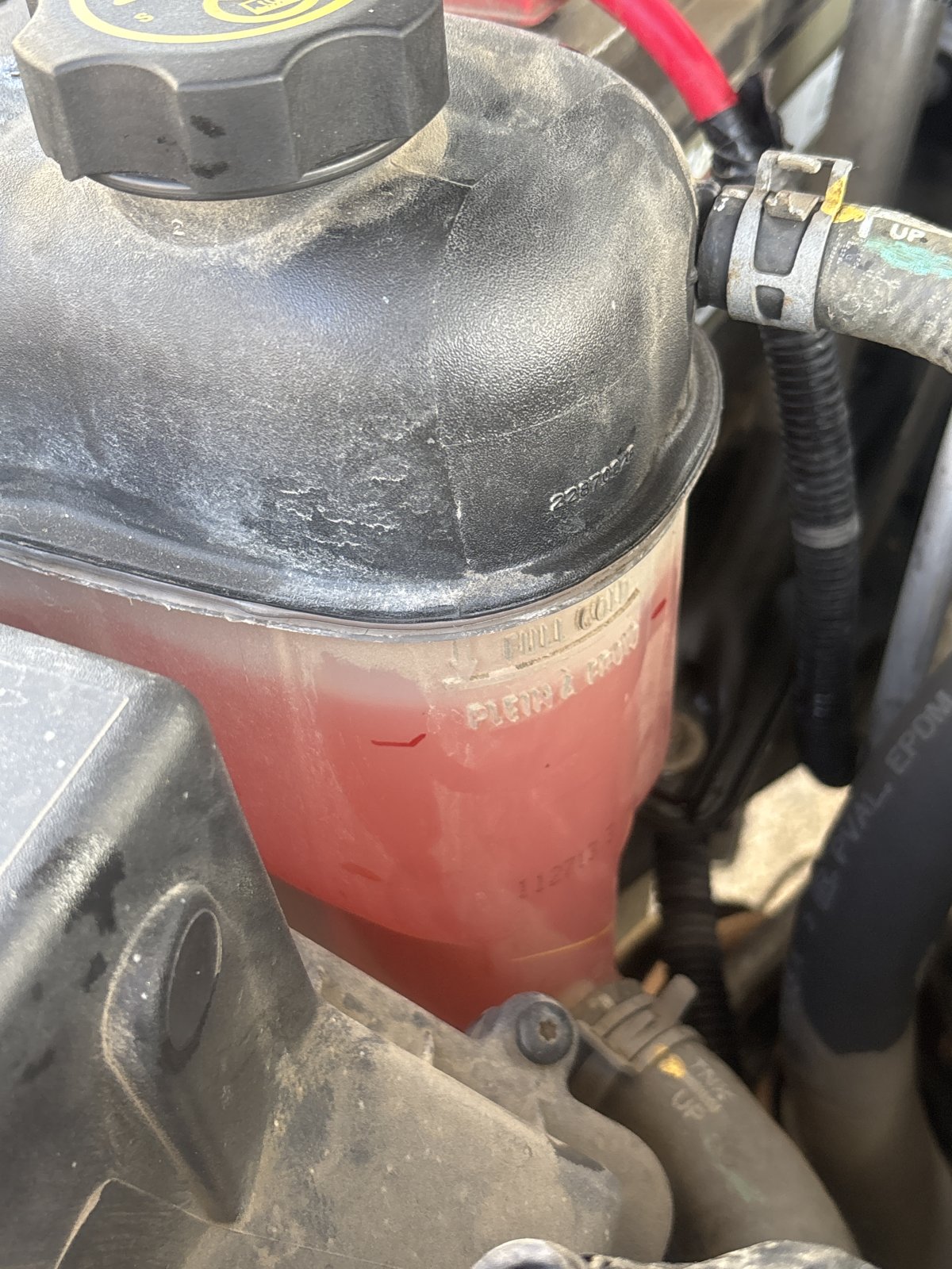

OK, I just got back from my 20 minute drive did not overheat. Here is where the reservoir is at now though I am on a slight slope leaning to the right cause I have to park on the side of the street. Suppose I’ll just keep an eye on it.

The entire cooling system holds 19 quarts, or nearly 5 gallons. IIRC when I did radiators both times it took about 3 gallons. I think you need to add more, it should burp and take another gallon or so. I could be wrong but 2 gallons doesn’t seem right. Maybe others can remember what it took them.
Well, remember, I think they’re still cooling in the block right I never drained the block

Yes, but it depends on if your radiator mfr made the hole the right size. Don't worry about it now; wait until the temp settles.
What should I be looking for once the temp settles?

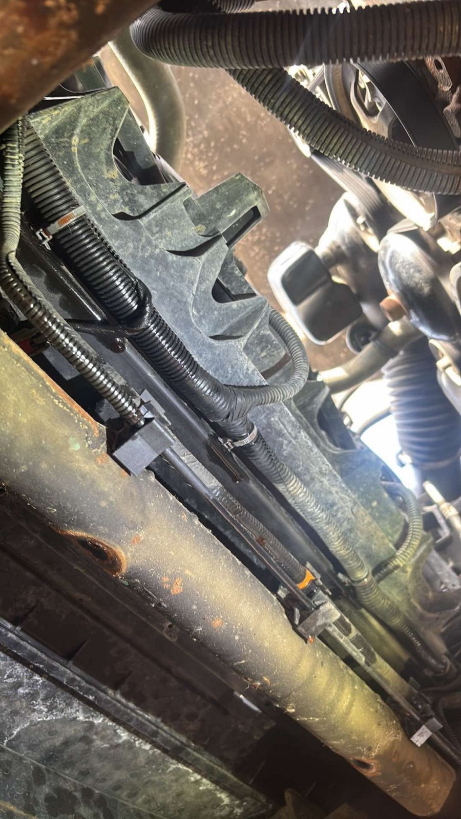

I still gotta wipe down the other excess coolant. Will Citrol work on that? It’s not corrosive is it won’t dry or crack the hose will it

never used it before, I just use water when dealing with coolant. sometimes any excess coolant spills will be pooled up under the front bumper supports, the ones on the left and right side just under where the fog lights would be, they have a crosshatch black plastic about a inch deep top&bottom so the top will hold liquid, so if any coolant ended up in there it can stay there for days and smell, if so just stick a hose up under there and wash it out.

probably left over coolant or possibly transmission fluid from the lines being disconnected, transmission fluid would only be on the passenger side, it does not flow thru the entire radiator. wash it all down and monitor.
Right that’s why I was confused to see it on the driver side as well, bc the lines are all the way on the passenger side … maybe fluid migration

Also the two brackets that the trans line connect to the fans, I wasn’t able to screw them all the way in because the new radiator was a 1/4” thicker.
