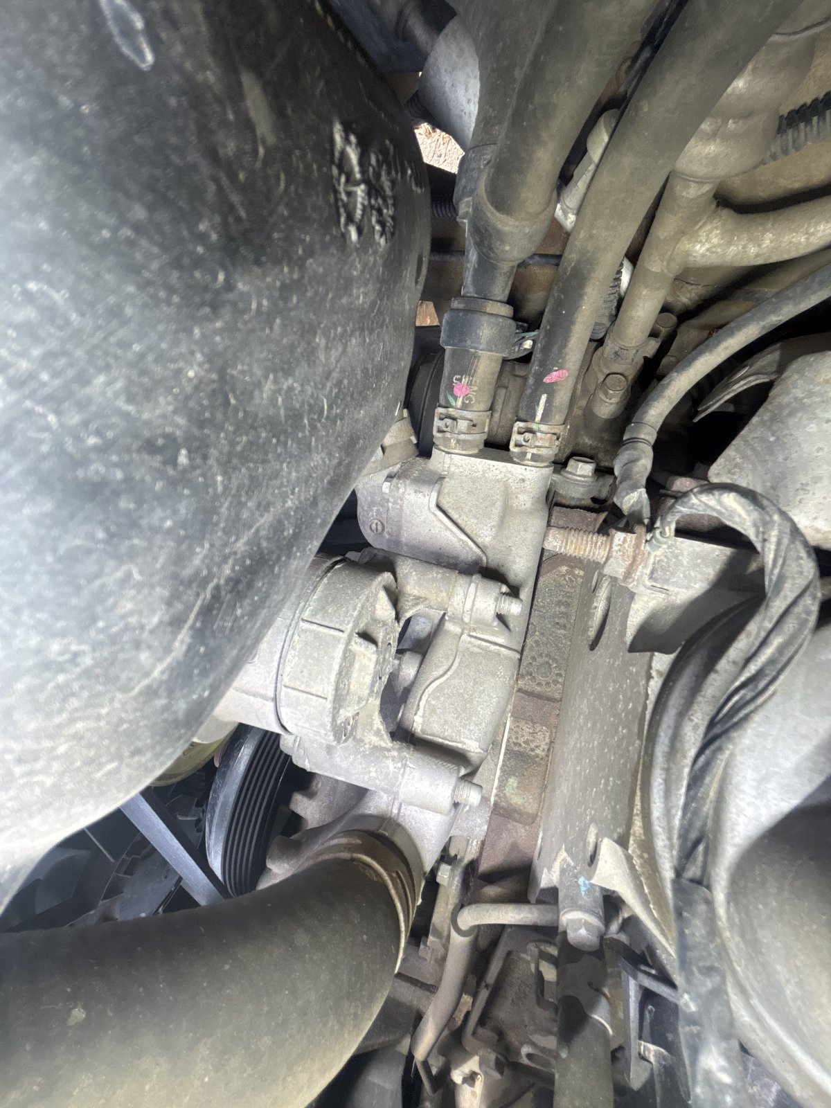

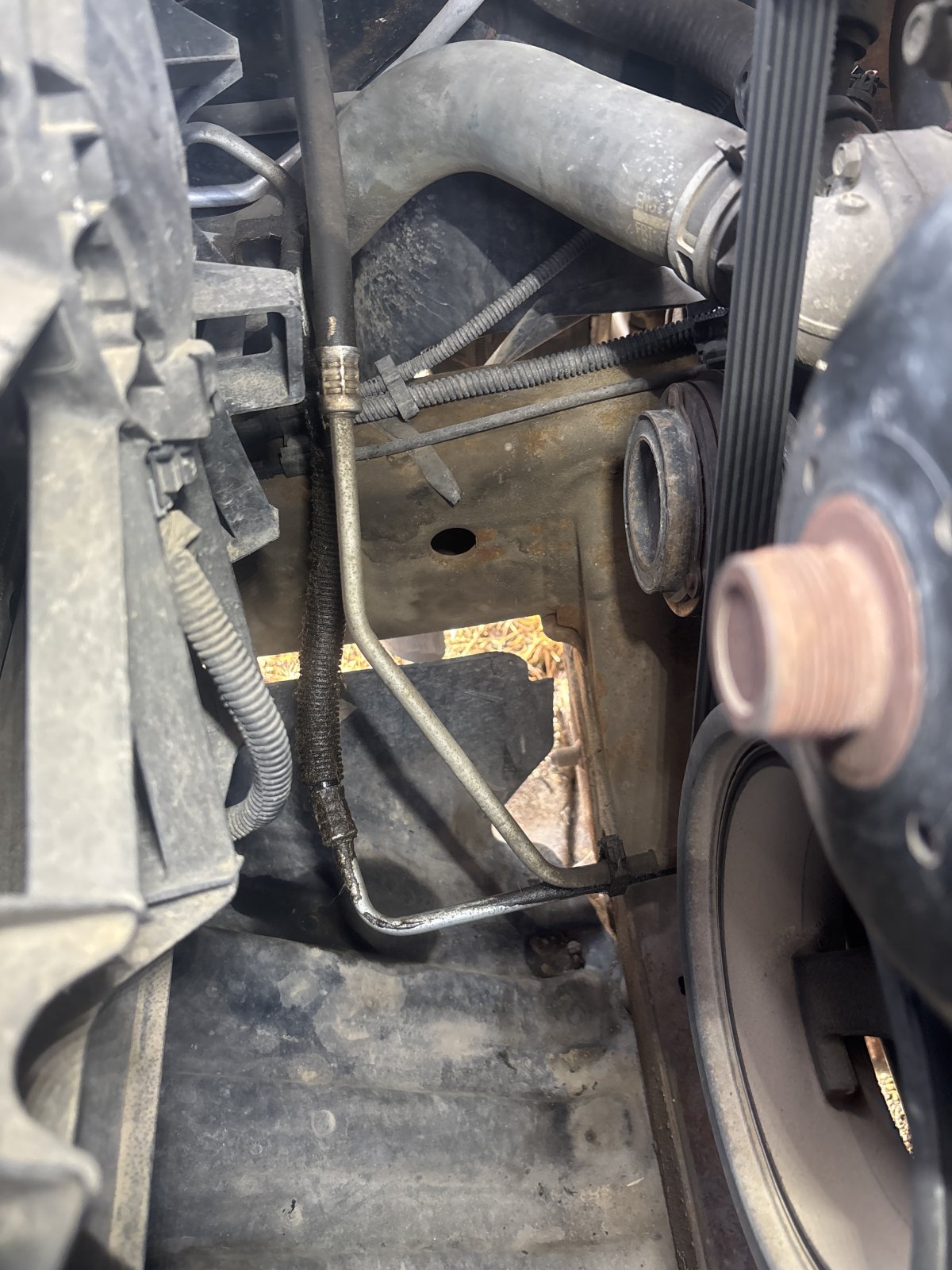

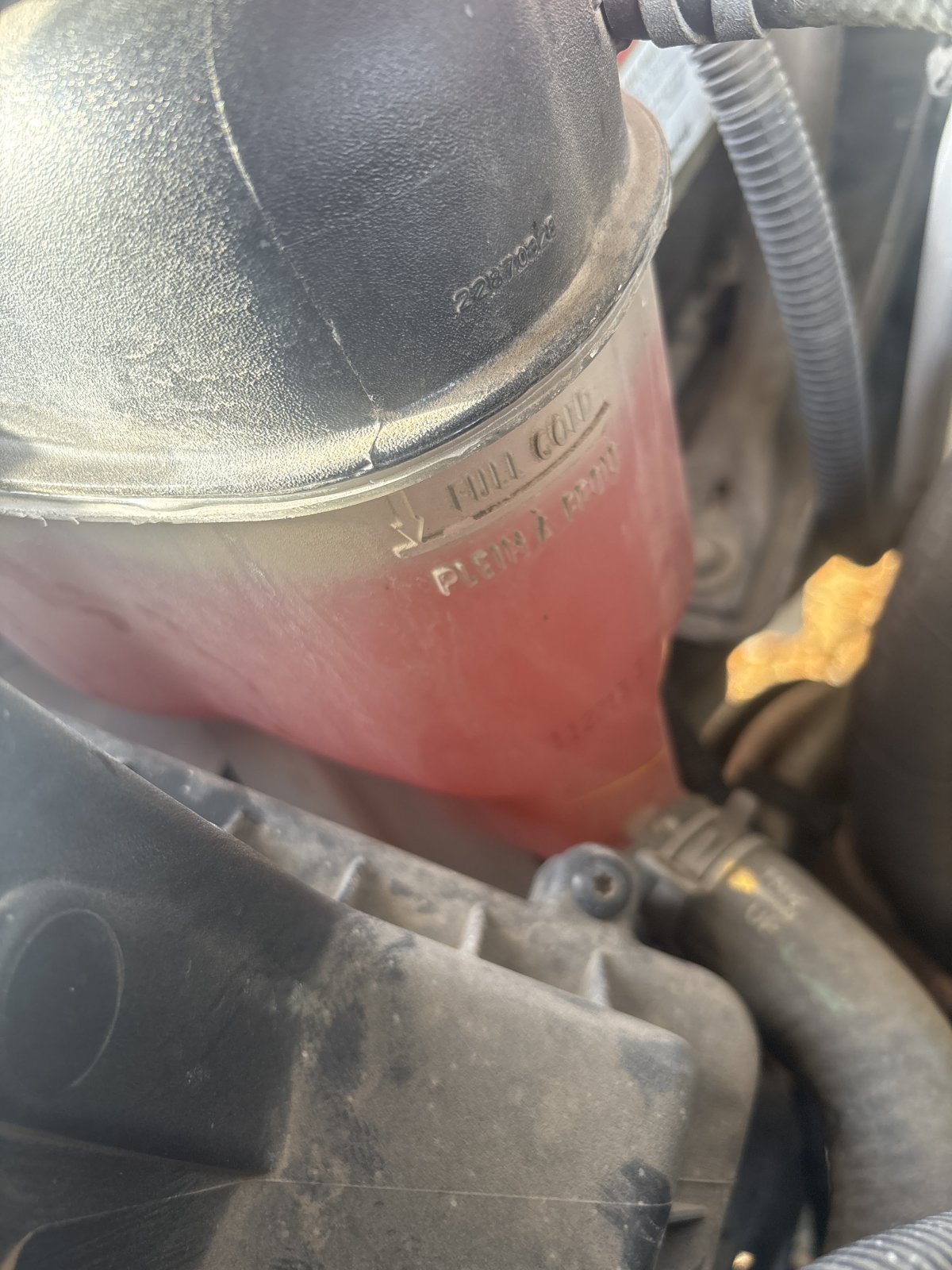

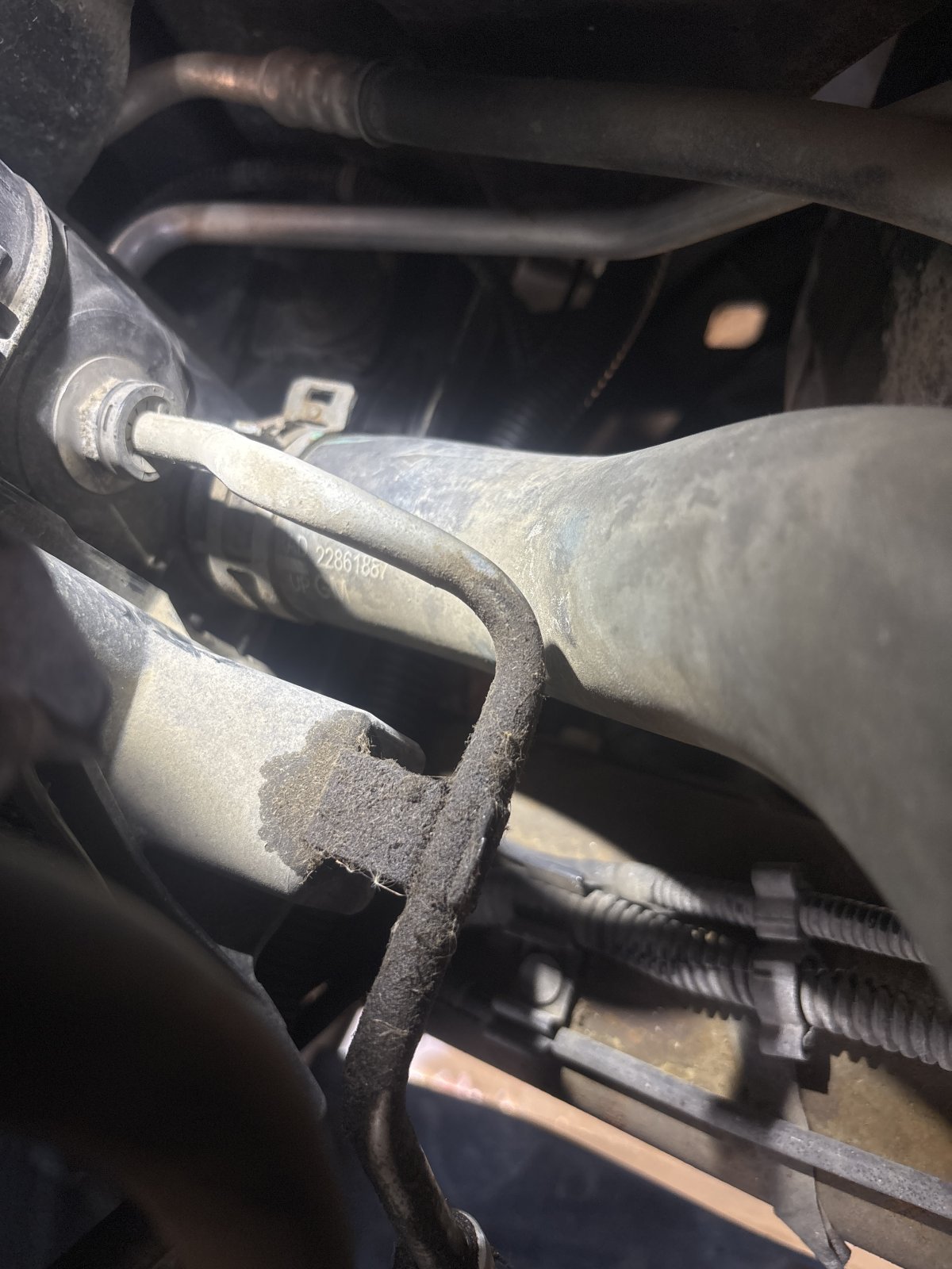

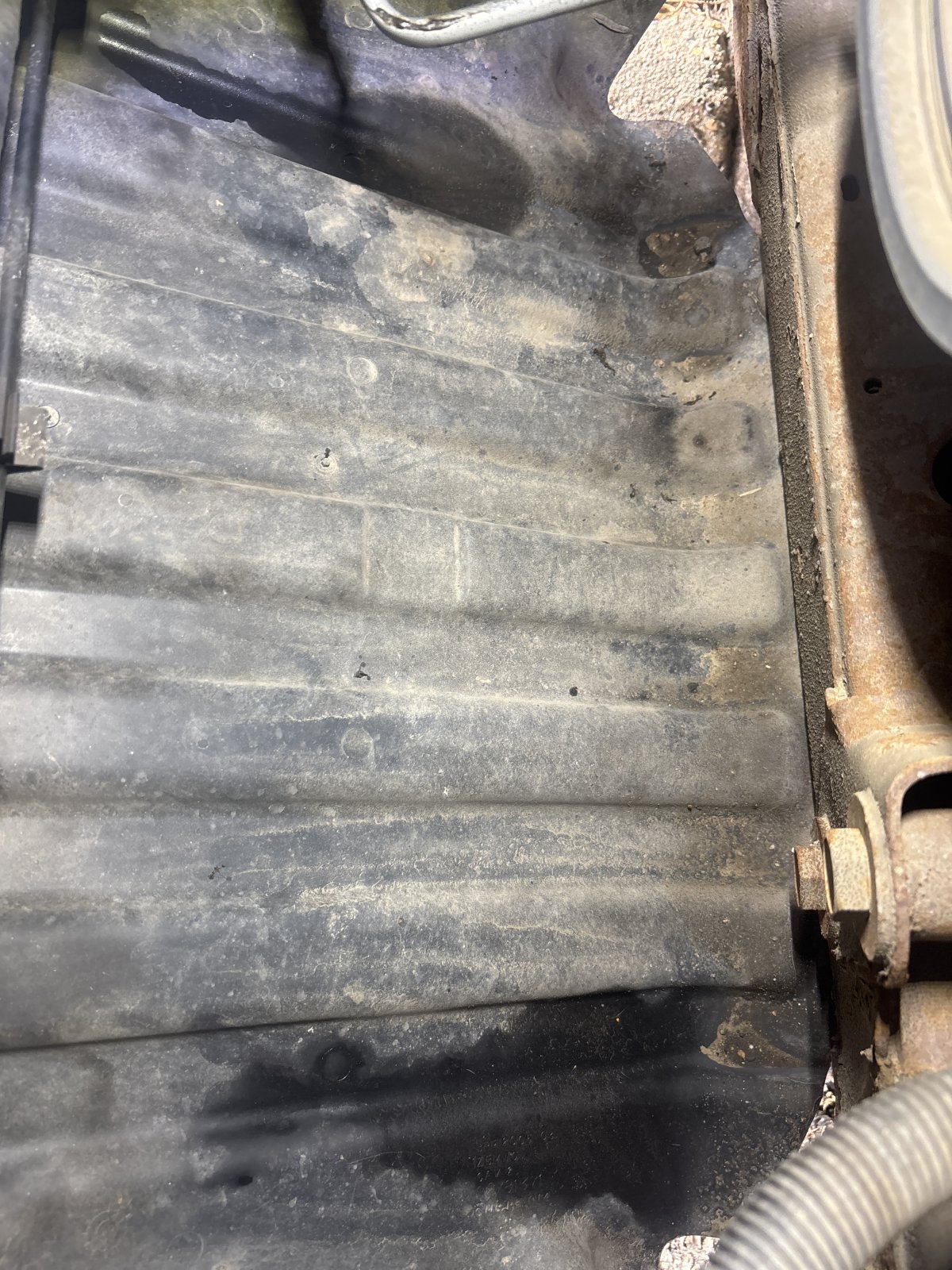

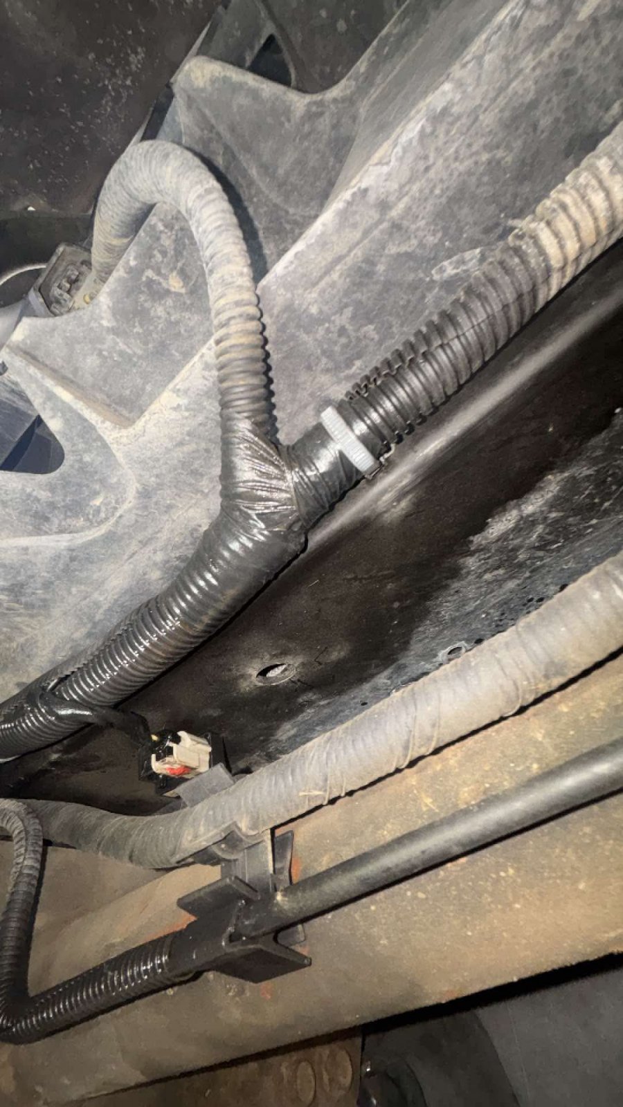

Ya the water pump feels bone dry… I got a few other spots I want yall to look at. I got some dried fluid running down the inside of the, more specifically on both sides of the splash shield… looks new. Tonight i will pop that off and leave the cardboard under there. I also topped it off before I left my house around noon… I was maybe an inch and a half under the fill line when I topped it off. I let it sit for the day, came back. The level was the same. So I took it for a spirited drive around town… after I got back the coolant is still right where it needs to be…
Here’s the photos.

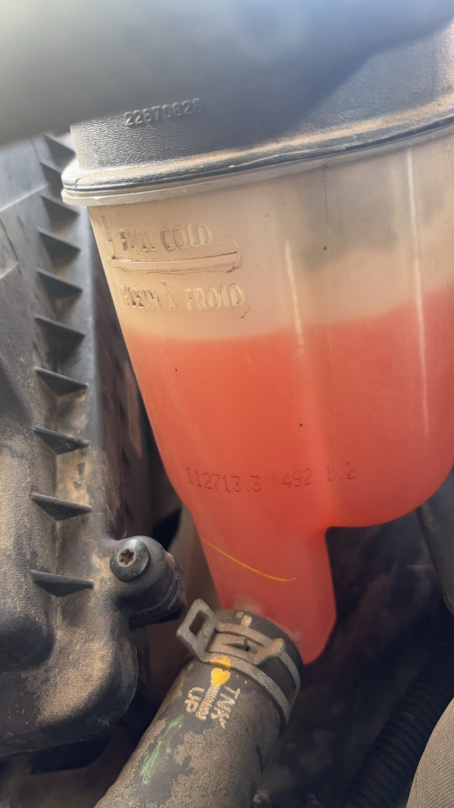

Photo one is the coolant tank before I filled it this morning. I had driven it last night and left it. Didn’t top it off.

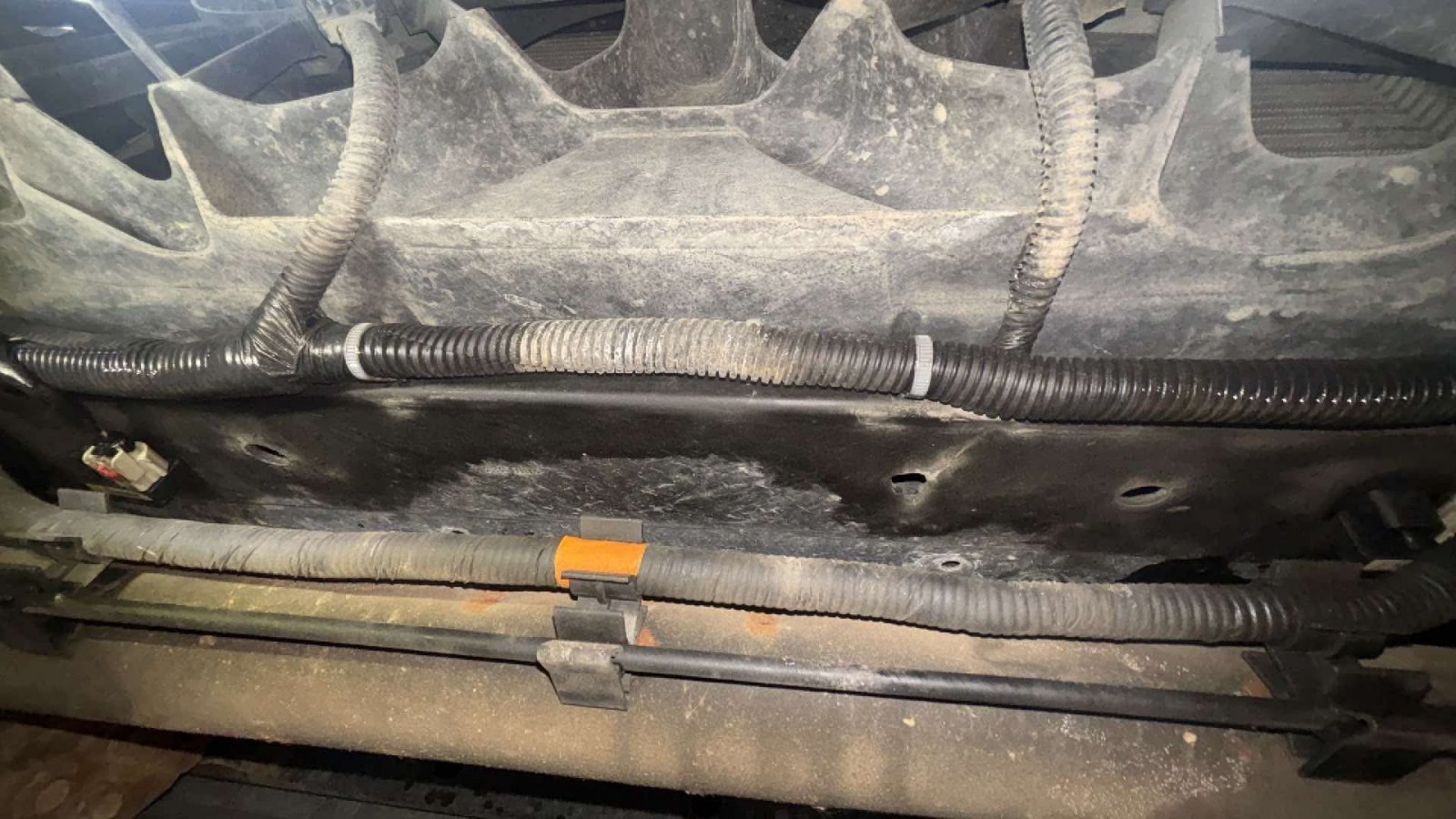

This photo below is the fluid on the splash shield I think
Below is the left side of the water pump

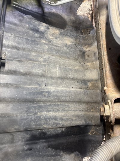

Some more random pics
Yes, I’m aware of the transmission line leaking but it’s a very slow leak and seems to seal itself and doesn’t really correlate with the puddles below
Passenger side hose^ with trans line shown

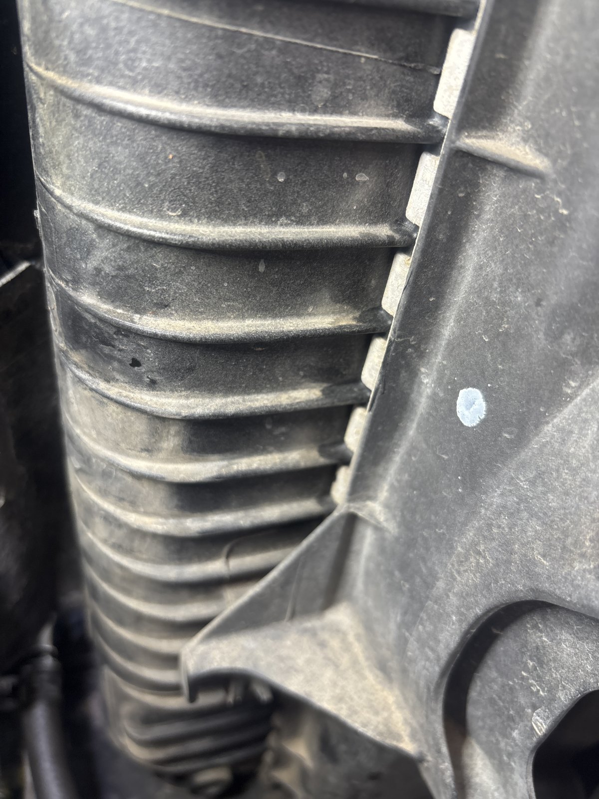

Here’s the tank currently after a nice drive. Don’t lose much. If any…? I topped off on cold engine before leaving.
Still seeping at this spot. Side tank ^

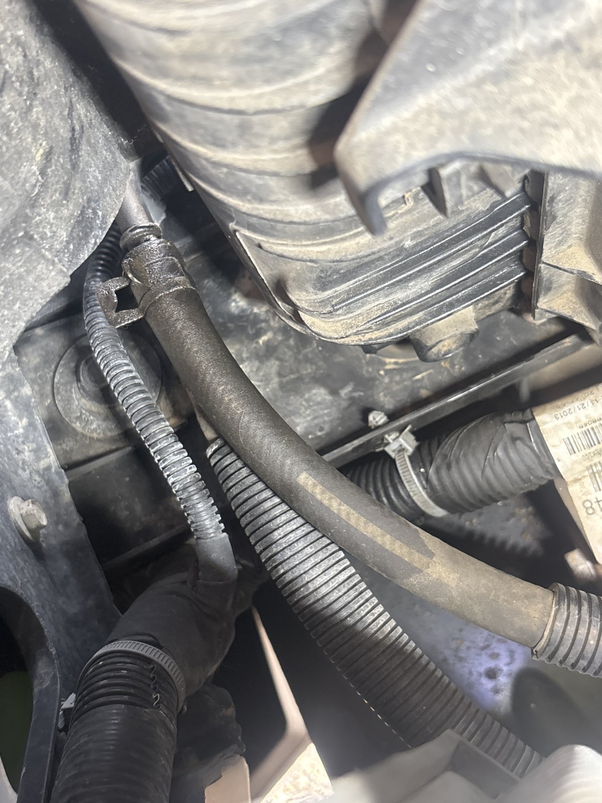

I’m not sure what this guy is driver side hose below the bigger hose looks like it might have a small leak as well
Matter of fact, in reference to the last photo on this comment, it looks like there was a TSB posted here for a power steering leak. This might be a little off-topic. https://static.nhtsa.gov/odi/tsbs/2013/SB-10043850-7806.pdf

It was coming from the radiator. But where is the drain petcock ?

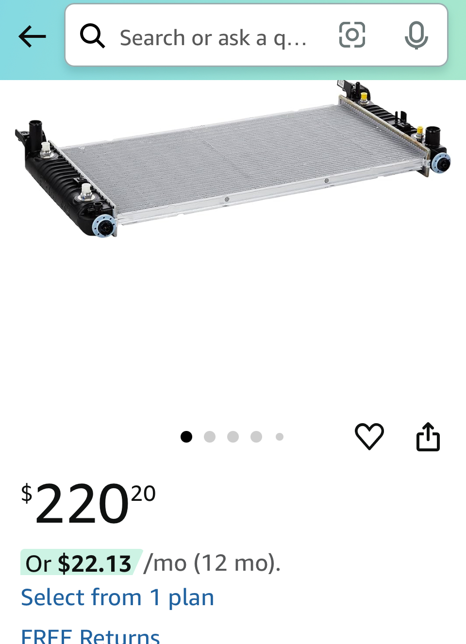

i got a new unit coming in the mail, when I take this one I kinda wanna like smoke test it or something.

Ours aren’t repairable. They always leak where the plastic end tanks are attached (glued?) to the aluminum core. It’s super unlikely one leaks in the core where it could even possibly be welded. Better to just buy a new one.
