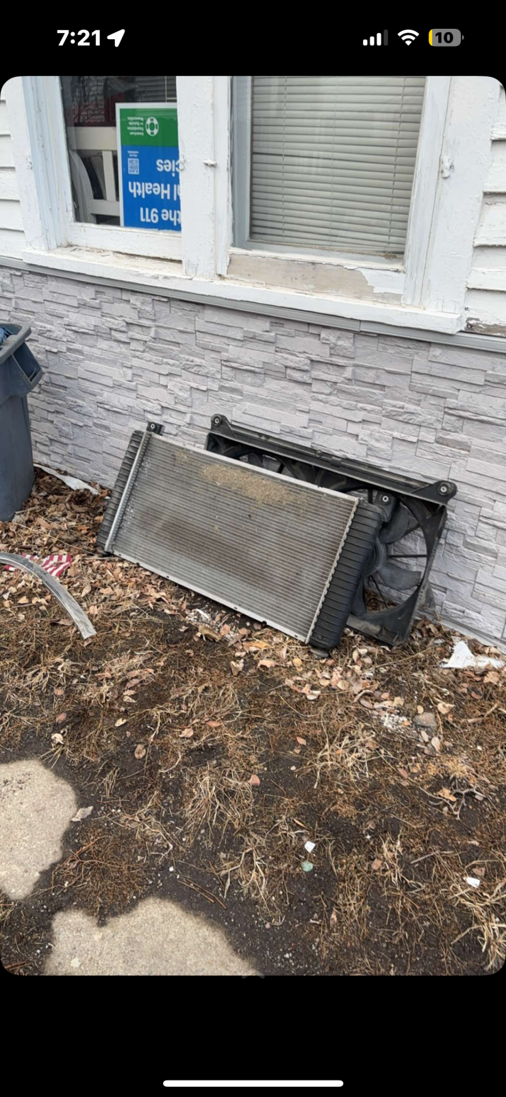

Here’s old radiator. I could be wrong, but it looks like a big crack across the middle and it’s seeping?
