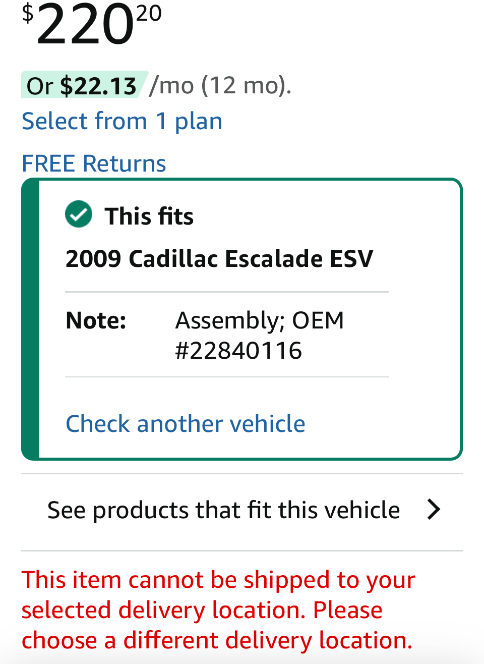

Ordered my GM radiator before the pressure test. Amazon had a torn box special for $187.11 for the 6.2L. Immediately after ordering it a notice popped up they could no longer deliver them to SoCal!?! A Quick Look online shows radiators just jumped 1-$2h this month. WTF?
It pays to shop around. If you’re in need of one fast, shipping time can make or break your budget and force you to buy an overseas special.

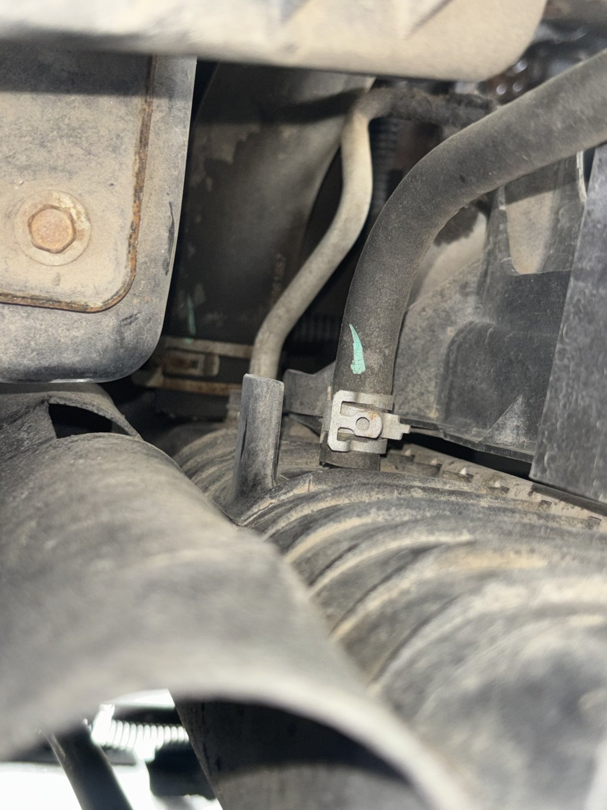

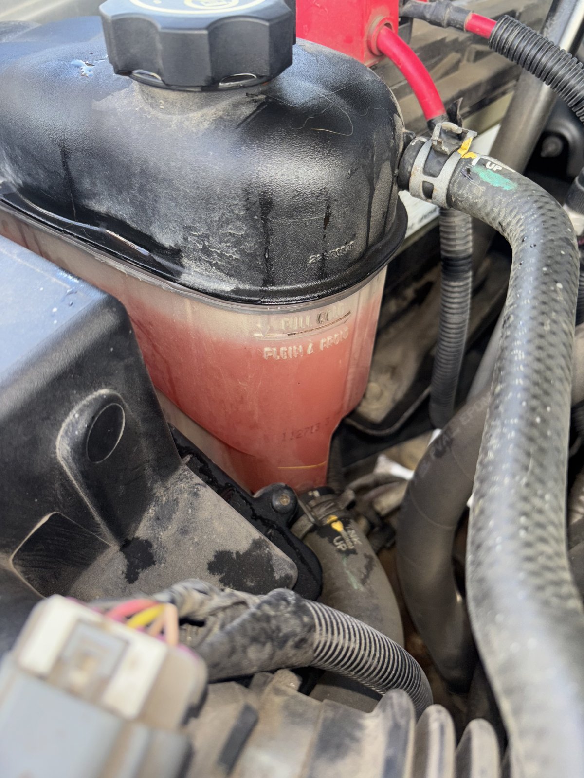

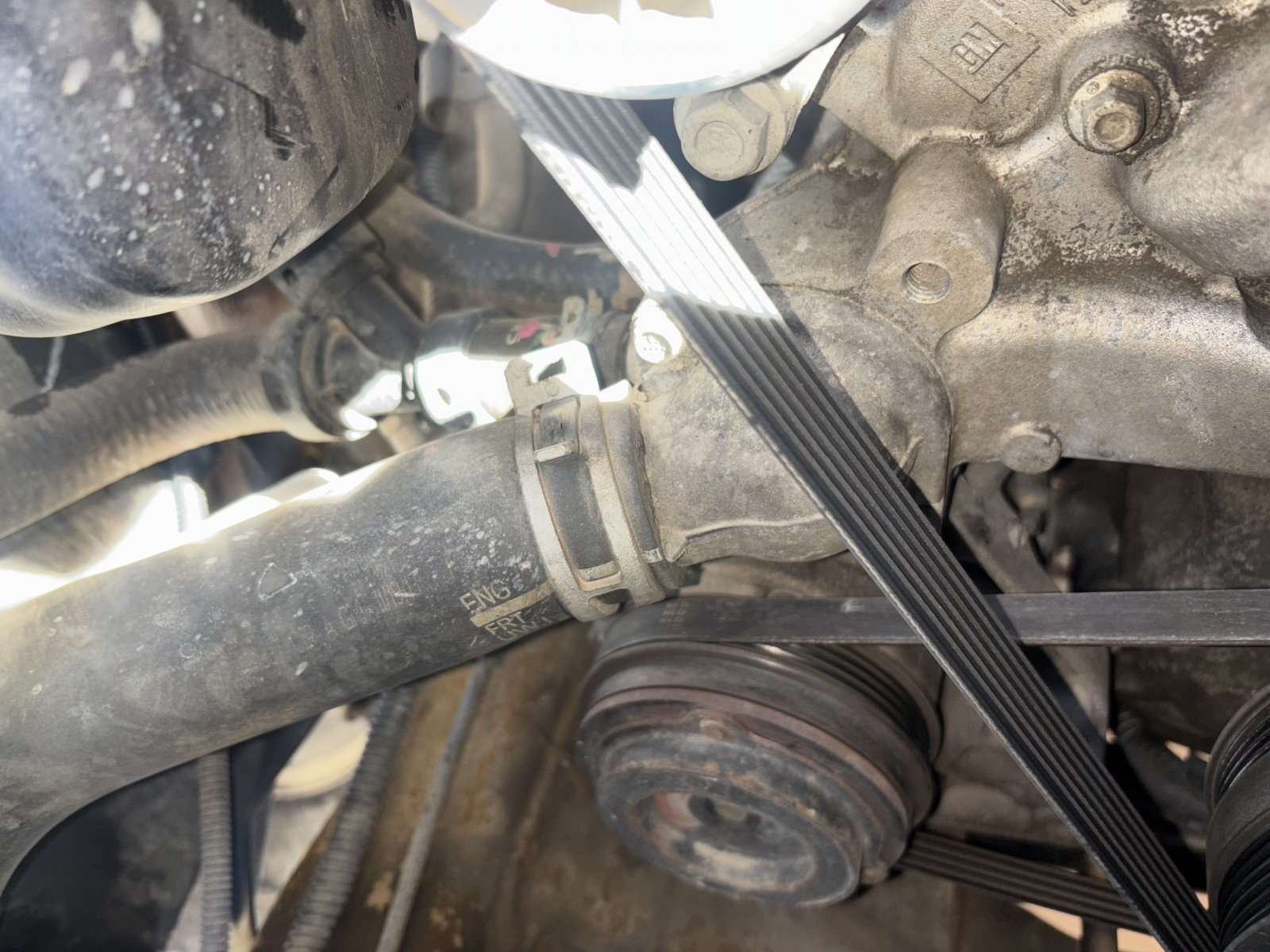

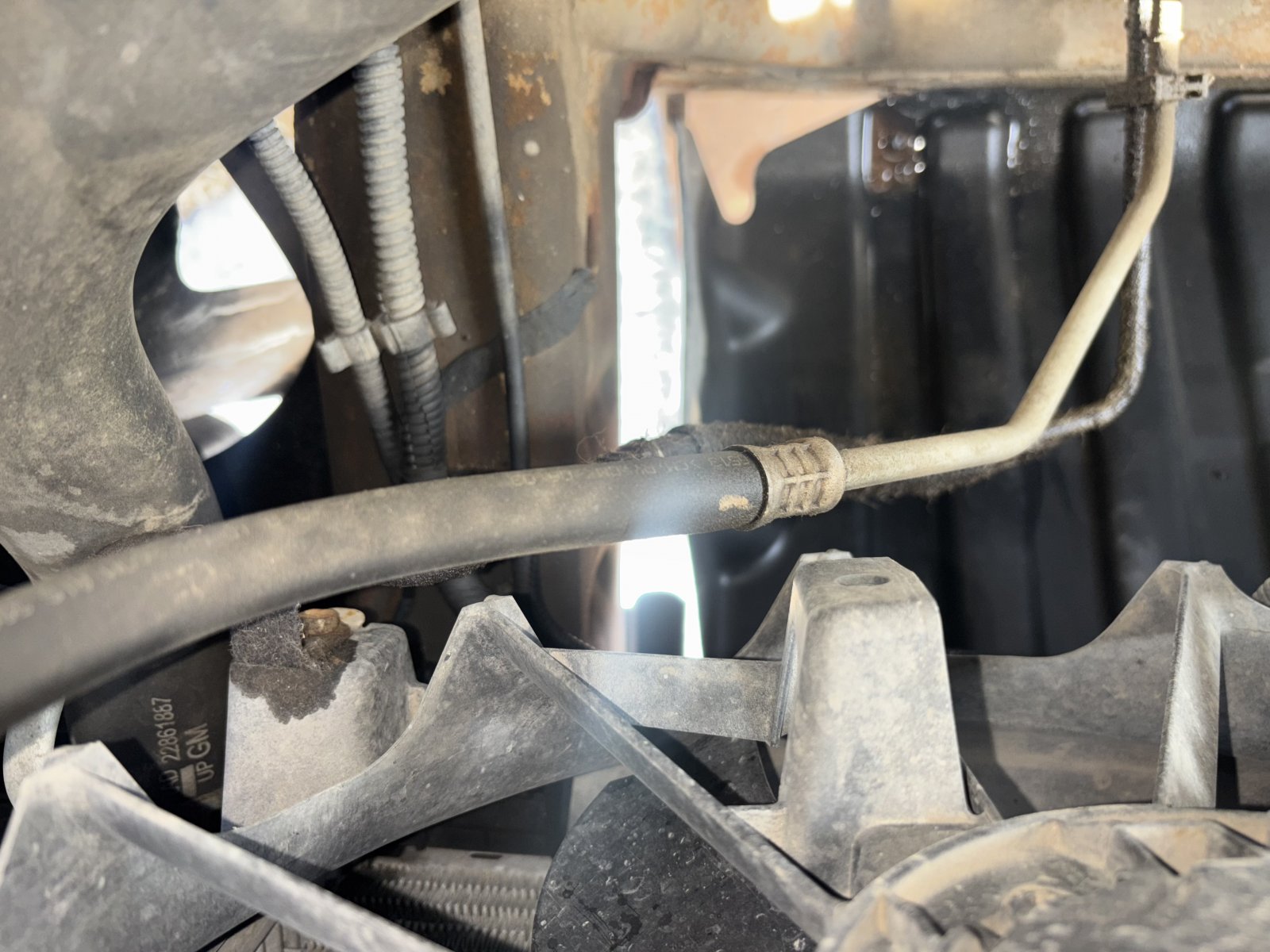

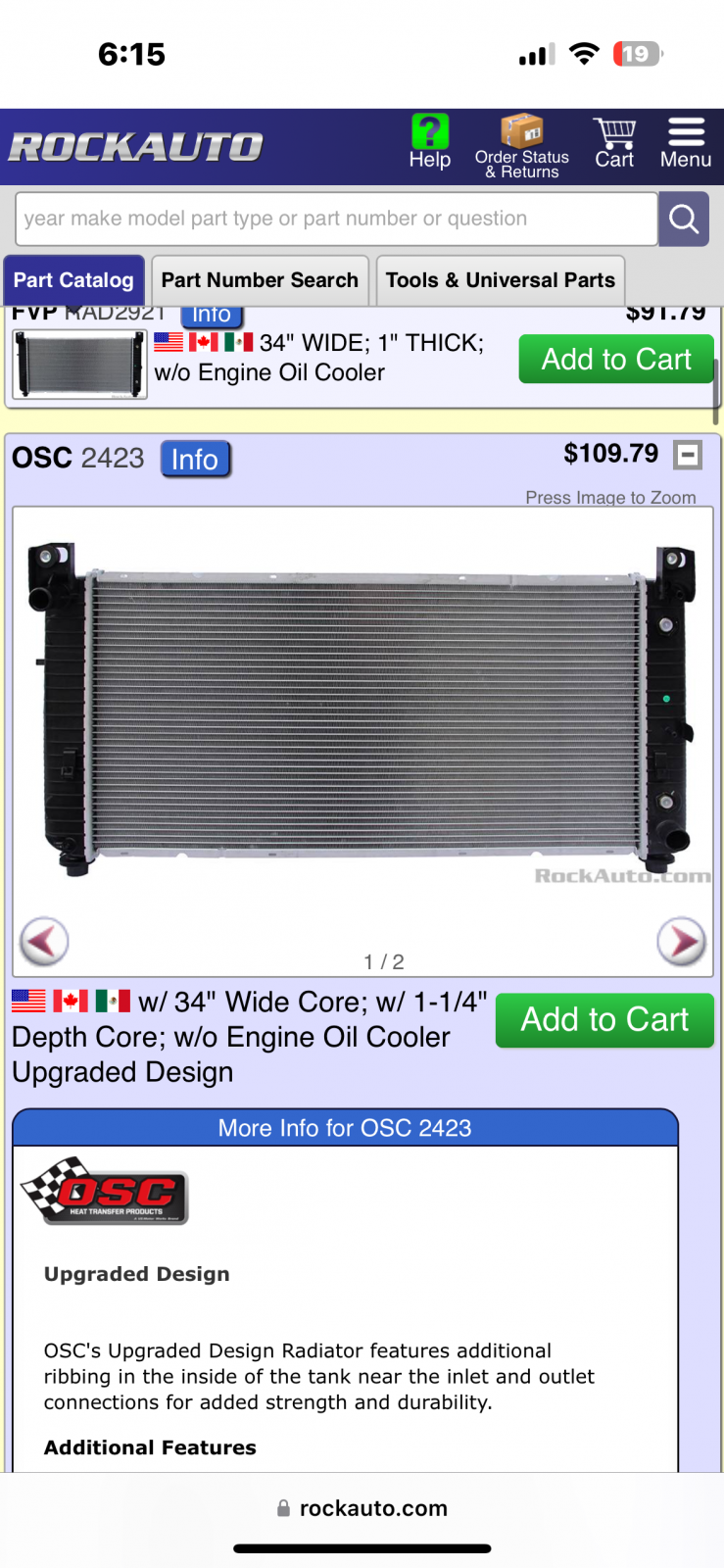

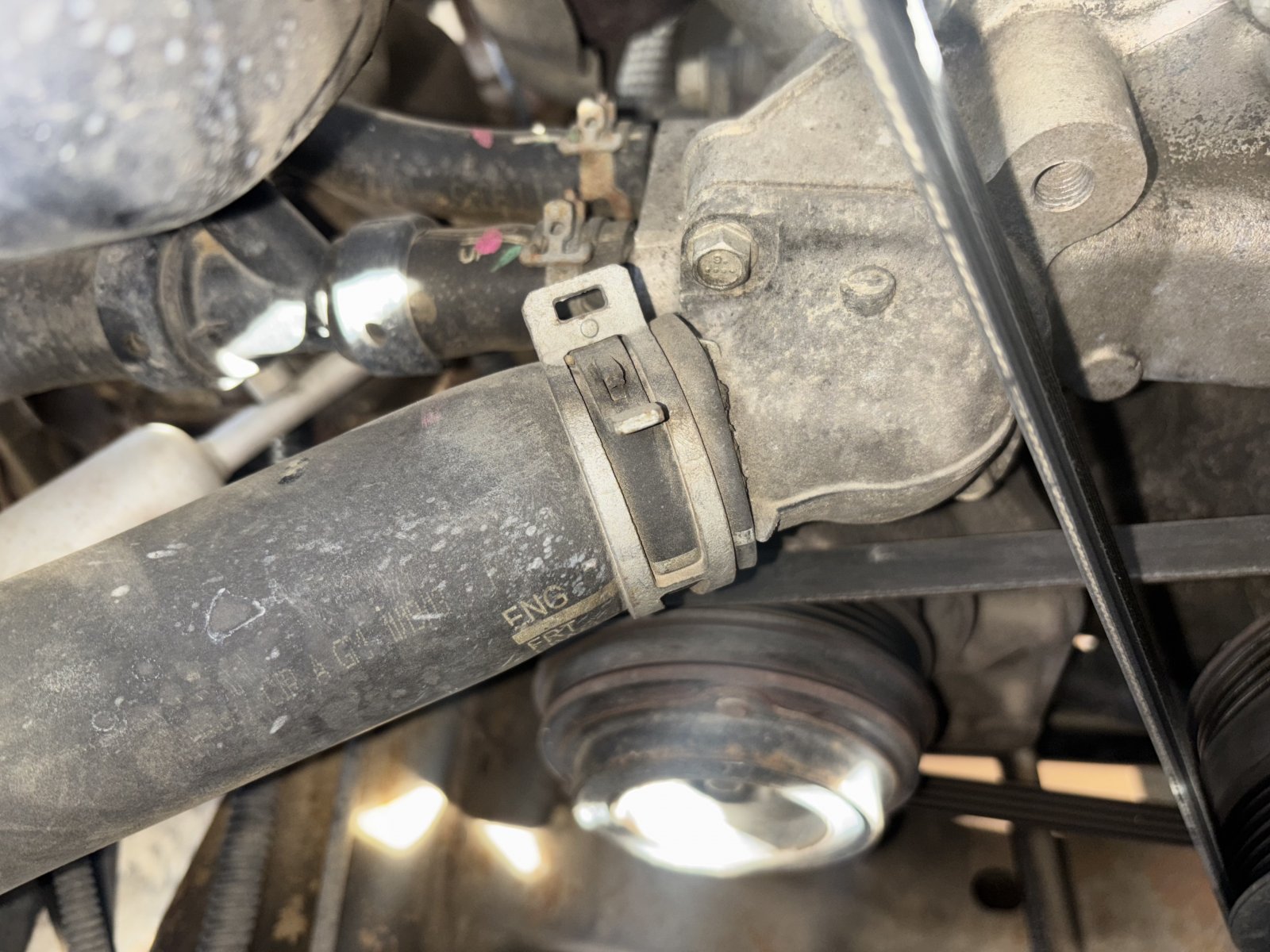

Alright y’all here’s some pics. Can’t tell exactly where the leaks coming from I added coolant up to the fill line last night after letting it cool down and it looks like it went down a little bit(coolant level). If I squeeze the hoses, the fluid in the reservoir goes up and down, and I don’t see it gushing out anywhere when I squeeze the hoses either so I think that’s a good sign? I’m also curious if I have an oil and trans cooler it looks like I have a trans cooler running directly to the radiator itself. I don’t think I have an oil cooler I could be wrong. I didn’t see any lines running from the engine.

I'm not familiar with that brand of radiator but be careful what you buy. Some of the aftermarket rads don't have the correct port reduction in the port that connects to the small hose that goes to the surge tank. Measure your old one (with a drill bit?) and compare when you get your new rad. They should be very close in size. If the hole in the new one is larger than the OE one the engine may not warm up correctly. It's been documented in several threads on here.

The leak will likely be on the coolant reservoir or plastic portions of the radiator. When they leak it’s typically through a crack.
As the pressure in the system rises and temp heats up the pressurized coolant escapes and vaporizes leaving behind a whitish residue.
Run the truck with a/c on full, lights on and allow it to get hot, but not overheat. You’ll likely find your leak as the temp is creeping up.

these trucks don't overheat from a small leak, the coolant has to be fairly low like none in the reservoir
if you are trying to find the leak then you need to pull the cover off the top of the radiator support and get a flashlight and start looking around over, under, to the side, etc, etc.
might have to pull the lower splash guard off as well in order to see up in there.
if you suspect the radiator then check the sides really closely, the black plastic end caps are prone to getting a small fracture if there is nothing there then you need to check the metal fins and look for a redish-orange color tint spot, the front can be hard to see so you may have to unbolt the top supports and tilt it back.

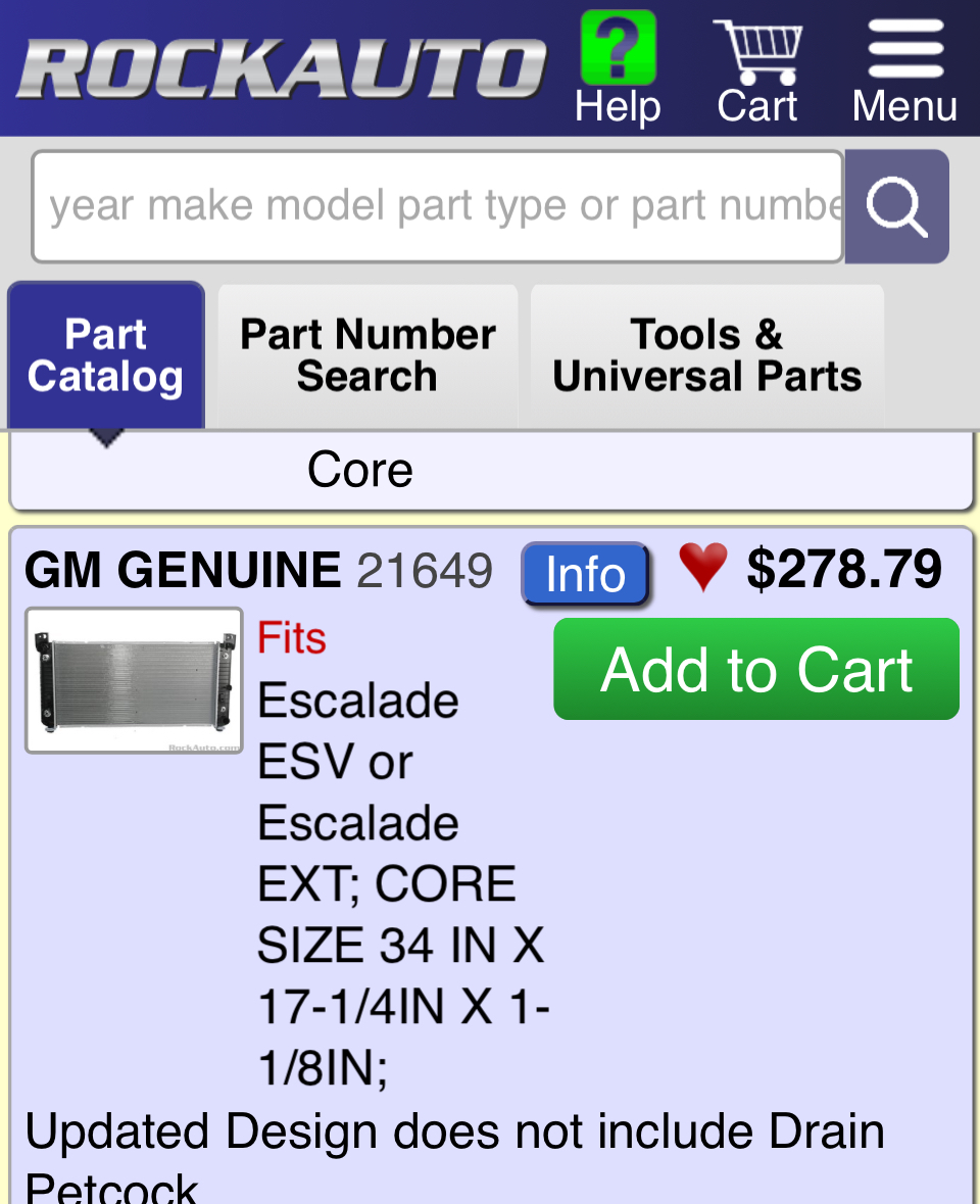

My Tahoe has the enhanced cooling package. I could only find it at the dealership for $700. I could have cut that cost almost in half if I ordered on line. Your radiator will cost far less if you do not have the enhanced cooling package. I do know that PPV and SSV models have the cooling package and not the LT, ect.
