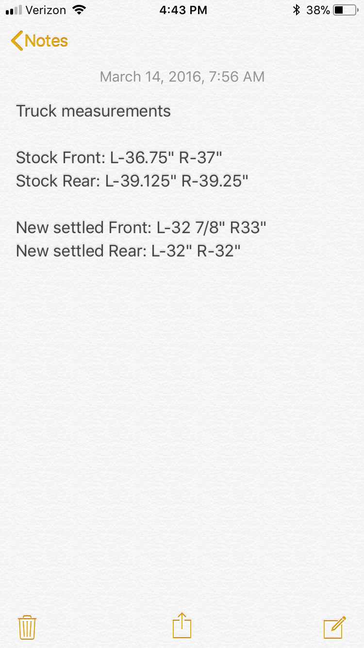

Here are my measurements before the new tires and air shocks. Also both stock and lowered measurements were taken on 295/35/24s
45,014
Strange that the left was higher than the right. Usually it's the other way.
Nice left-to-right numbers after the drop, though. Does that inch lower in the rear show? I know some fender/body shapes can make it look even.
You could definitely see the difference. It’s not there anymore with the air shocks tho
