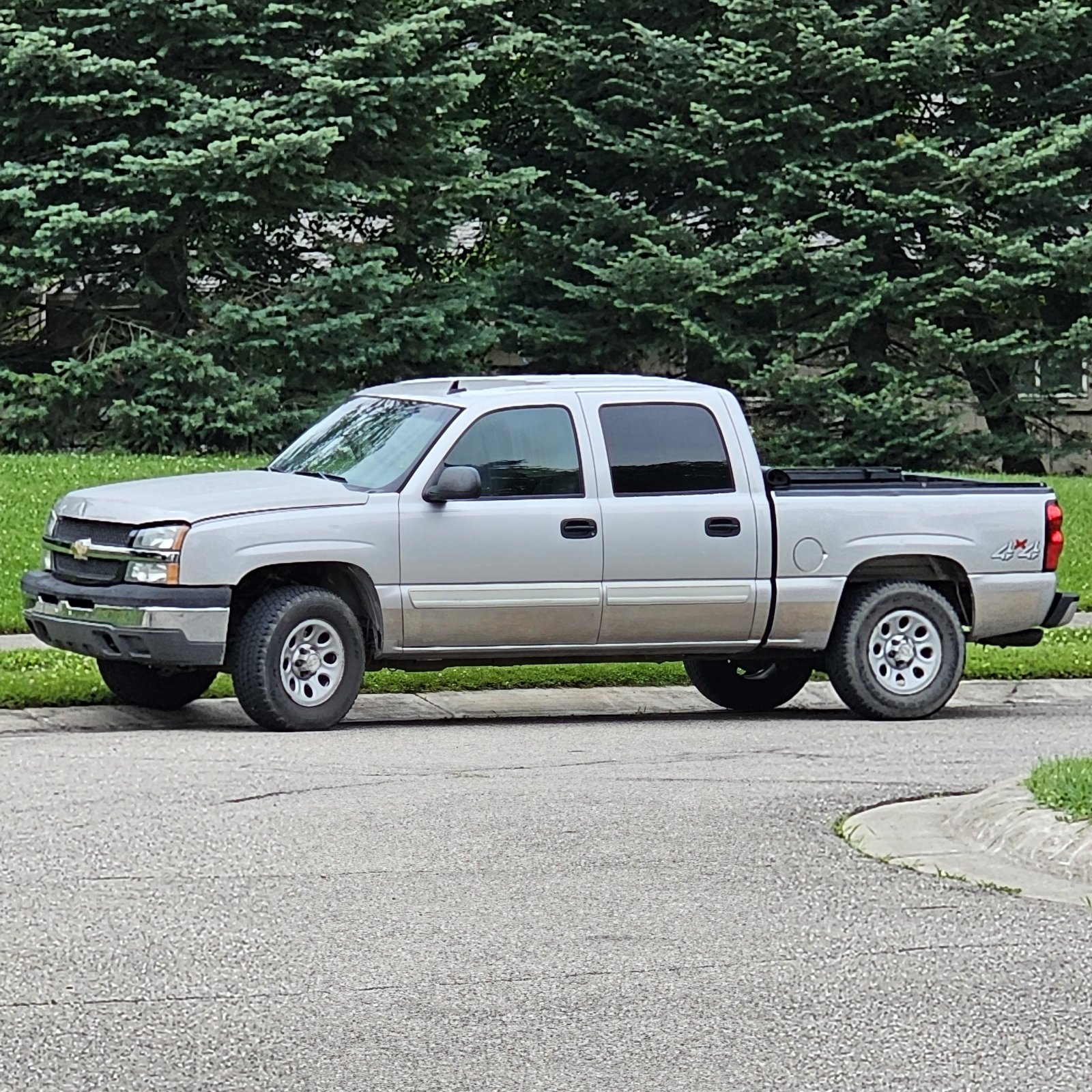

I guess I'll make one of these for this truck too, since it's become more of my focal point than my Yukon right now. A couple months ago I picked up an 06 Silverado crew cab with a 5.3 4WD. Got it for $5200, big thing being no rust (I'm in Michigan, this is a big deal lol). It had just under 274k miles on it when I got it. Right away I knew it would need some work, which is part of the reason I bought it, I can't stay away from projects.
First thing I did when I got it home was gut the interior. Previous owner(s) smoked in it. It also came from a dusty area in Texas, so a lot of that reddish dust was all over everything. Over time, things got wet, turned to mud, etc etc. I pulled the carpet, padding, headliner, everything but the dash out of it. I cleaned up everything pretty well. There were some spots in that carpet that just weren't coming out, but it doesn't smell anymore.

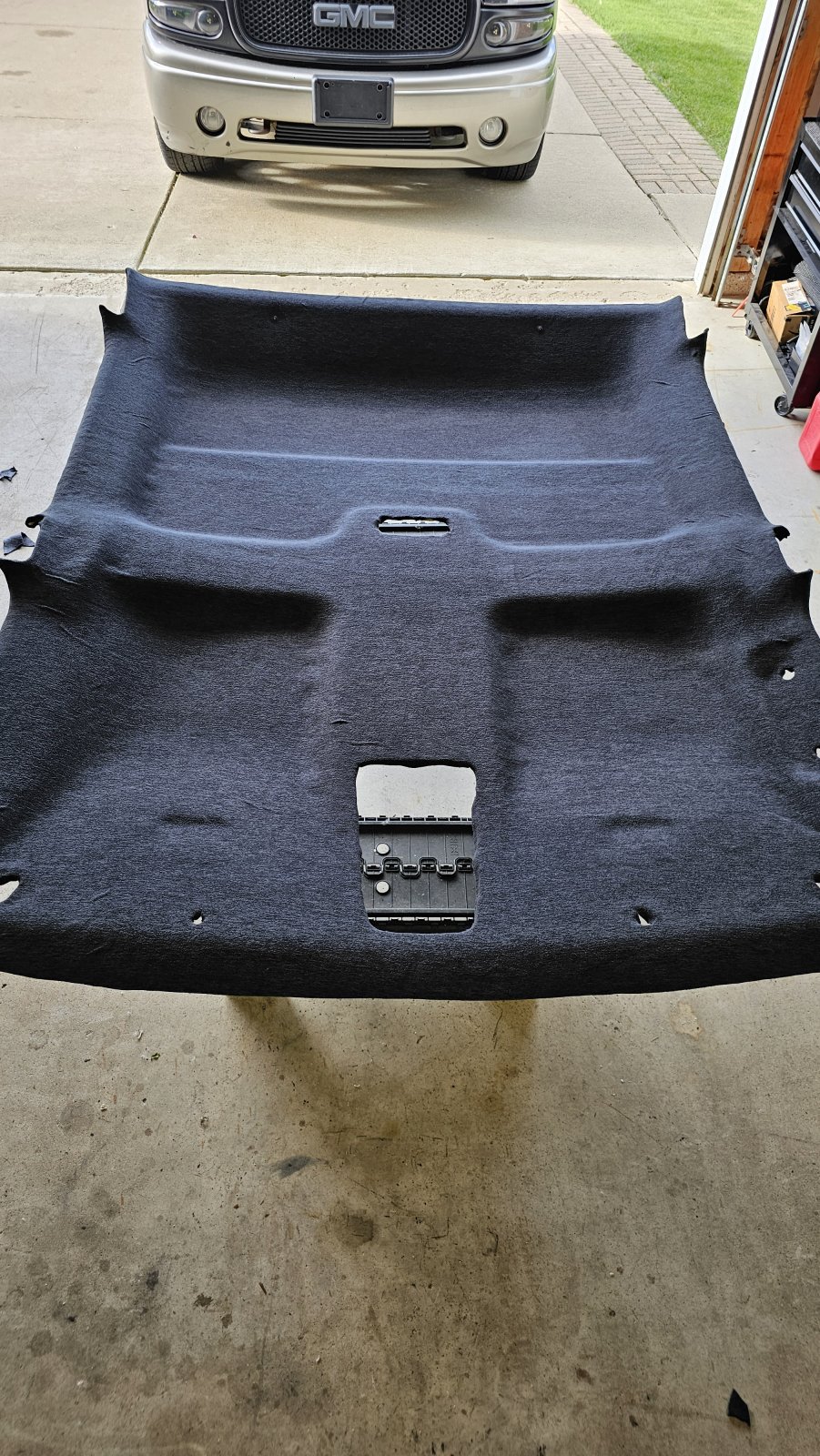

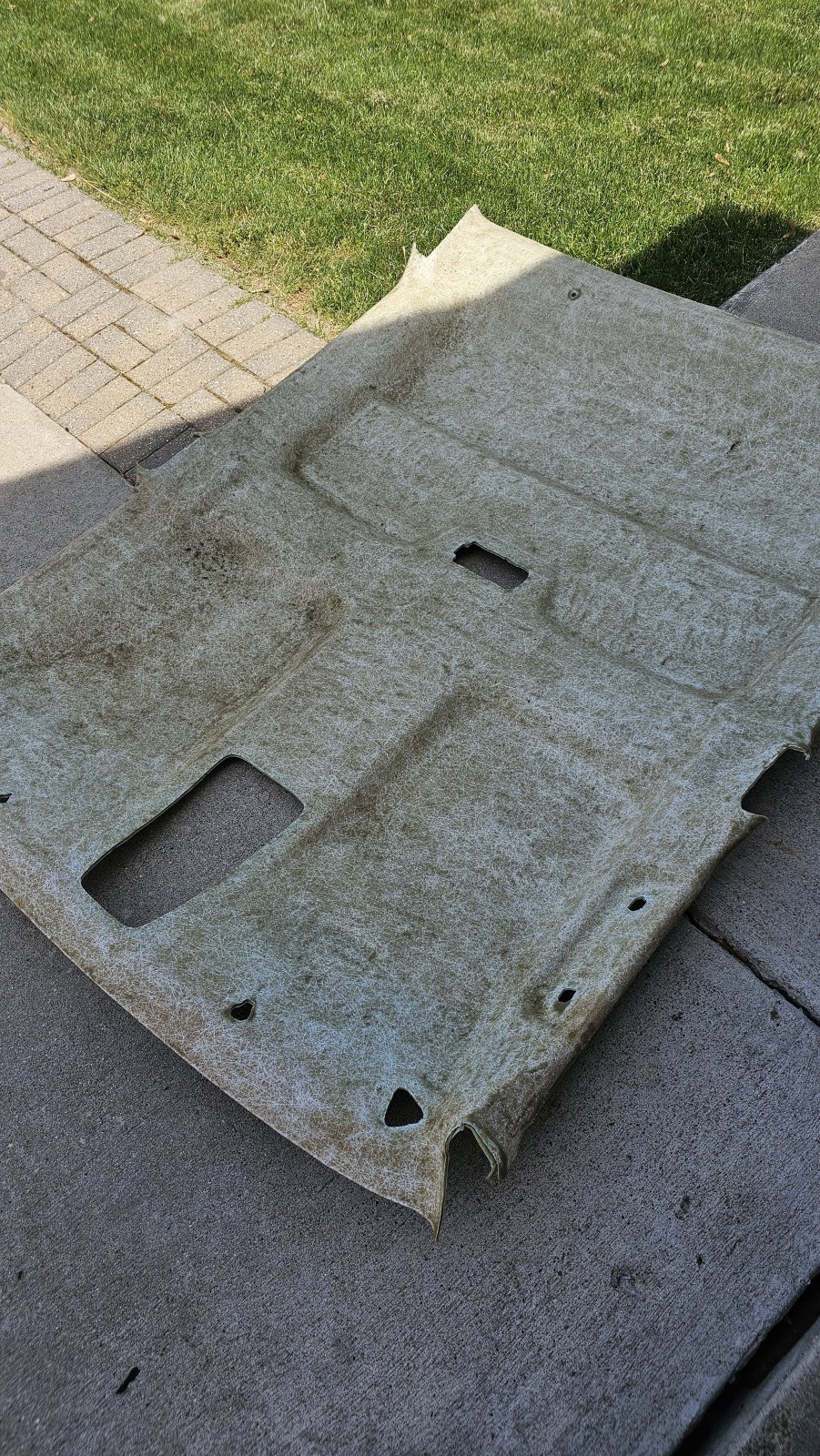

I also pulled the headliner since it was sagging in a bunch of spots and had some good burn marks in it. The local fabric stores were all out of headliner material. They said this time of year, its hard to keep in stock since everyone has projects going on. So, since it's a cheap truck, cheap material. Yes, that's fleece lol. Overall, it didn't turn out too bad, a few spots with some small wrinkles, but way better than it was.
I'll update more on the LQ9 swap and trans I just finished up over the weekend once I get the pics. I'll also go over what my other plans for this truck are.

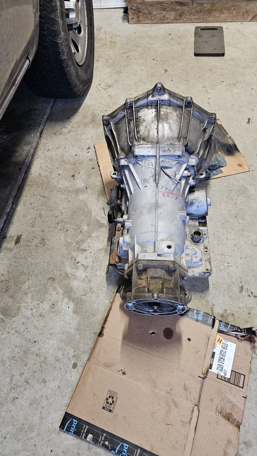

When I bought the truck, I noticed there was some smoke on first start up, looked white so I figured head gasket, not a big deal. Turns out, even though it looked white, it wasn't coolant. The valve guides had left the chat. I was going through oil like crazy. First start up of the day, I could fog my whole yard. With 274k miles, leaking from most gaskets and the guides, plus unknowns internally, I decided to get a 6.0 instead. I found one with 145k miles on it, from a good running Escalade. Previous owner took great care of it, but got T-***** so it was totaled. I was going to tear it down, but I could tell the heads had recently been off it, cleaned up, etc so I just did the oil pan, valley cover.

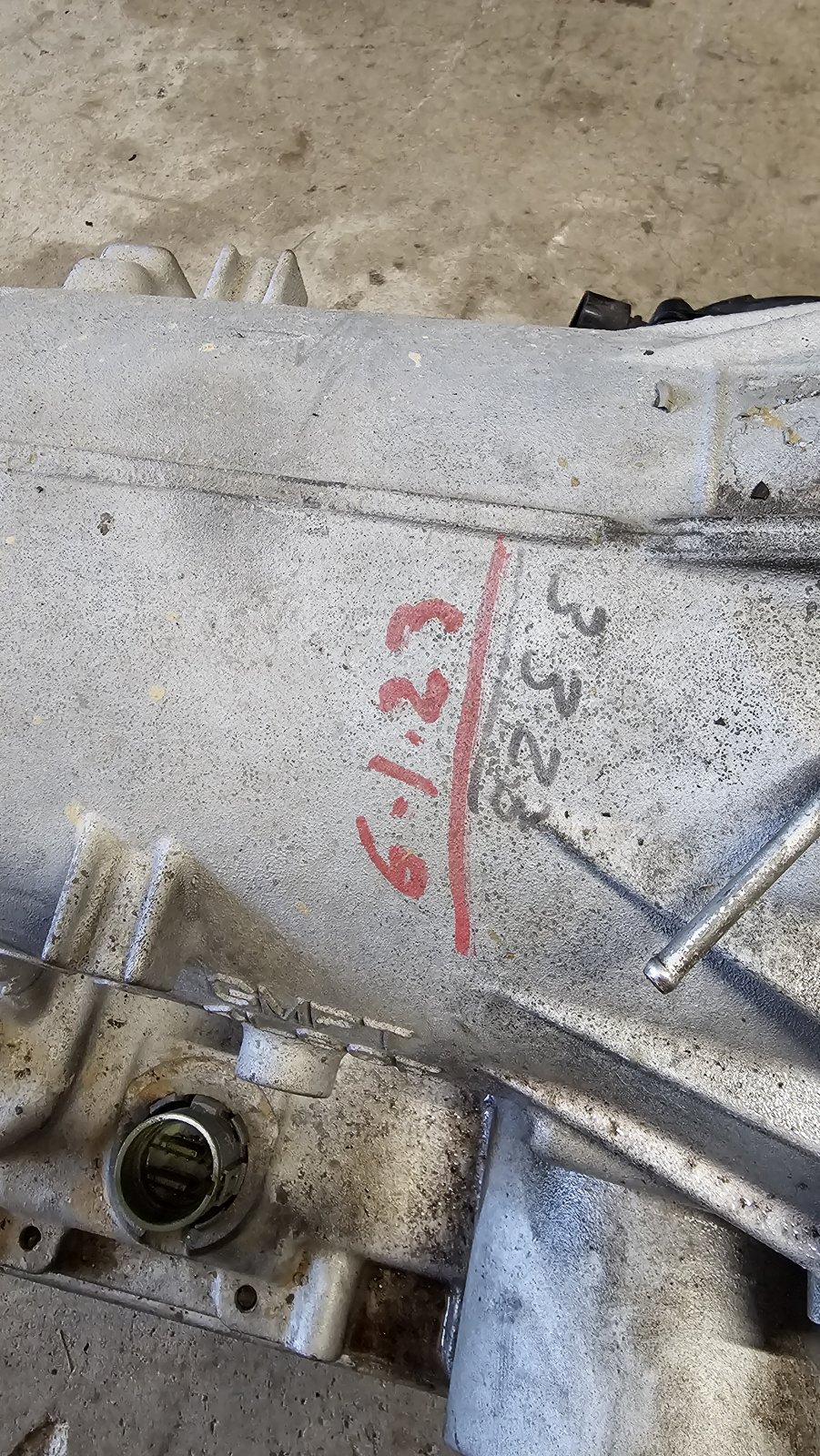

I also noticed there were some odd little shifting issues, mainly in 2nd gear around 2000RPMs, I would get a stutter. The seller told me the trans was rebuilt a year ago, but since half the work was going to be done by pulling the engine, I decided to pull the trans too. I got the trans to the shop I had to the one in my Yukon. He looked it over and found most parts had been replaced, everything done correctly, but for some reason used the wrong valve body gasket. It already had the sunshell upgraded, corvette servo, all the typical goodies. So he went through just a couple other things, made sure all the gaskets were correct and slapped it back together with a Trailblazer torque converter.
I dropped the engine back in last Thursday over the 4th. Got the trans put back in over the weekend. I fired it up on Sunday and it idled like absolute crap. Popped a P0300, misfire monitor showed all cylinders were misfiring randomly all over the place. I couldn't get back to it until yesterday, so I pulled the intake back off, since I heard a bit of a hissing sound, implying a vacuum leak. I couldn't find any issues. I reinstalled the intake, fired it up again, and ran perfectly. I'll take it!!!
Now I'm waiting to hear back from Blackbear Performance, I've sent a couple emails and our conversation suddenly went quiet, for a week now. So, we'll see. I was hoping to get their sale on a tune over the 4th, but that came and went and never heard from them.

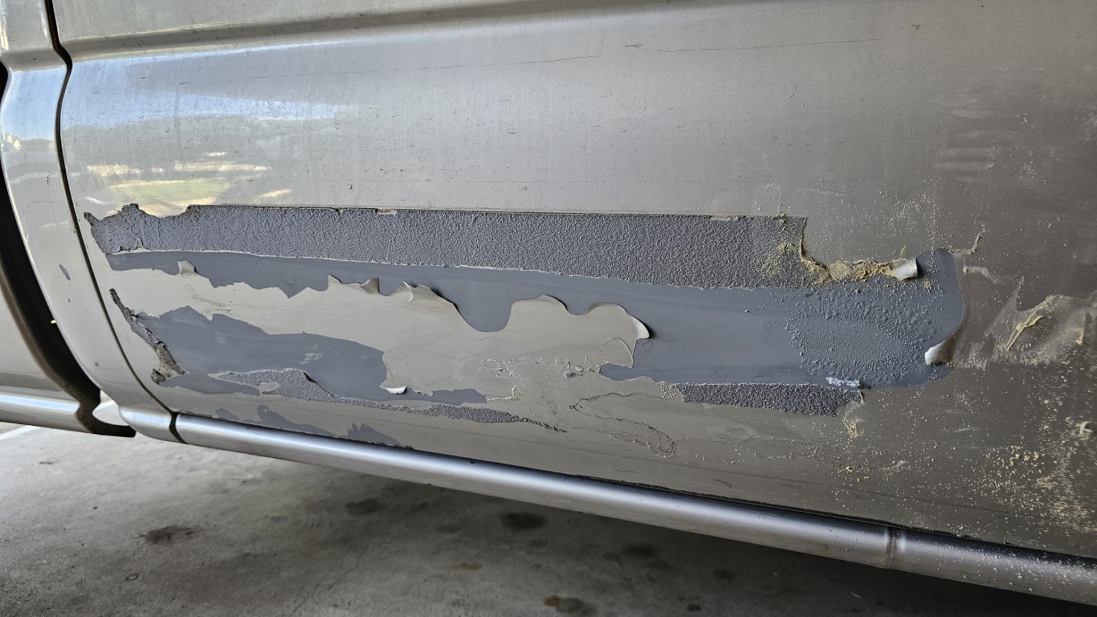

This chrome crap that someone installed is absolutely brutal to remove. The 3M tape is really holding on for dear life. Heat gun and a vise grip to get the cladding off, then an eraser wheel on a drill to remove the tape. I saw people suggest fishing line, so I got the strongest stuff I could find, it snapped within 2 minutes and barely got through any of it. Some paint pulled off in a couple small spots, which I'm not totally surprised. I HATE this stuff, more than any other lame AutoZone accessory you can possibly install on a vehicle. So far I got the pass fender, pass door and a the front corner of the box, in front of the wheel off. It'll be chipped away at here and there, god this stuff is awful. I need more eraser wheels to show up, I'm almost through the one I have.

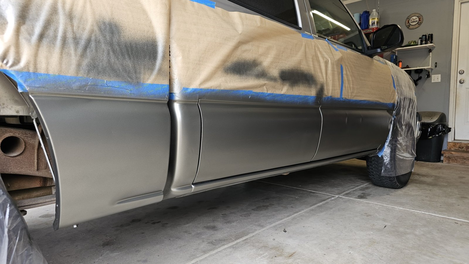

I also got all the chrome BS off finally. Once it started pulling paint off one panel, I got a little careless in removal of the rest since I decided......... now it'll need paint. I decided for a 2 tone look since it would be really hard to match the paint that's already on there since GM had so many variants of the same color. I remember working at the dealer back when these trucks were still new. You could have 2 with matching paint codes parked next to each other and they would be different shades. So I found a darker gray to go with, since I don't like the black, it always looks like those trucks when someone just tapes it off and spray paints over rust. I sanded everything out, prepped, primed, painted and cleared.
It turns out...... I am NOT a painter lmao. It's definitely good enough for this truck, since the whole rest of the body is a bit rough, but it will never be seen in any car shows any time soon (that's why I didn't fix dents, I'd be there forever with all of them). I had something off with the settings on the gun, plus weather that day, etc, but man the amount of orange peel in the paint, I make OEM paint jobs look good hahaha!!!

Tonyv__
Apr 18, 2018
4,468
10,396
Bucks county PA
2 tone is definitely a nice way to avoid a ton of headache.. since 2 tone was a common option it looks pretty natural. Looks good
