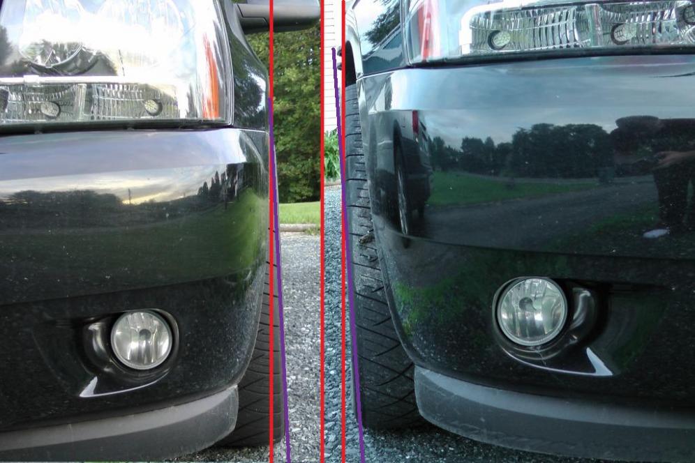

Now that I look at the pic well, the drivers side is starting look like the problem wheel. It does more some negative camber than the passenger side.

Given the slight chance the camera was perfectly straight, the pic below can kind of give you an understanding.
The pic shows perfectly straight red reference lines.
The pic also shows purple lines that I used to attempt to follow the whee/tire angle.
The passenger side may be strait, or a but positive according the the reference lines.
The drivers side is definitely negative and needs to be aligned better.
Dude, outstanding work.

That's helpful Neo ... the problem is that it's almost impossible to do it the way you are doing it because it looks like the two pics were taken at two different spots and we don't know if the angle of the road, and consequently the truck, is level.
Plus I dunno about Tahoes, but all the Denalis I've seen including my own have slight negative camber up front from the factory ... I always assumed it's the weight of the engine that does that but I'm not sure.
---------- Post added at 11:33 PM ---------- Previous post was at 11:30 PM ----------
You can sort of see it in this pic:
That's why I have the parallel straight red reference lines! They are completely straight regardless of how the pic was taken.
