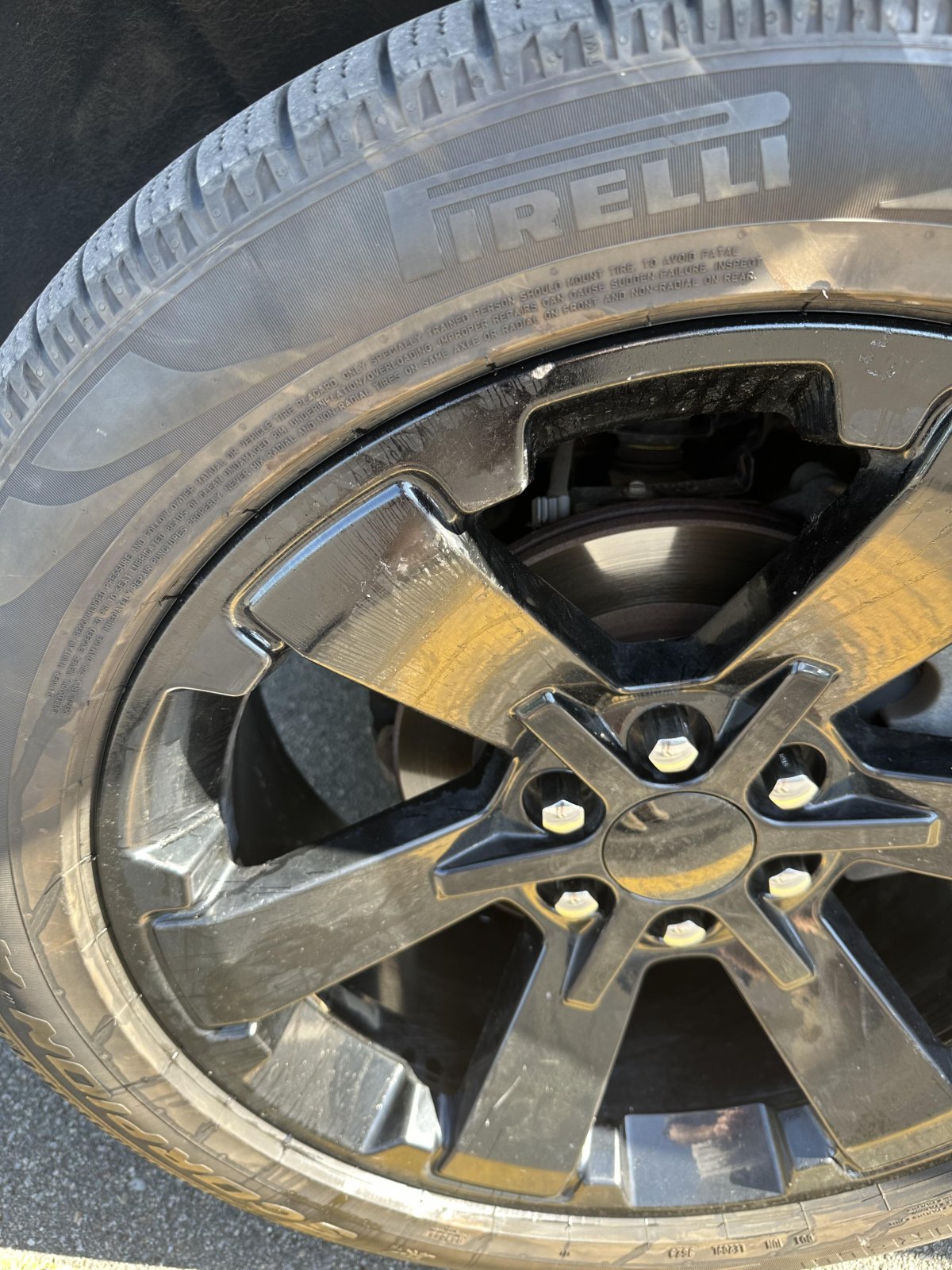

Near as I can tell, I need the calipers/pads and rotors for any 2019+ truck/suv
will need a few grade 8 washers to help center the caliper.
This may cause the caliper to hit the wheel however. (anyone know if these wheels clear?)
you might be able to grind down the extrusion on the front of the caliper or you may need to use a spacer
I might be able to grind down the extrusion on the front of the caliper or you may need to use a spacer
Here are some helpful links in case you want to grind down the calipers:
That thread also mentions which washers you'd need to use to nudge the caliper so the rotors are centered in the caliper.
I bet it also mentions if those wheels will clear without caliper grinding.
I had to use spacers to clear my 22" snowflakes..looking around for +2019 wheels..
I didn't have grin anything of the caliper due to the wheel spacers..
