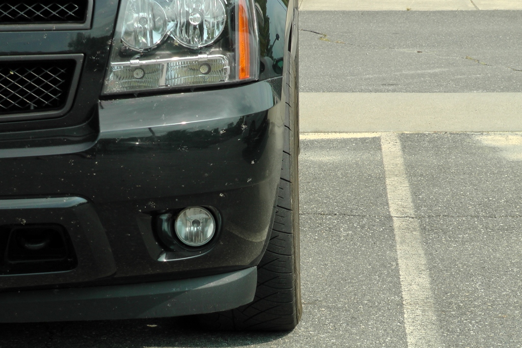

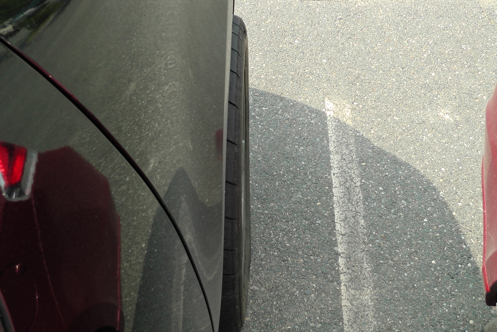

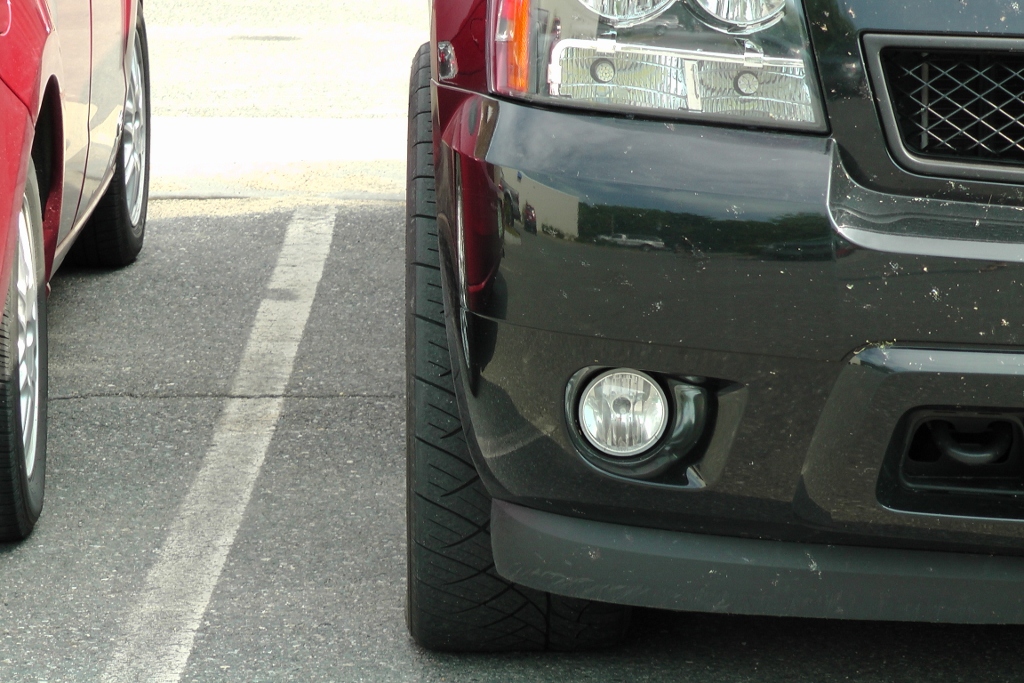

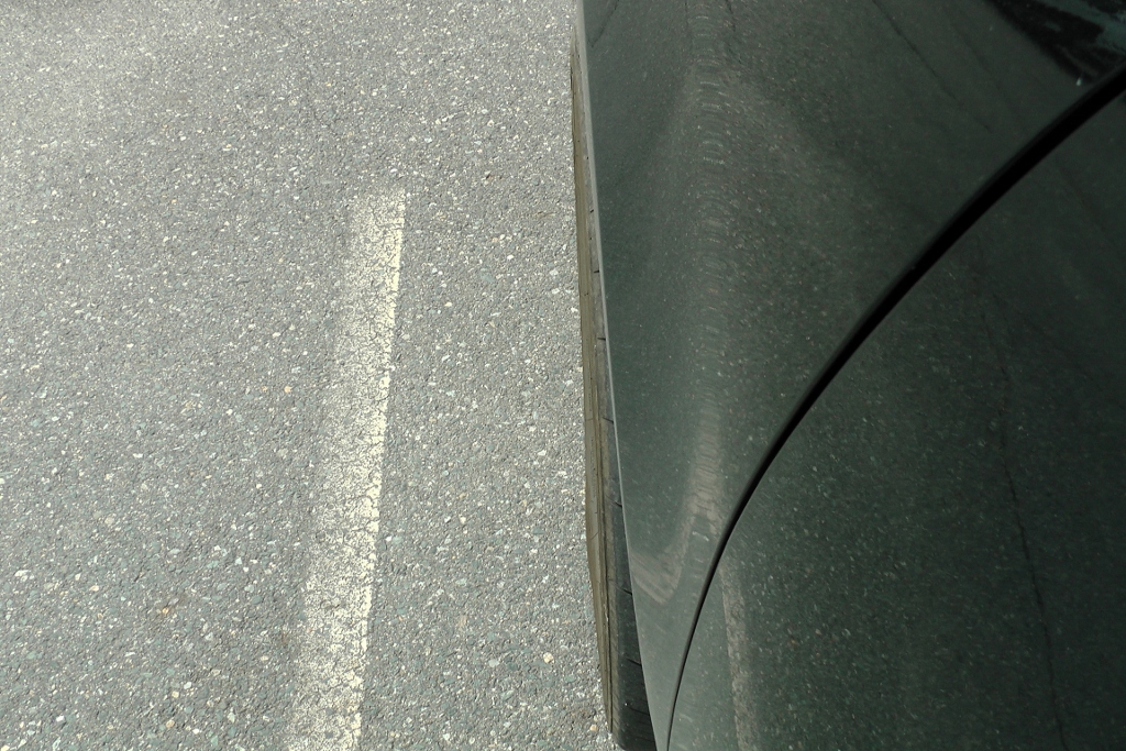

So the alignment guy said it wasn't even worth putting up on the rack. He looked at the camber on the passenger side and said it was basically maxed out, and on the driver's side it was about half way. Since it's in-spec, he surmised it's likely an upper control arm that is bent. He said he wouldn't be able to tell until he put a new arm on and got it aligned. Ian, can the arms be adjusted, or do I need to just buy a new one?

Here they are...
Drivers:
Passengers:
Drivers:
Passengers:

I thought so. No a bent control arm needs to be replaced. Seeming he did say It maxxed out meaning it cant be adjusted any more. get that replaced asap. That angle on the tire will chew through the outter edge in no time

Forgive me if I missed something,
But is it even possible for a bent UCA to cause your wheel to stick out evenly?
The UCA is more of a camber issue source. So basically, it being bent would cause negative or positive camber that would cause the top part of the wheel to be in or out more than the bottom.
If anything, it would an LCA issues (lower control arm) that causes the whole will to stick out.
If not, then I would say maybe it's an offset thing. Just because the camber adjustmnt is maxed out does not mean it is causing the whole wheel to stick out.
If all the other wheels are around a +35, and the front passenger is around a +20, that could cause the sticking out you are seeing.
Cheapest route to start with is swap the front wheels and see if the issue consists. If it does, then it is in fact suspension related.
