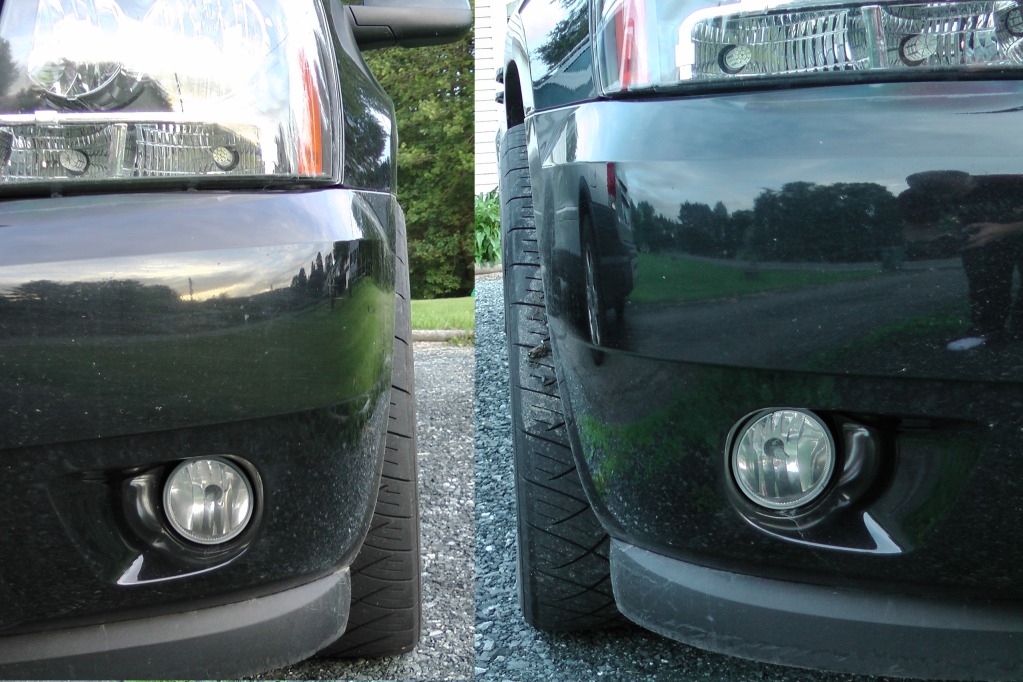

Here's a crappy one I took last week in a hurry. I'll get more with the same vantage point and different angles.

Holy shmolly!!!
Not even my old 24s with 20 offset stuck out that much.
No no no no, there's nothing good about this. :(

wow that camber is way off. Was it like that before the new rims? Didnt you lower it? I say get a alignmet, you may have damaged or bent suspension components or something wasnt tightened when it was lowered

I've got an appointment for an alignment this morning, we'll see what they say. One of the problems I'm having is no one around here is familiar with mods of any kind to these trucks, so I have to use regular mechanics and techs for everything I do, and some are kinda feeling their way through the dark I think. But yeah Ian, I used the 2" spindles up front, and I'm darn sure my old 20's and my 17" steelies weren't doing this.
