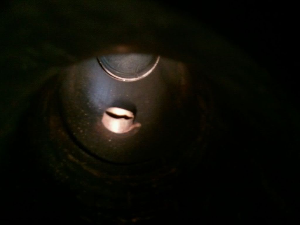

Well I cut the resonator off and a few things. 1 the escalade has a 3.5 inch cat back set up which will be perfect for my whipple 2.3 and the resonator is totally different then the tbss. Its pretty much solid inside and just one hole in the middle.

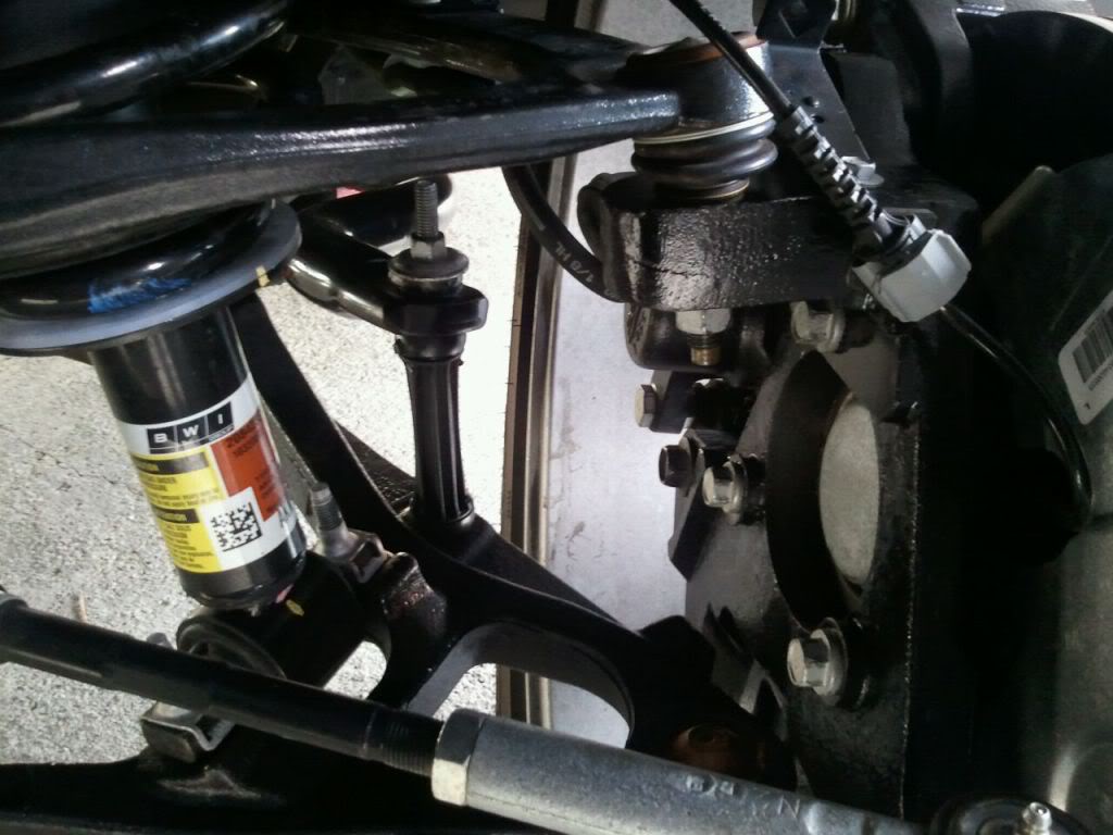

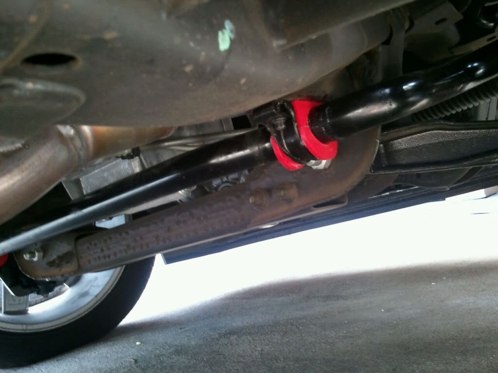

So today i did the front belltech spindles
Front swaybar
and rear shock extenders
Even with my alignment off the djm front bar and spindles make the truck feel a lot more in control. In the rear im really suprised how better it feels. Its not as jarring and more smooth and this is with the stock rear springs in only thing added was shock extenders. Im guessing the shock angle is better so has a better chance to work.
I cant wait to put the rear belltech springs along with the djm trailing arm relocators, spohn panhard bar, lower spohn a arms and last the rear djm swaybar!! Thing will feel so much better.

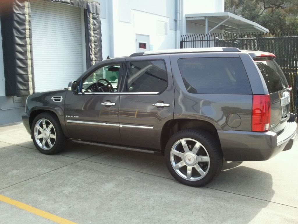

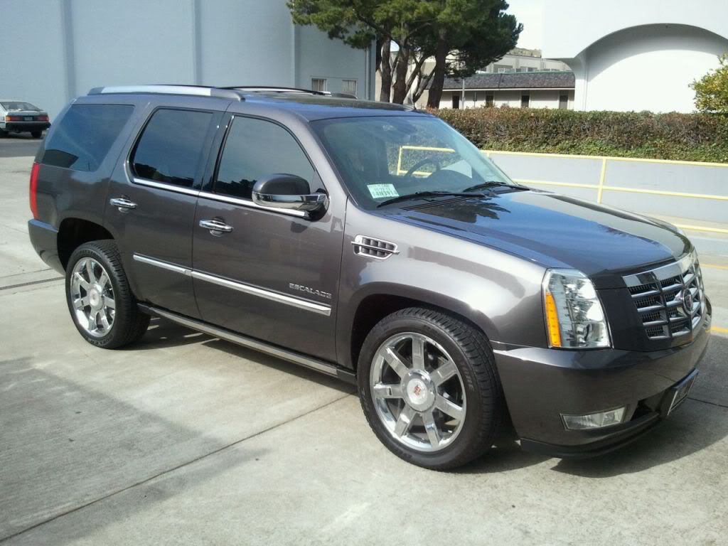

riht now
FRONT 33 7/8 from ground to fenderlip
REAR 37 7/8 From ground to fenderlip
LAST but not least!! esky 24" chrome replicas with 305 35 24 Yokohama tires
