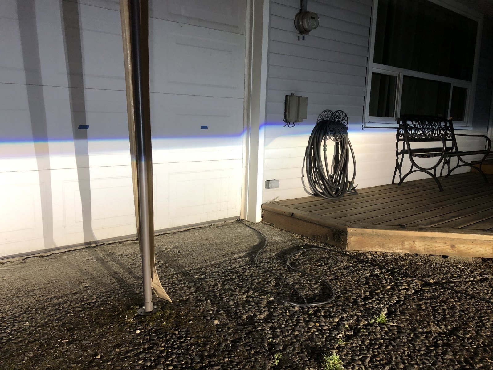

Its also looks like the output shots might have gone away...no idea what happened there, since I have a Pro flickr account...i pay for that ish to work haha...anyway...i've got some new shots i can post here so you can see the excellence that can be had.
Low beams and fogs out on the skreet
full
Same spot but with (2) high beams on and the fogs
full
I dont loose many light flashing battles haha.
heres another on the road....everything is right where its supposed to be, i have yet to get flashed by on coming traffic
full
original output shot in a parking lot
full
The wet performance doesnt suffer a bit. Cant say about snow, i didnt go out in it this year but in previous years its like warp speed from star wars hahaha
