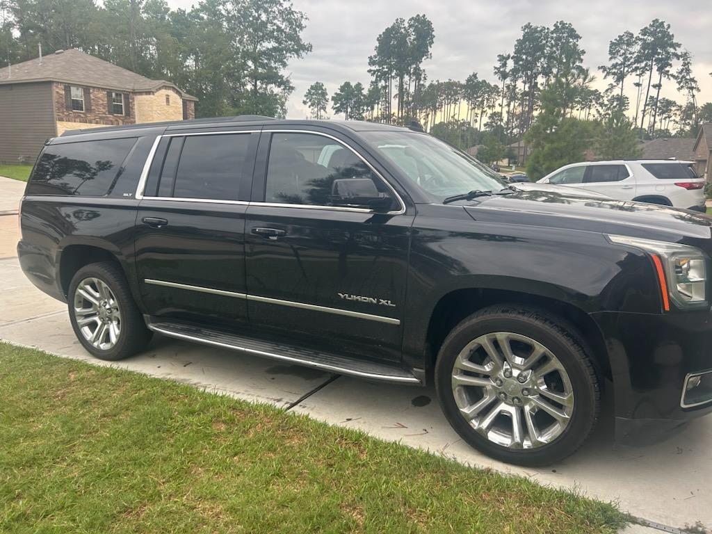

Good point. I assumed the filter would catch it. It's the 5.3 motor rwd so it should be the 6L80E, but I will verify by looking for the code.
10,284
14,891
Welcome to the Forum from NH.
Pics of the truck, please.
You are already receiving sage advice from the knowledgeable folks on this Forum, and more will be coming from Nick.

No problem, sorry about that. Thank you, from Texas
