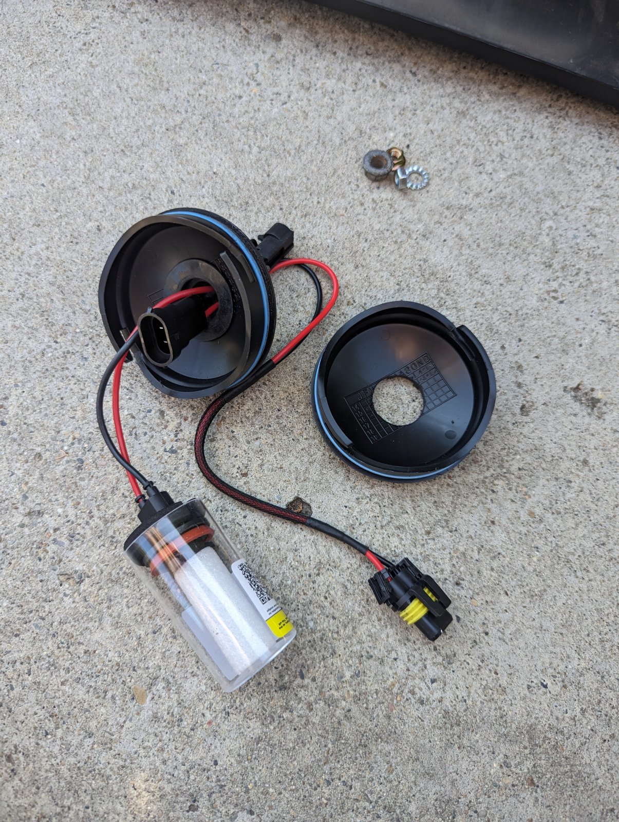

Hey guys. Just got some new Morimoto LED 2 Stroke Bulbs for my low beams on 2019 Tahoe LT and I swear they are no brighter than the old halogen bulbs. Previously, I had some HID bulbs and ballasts in there and they started to dim and found out they weren't getting enough power anymore (around 10 watts). Just assumed the ballasts had gone bad after a few years. I also have some other LED bulbs in my fog lights (forget the brand) and they are brighter alone than the Morimoto low beams. My headlights are the stock projectors. What am I doing wrong here? Is it possible the bulbs themselves are not getting enough power? I had always understood that these Morimoto bulbs were top of the line and were incredibly bright but not my experience so far. Then again, could be an issue with the actual vehicle and not the bulbs. Any help would be greatly appreciated for these old eyes! Thanks.

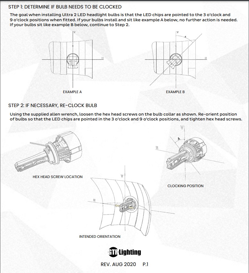

First, are your new LED lights properly adjusted? From the displayed light pattern, it appears that they are. But, just to be sure, the position of the LED sticks in the headlight lousing should look like this.

Halogen projectors have different optics and designed differently than HID projectors. Therefore light output from the same bulb will be less brilliant in a halogen projector right off the bat. Something to keep in mind. LED bulb clocking advice above is good to maximize output.
