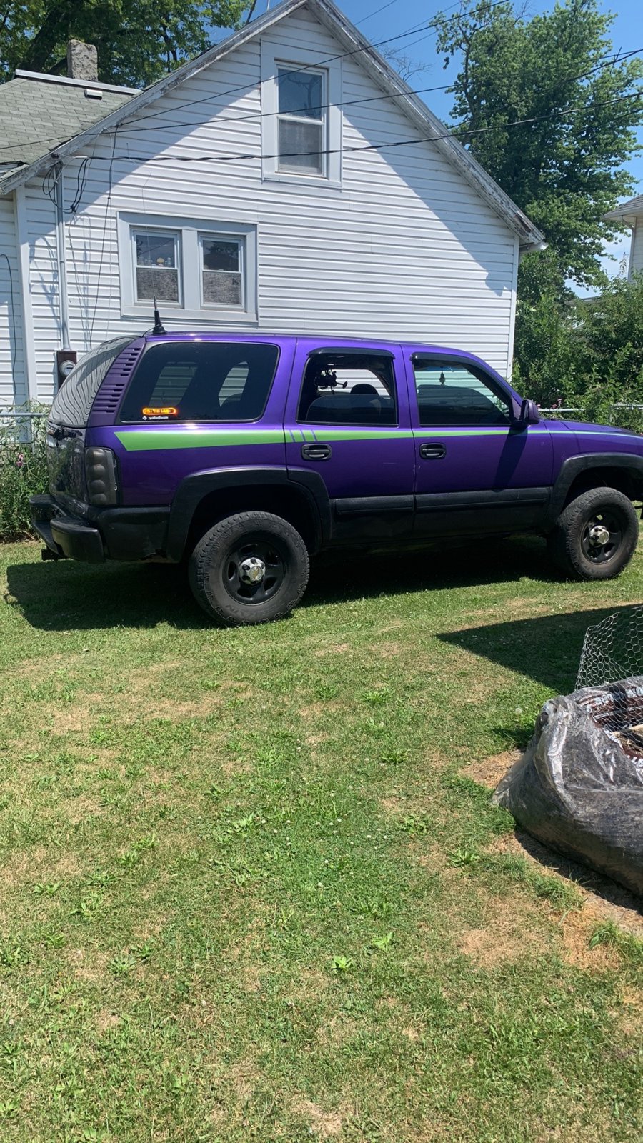

Currently I’m on cranked keys with other work being needed/in progress Or it would be done.
If my rig wasn’t like this until a couple days ago I would’ve installed my lift I’ve been battling my ac system. next weekend it’s lift time. After this picture I fully fixed the ac system minus the climate control module for the front ($130) and a connector I broke ($10-46)+ labor the only reason I’m including labor is because I’m tired of messing with the AC for Atleast a few months. (there’s a leak at the evaporator I believe that I can’t test until the systems work fully functioning).
