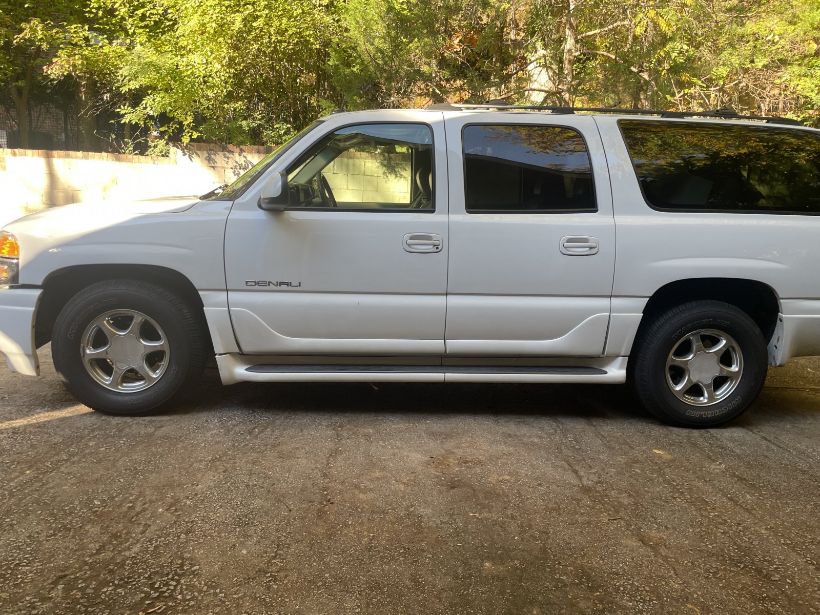

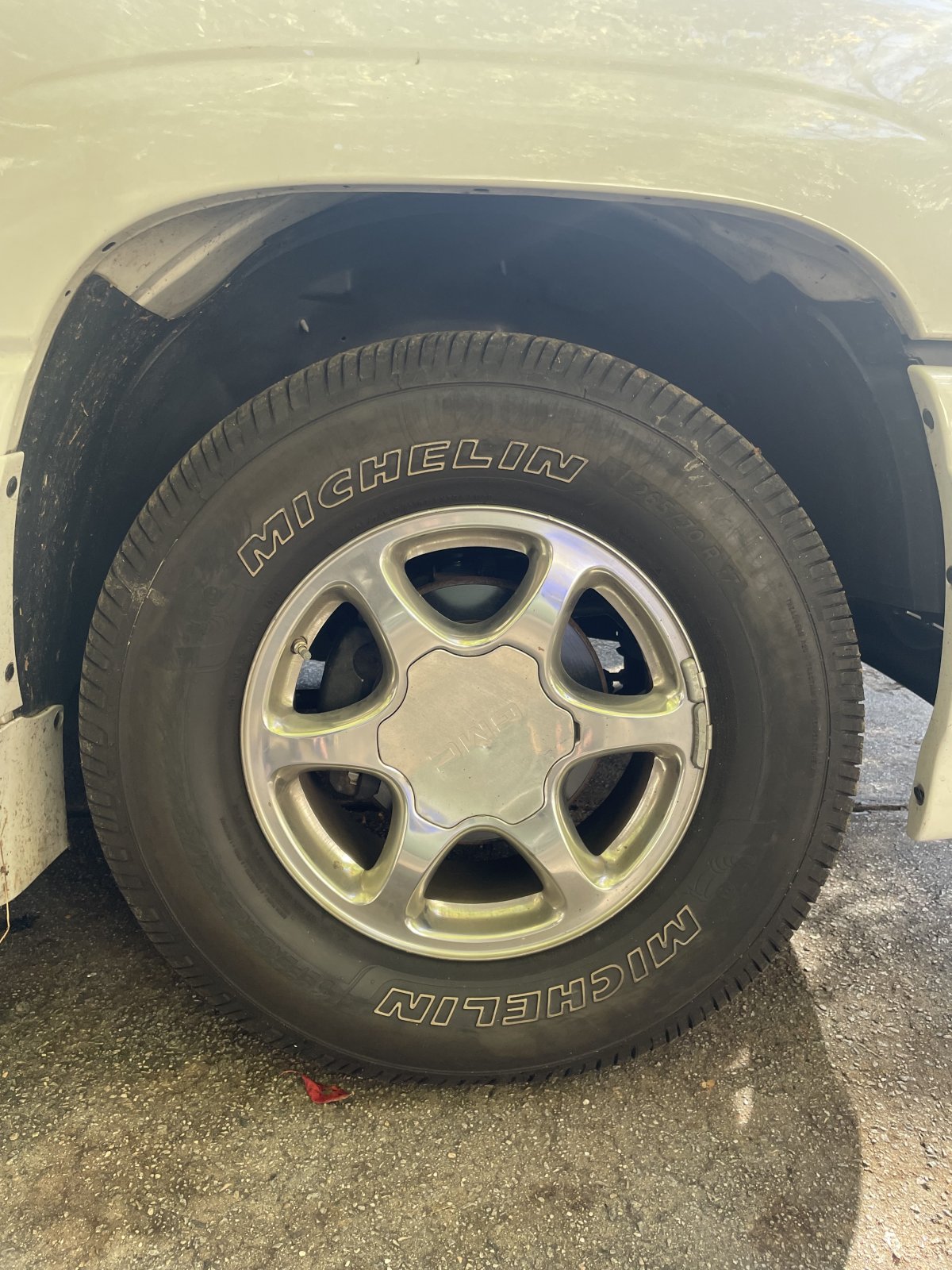

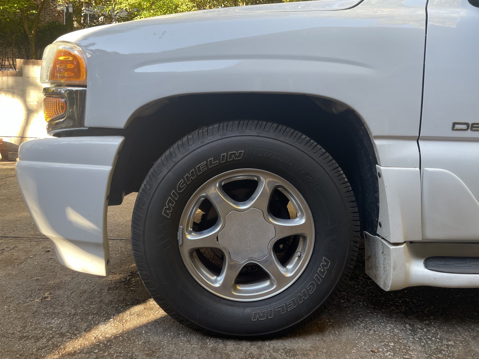

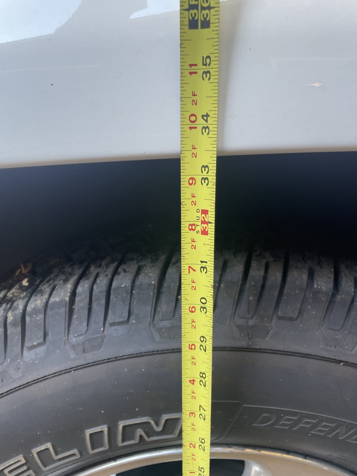

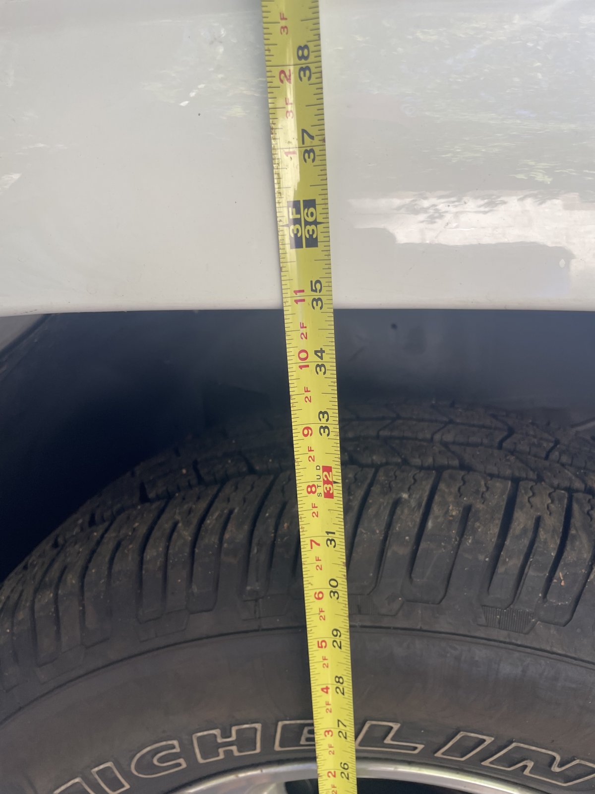

I recently did a full front end rebuild sans shocks and axles. I do have z55 package and am looking to keep it that way. After the rebuild I went to check my Z Height and it’s about 2.5” below spec which is 4.7”. It’s hard to take pic under the car for the Z so as a proxy did a ground to fender lip measurement. Front left is 33.5” from ground and front right is 35” - see photos. Rear is 36” on drivers and 36.75” on pass. I always noticed some rake but now that I have a bunch invested in genuine parts for the refresh I’m not ok with the level of sag. Here are my questions and what I will try today to see if it helps.

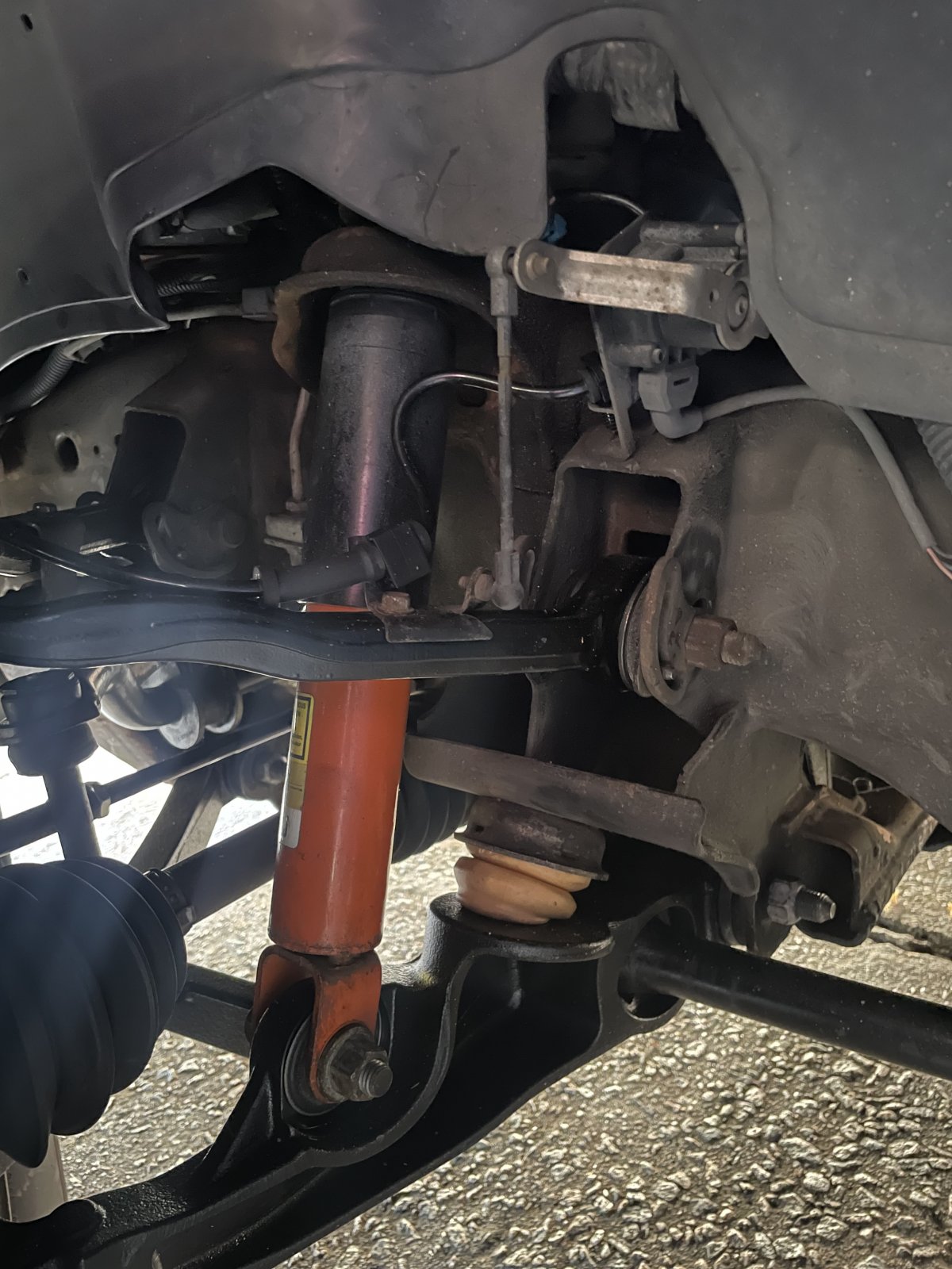

1- I will plan on rotating the torsion bar today (will try 180 degrees) to see if that makes any difference and report back. Haynes manual says to mark the torsion bar - does it matter which rotation it goes back in? It seems that it would not but I do see a small white paint dot about 2’ back from the front on the driver side (left) bar, facing down. Pass bar has a yellow paint dot in the same location but is on top of bar as inserted
2- drivers side torsion key screw is much easier to turn than the passenger side key and is about 1” further screwed in. There is maybe .5” left before drivers key screw is bottomed out. I removed the keys and cleaned them up as well as the bar and greased a bit before reinstalling. Torsion bushings are fine.
3- my rear pass side height is higher than read driver so will check ride height sensor there in case it’s overextended and pushing down on front driver side, since the rear is tied to the compressor.
4- the jounce pads are WAY compressed which for me is ultimate confirmation that it is too low beyond just Z Height spec.

Update- So today I jacked up the front end, slid the torsion bar towards the front, turned two hex sides clockwise, and then tightened her back up. Almost immediately I could tell there was more tension as I was applying force with the torsion bar tool to slide in the adjustment nut block. I decided to do the same thing with the passenger side - disengage, turn two notches, then back in. Adjusted the bolts back to where they were originally before my rebuild. Went for a long ride, over a bunch of speed bumps, and when I got back - checked my drivers side and it's 1" higher! from 33.5 to 34.5. bounced on the bumper a bunch - measured a total of 3 times and still the same. Fingers crossed - will provide another update soon. I'm also considering going to the local pick n pull and snagging a left bar to see if it makes another difference. I checked and price is $35 - seems a no brainer. Will ensure same code in glove box - which is 6XL and 7XL
