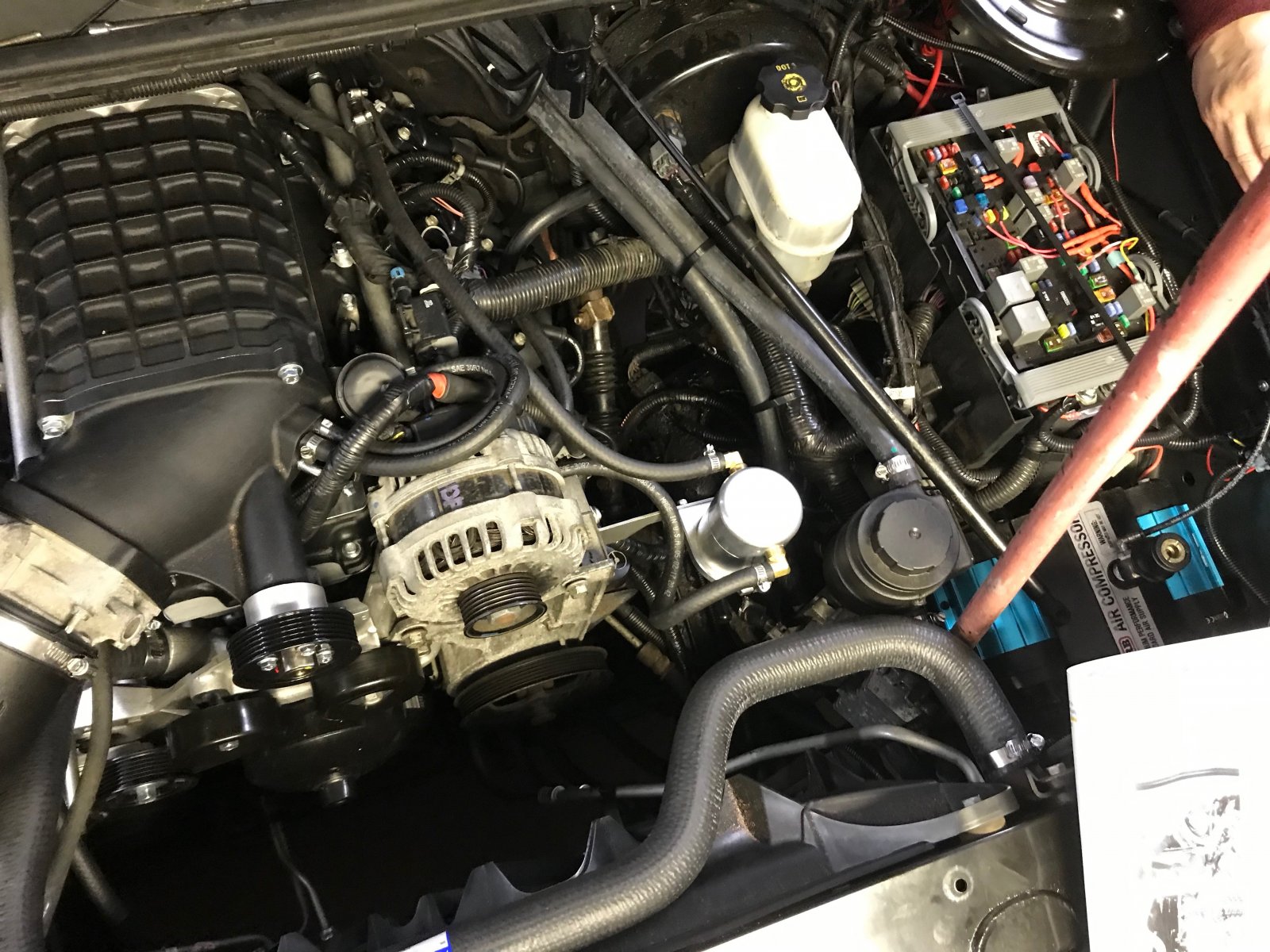

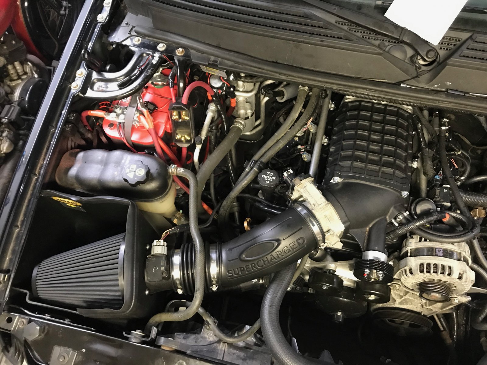

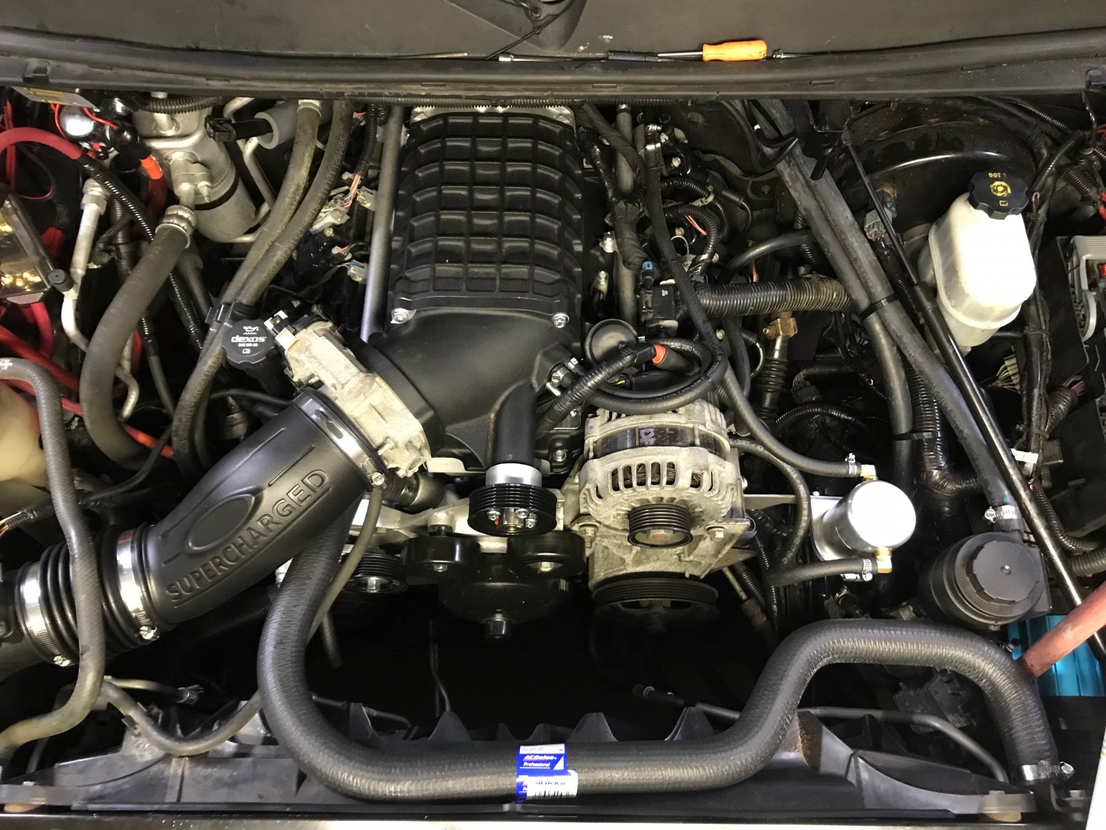

Just a little update for guys who decided to go with Magnuson, ignition coil closer to cylinder 1 and 8 need to get raised 1/8" so they don't rub against wires from fuel injectors.

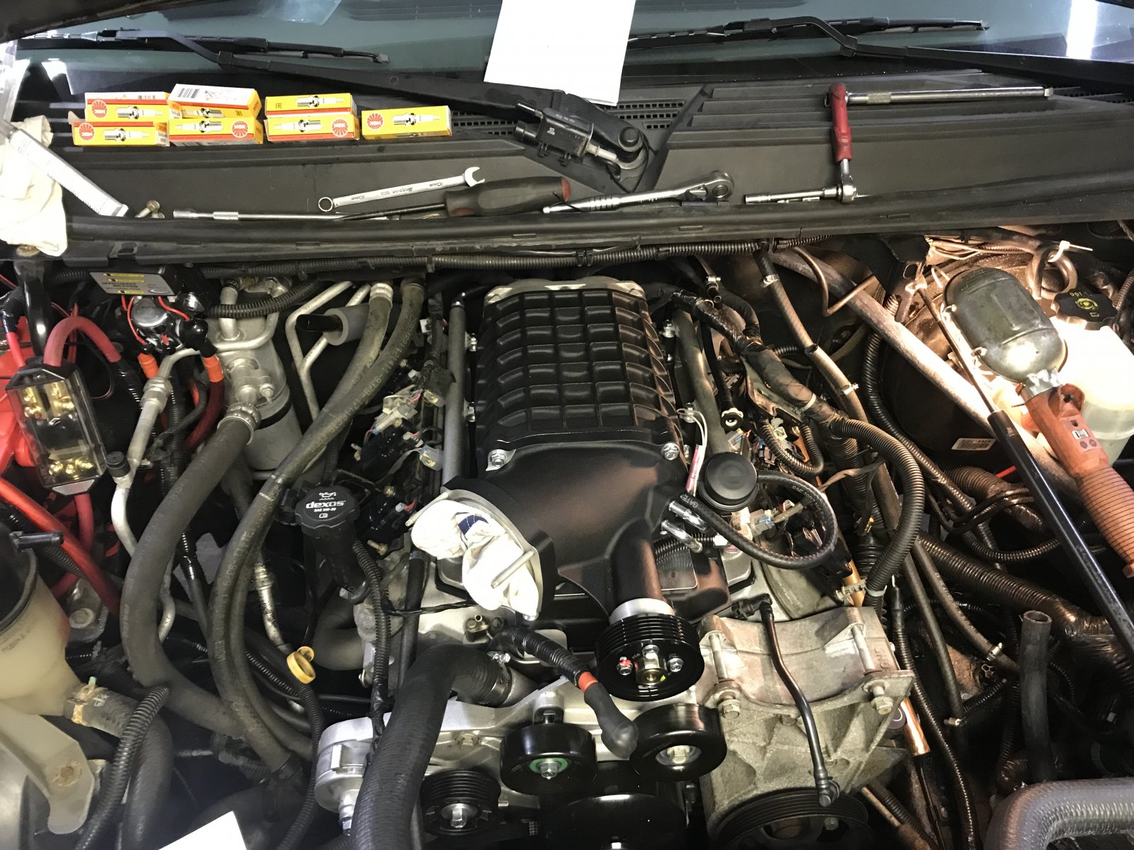

Drove my truck home today about a 45 minute ride, didn’t push it yet as I have to send driving log back to BB they advised not to go crazy before they look at my log. I won’t be able to erase the smile from my face for a long time as a first impression and with out flooring it,
supercharger whines like crazy (pretty loud) wideband is ok for most part definitely room for BB to improve. Noticed that transmission is not downshifting as much, as far as temperatures goes it stays at 160-170 on the highway and around 190 in the city stop and go traffic. I can’t even compare circle D torque converter to the stock because there is nothing to compare, night and day difference. Overall I am a very happy camper. One thing that bothers me is like a belt noise but I think thats the new headers or a cam.

Belt noise as in the whine from the belt , or just in general additional noise from belt tension ?
