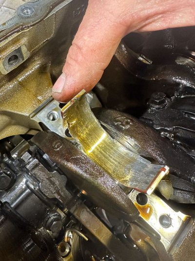

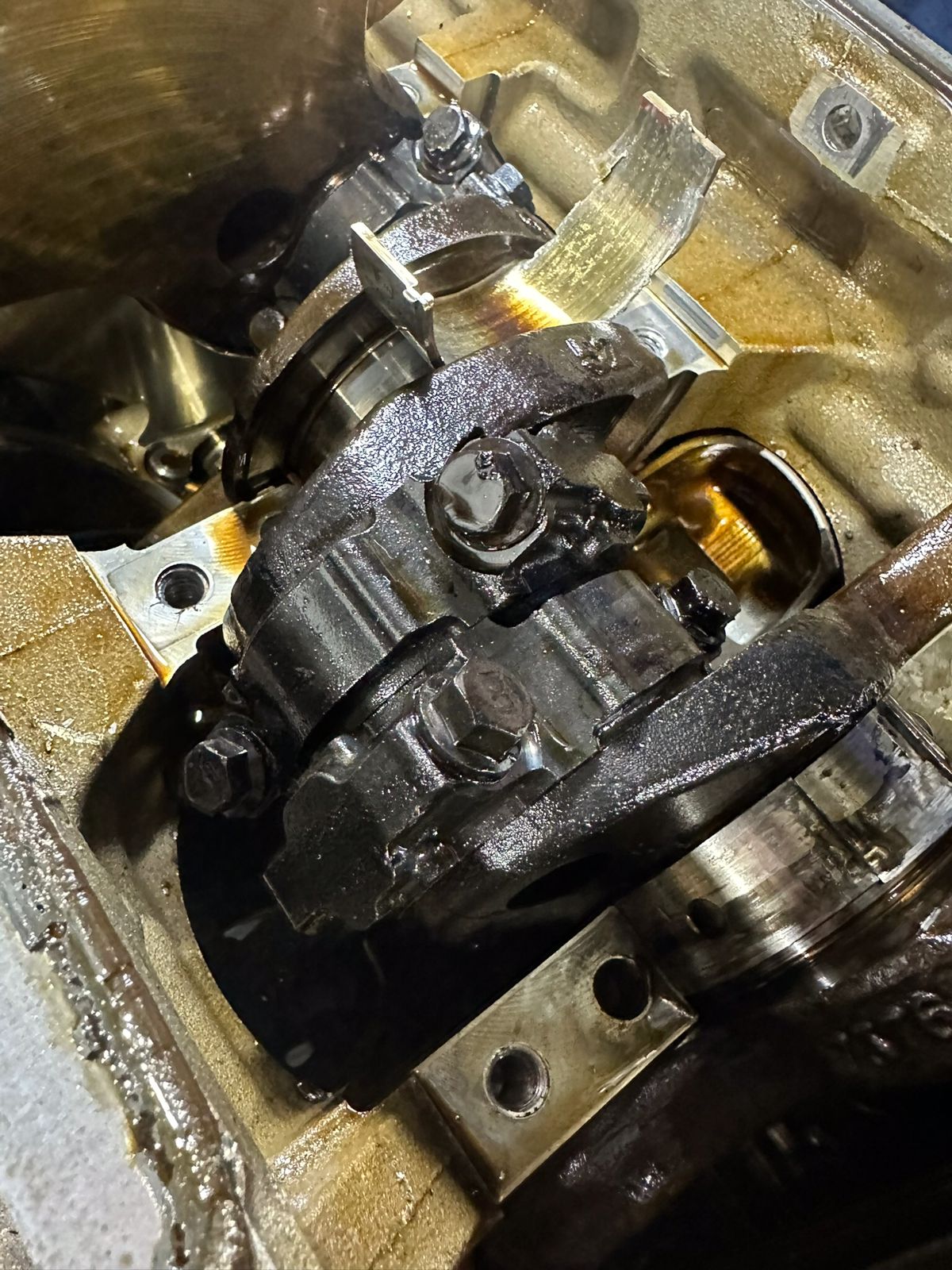

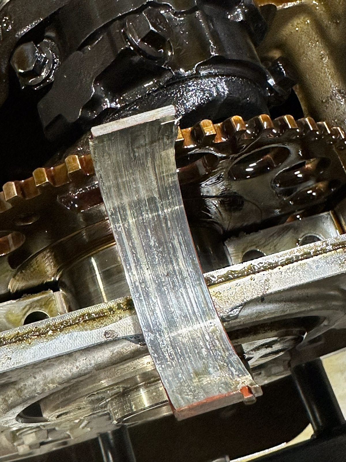

No, no, you misunderstood. This photo is not of bearings from broken engines. These are damaged bearings from engines in which the filter was cut during the oil change and metal shavings were found. That's when they open the engine and take out these inserts. This is a repair before the fatal destruction of the engine.When damaged, it looks like this.That's right about oil starvation, you're right, at some point the oil stops flowing into the engine, and this is most likely due to clogged oil channels with metal shavings. And metal shavings appear just because of the forced running-in of a new engine, without frequent oil changes during the first thousand miles. And by the way, to better wash out the metallic particles from the engine, you just need maximum liquid oil

Ouch, Mains and Rod Bearings spun. Sorry I based my comments on the photo’s I viewed in your earlier post.
We used to lay out all bearings in order as they were removed and you could usually follow the failure path. Once metal gets in the oil there is secondary damage you can see always following the oil gallery supply route.
Oil related failures always started at the point furthest from the oil supply as they would starve first and damage would get less as you were closer to the oil supply. The galleries in the block need to be studied in each engine design to determine how oil is supplied for that specific design.
It would be good to be able to examine the parts and look for the actual first failure point.

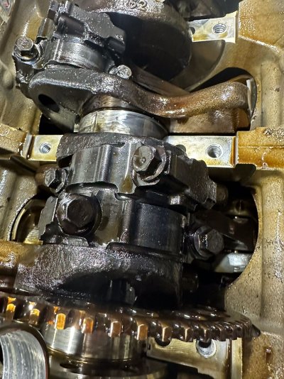

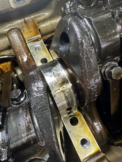

This is my engine after it jammed. There's no point in trying to trace anything there at all. The liners were turned and ground there. The connecting rods are generally all black. The oil was generally above 200 C. Because when I touched the dipstick, I immediately got a deep-fried burn. The engine jammed at 94 miles per hour while driving with a heavy trailer on the Highway. So there's nothing left of the engine.
There is also a nuance, when the engine is suddenly jammed on the track, the torque converter in the automatic transmission is also damaged.
