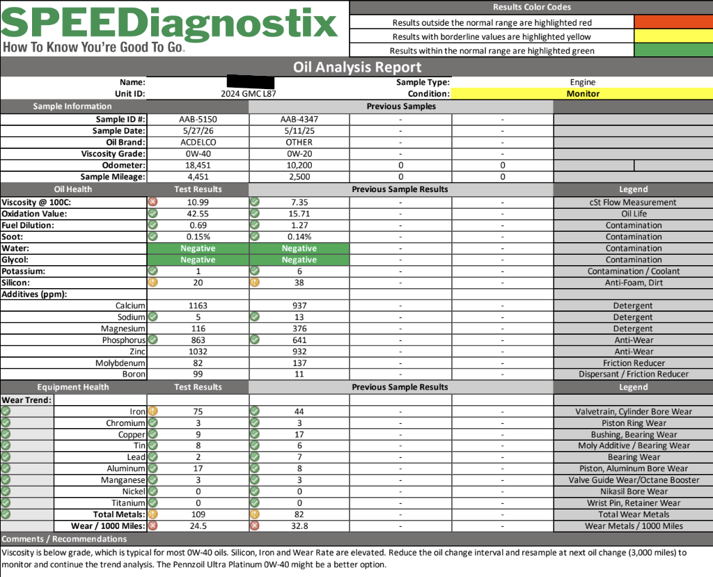

Let me tell you an L87 story, with documented evidence of how bad these engines are.
My 2024 Yukon Denali is just over 2 years old with 20k miles on it. Passed the Pico Test at its first post-recall service.
At that time the oil was changed to 0w-40 and got the new cap.
2500 miles later I changed the oil and filter again and did a UOA with Lake Speed.
The UOA show elevated levels of Silicon and wear metals. Not absolutely outside the possibility that it was still breaking in.
So we carried on, and in another 2500 miles I changed the oil and filter for the 3rd time. No UOA this time.
Just last week we took a long trip and upon my return, with nearly 20k on the clock, I decided to do another oil change and send a sample off to Lake again.
Upon receiving the results of this UOA I was very disapointed to see the total wear metals still increasing.

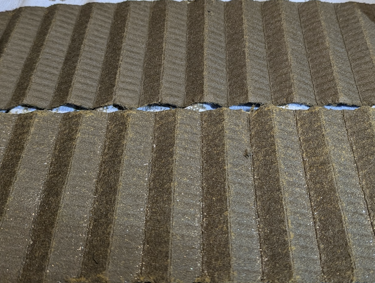

As a result I decided to cut open the filter. I found considerable bearing material in the pleats.
At 20,000 miles after 4 changes, this engine should be clean and free of any metal.
Attached are the UOA and a filter pic. The closer side of the filter is the side full of swarf. The farther sided is the outside where there is none.
The difference is clear.
This engine is going to fail, yet the dealer says it passed and is "good to go"

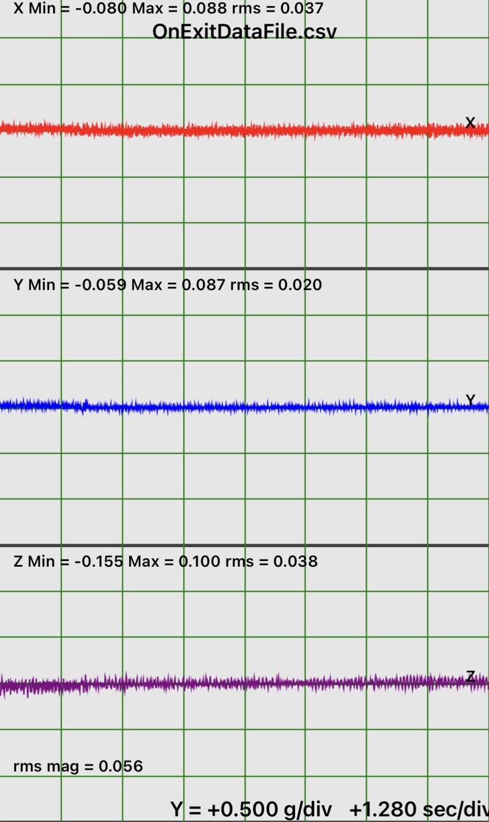

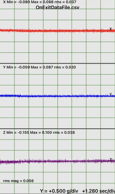

I am not sure why the gm pico test is at 2k rpm. I think you should look at idle, 2k and then run it up and down in rpm looking for some clearance… i am an engineer.. what do i know? At 2k rpm.. oil pressure is high. You won’t find much clearance issues..
I had a vibration sensor on my 5.3 motor. The v8 has some forces from the left bank.. some from the right side.. these are at 90 deg angles.. i did not see anything looking at x,y and z axis…

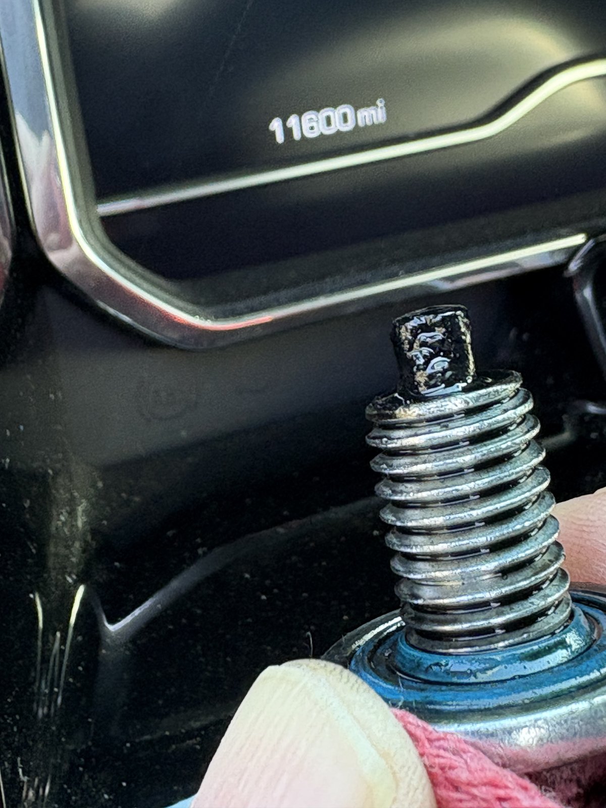

And i have just a little on my mag drain.
Your engine.. does not look good. Bummer

The dirt/silicon readings are really standing out. With 20,000 miles that should be minimal and well below 20 ppm.
The iron readings are also unexpectedly high given the typical way the engines fail.
And I would agree that the oil analysis suggest incipient failure of some sort is occuring.
