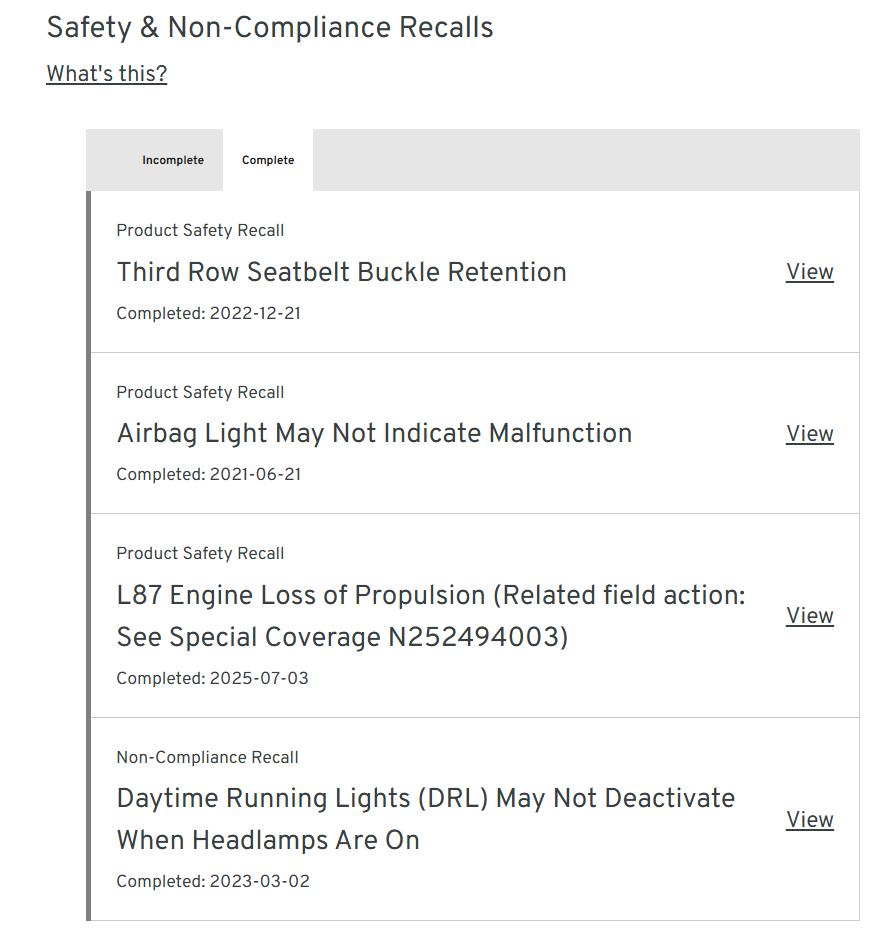

If you go to https://experience.gm.com/ and create and account, you can lookup you're VIN yourself - and see if you actually have a recall notice! You don't need to depend on a dealer.
For example, my 2021 went in for the PICO test and passed and this is what my VIN shows right now.... Notice the "L87 Engine Loss..." recall is listed as "Complete".
If you have an Onstar/MyChevrolet/MyGMC/MyCadillac account your logon
will work on this site also.
