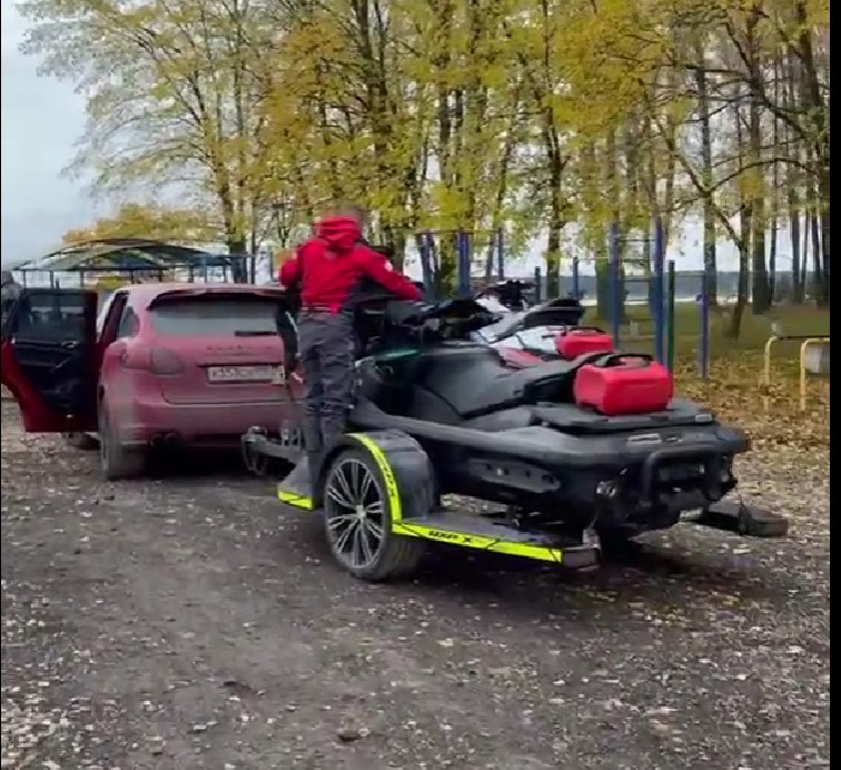

Most trailer tires can't take 55 miles an hour, let alone 95. That would be a rolling bomb as far as I would be concerned.....
What kind of tires do you have? In principle, cheap trailer tires have a speed index of 140 kmh, or almost 90 mph. And if you put sports, high-speed tires, then people with trailers and jet skis travel 200 kmh, which is 125 mph or more))
In the US, common trailer tires are not rated for 90mph+ is my understanding. This is from -https://tirecrunch.com/trailer-tires-speed-rating/
I do "L" with 75mph top speed so I can cruise at 70'ish on interstates - but it costs extra. The M/N (81/87mph) tires are even more expensive and I don't think people pay for it often. They don't even list 95mph - which is why (I think) people are questioning the 94mph comment. Of course Russia is not the US and no reason tires shouldn't be different ratings.
