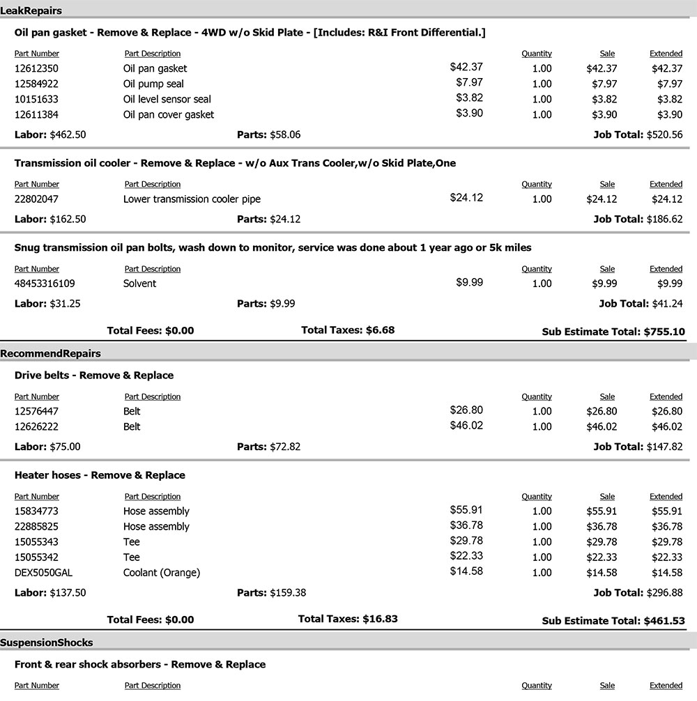

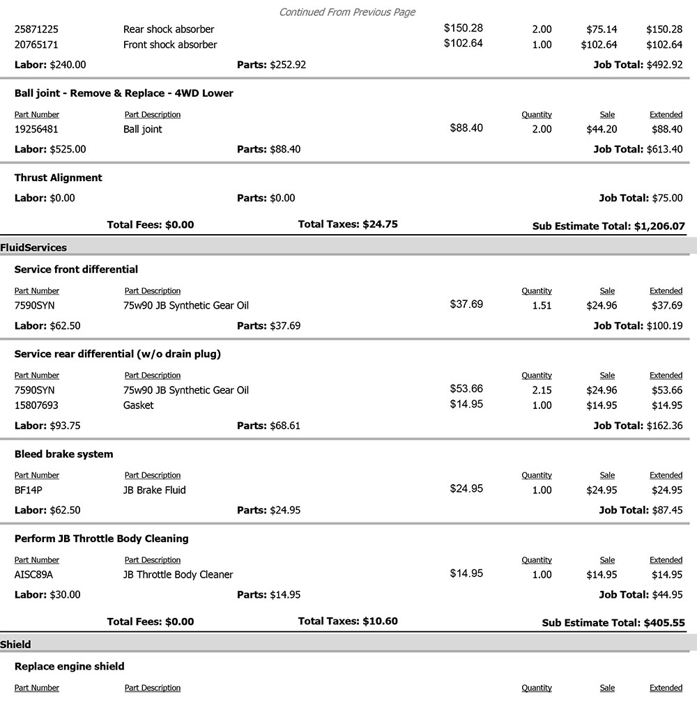

Yep. Sounds right. I got my 2001 Denali with 170k miles and had to do a bunch of that stuff.
I paid for it. I have three kids, and they're too young to help. Man am I looking forward to the day that they're more of an asset than a liability in the garage.

Oh, and, factor in cost of tools, both acquisition cost, and storage cost.
