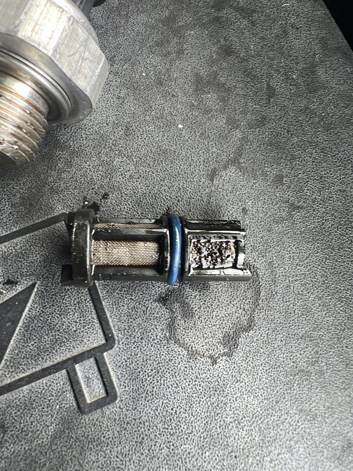

I didn’t want to sound stupid on the magic in a bottle either guys I know that’s not the proper way I was just hoping if I flushed the oil good and changed it out before I go to drive home Friday maybe it would act right for me without sounding like ima blow the top end out of her. I know the engine is gunked up from the oil pressure screens I’ve replaced like 3-4 in the past 75,000 miles this pic is the most recent one and the worst so far
Holy crap!
