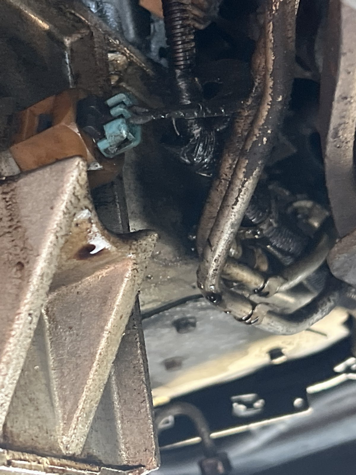

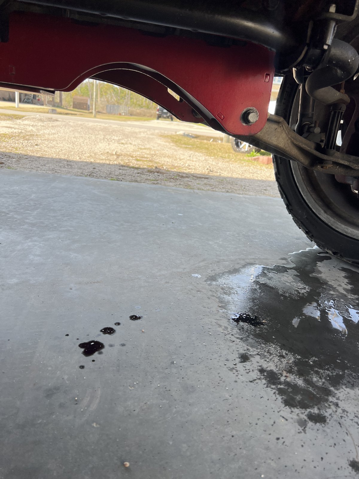

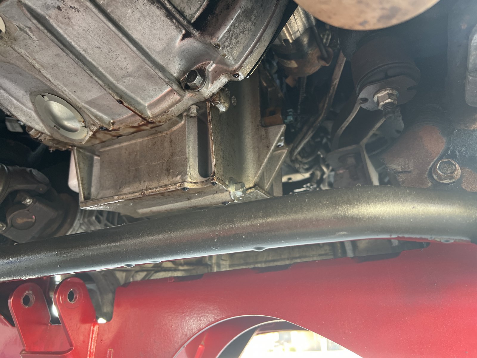

Not horrible but still want to trace it out if possible

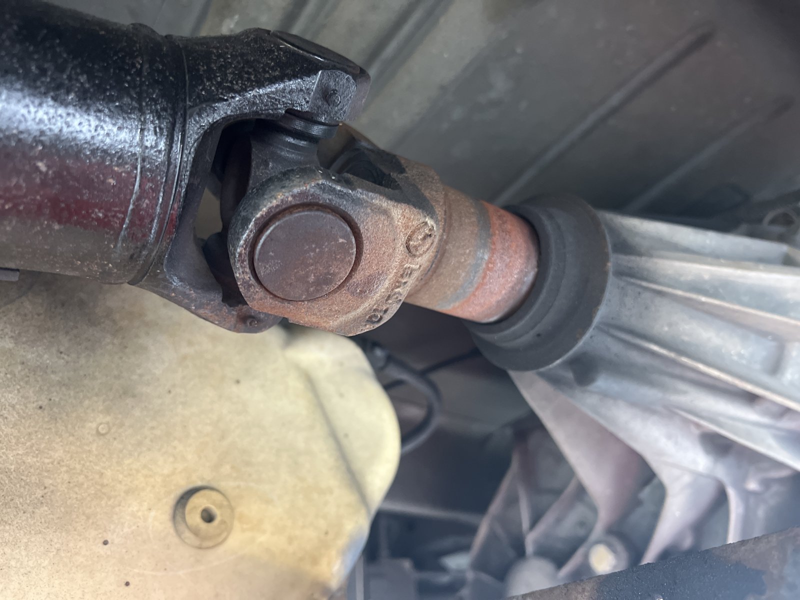

Also my yoke has been like this ever since lifting it im assuming I would need a longer yoke or extended driveshaft? Not problems so far but figured I’d get y’all’s opinions
Got new u joints I have to make the time to install

Looks like you got yourself a good old fashioned rear main seal leak there sonny. Along with possibly an oil sender,valve cover gaskets, and whatever can give up at 325k. LOL
I'd probably address the driveshaft sooner than later. I know they slide in quite a bit to make up for suspension travel, etc. But seeing your suspension is always traveling......away, you'll probably want more contact on the output shaft splines before they cease to exist.
