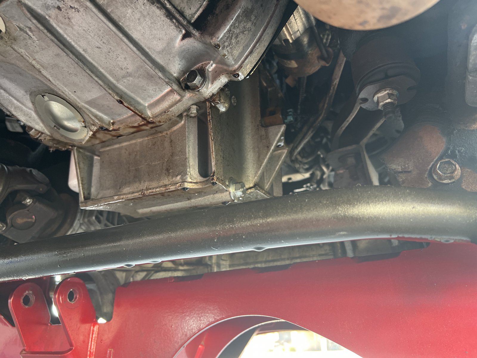

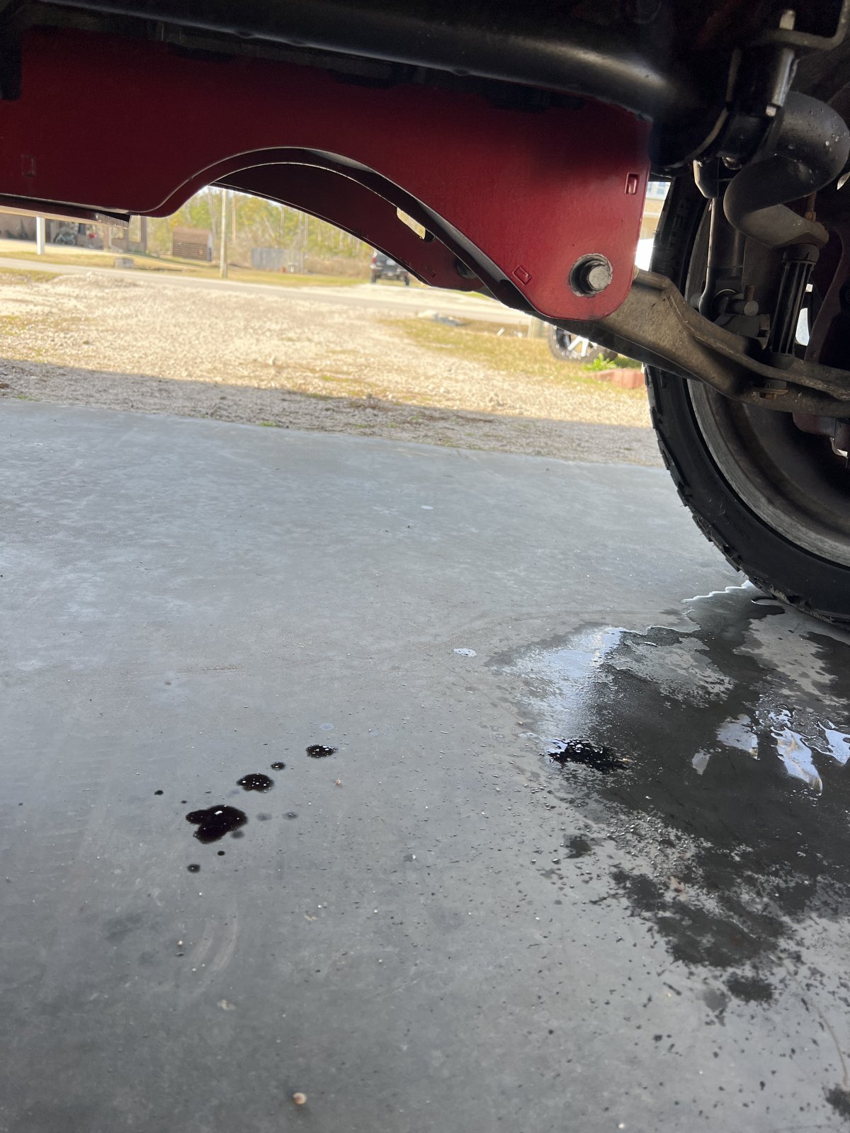

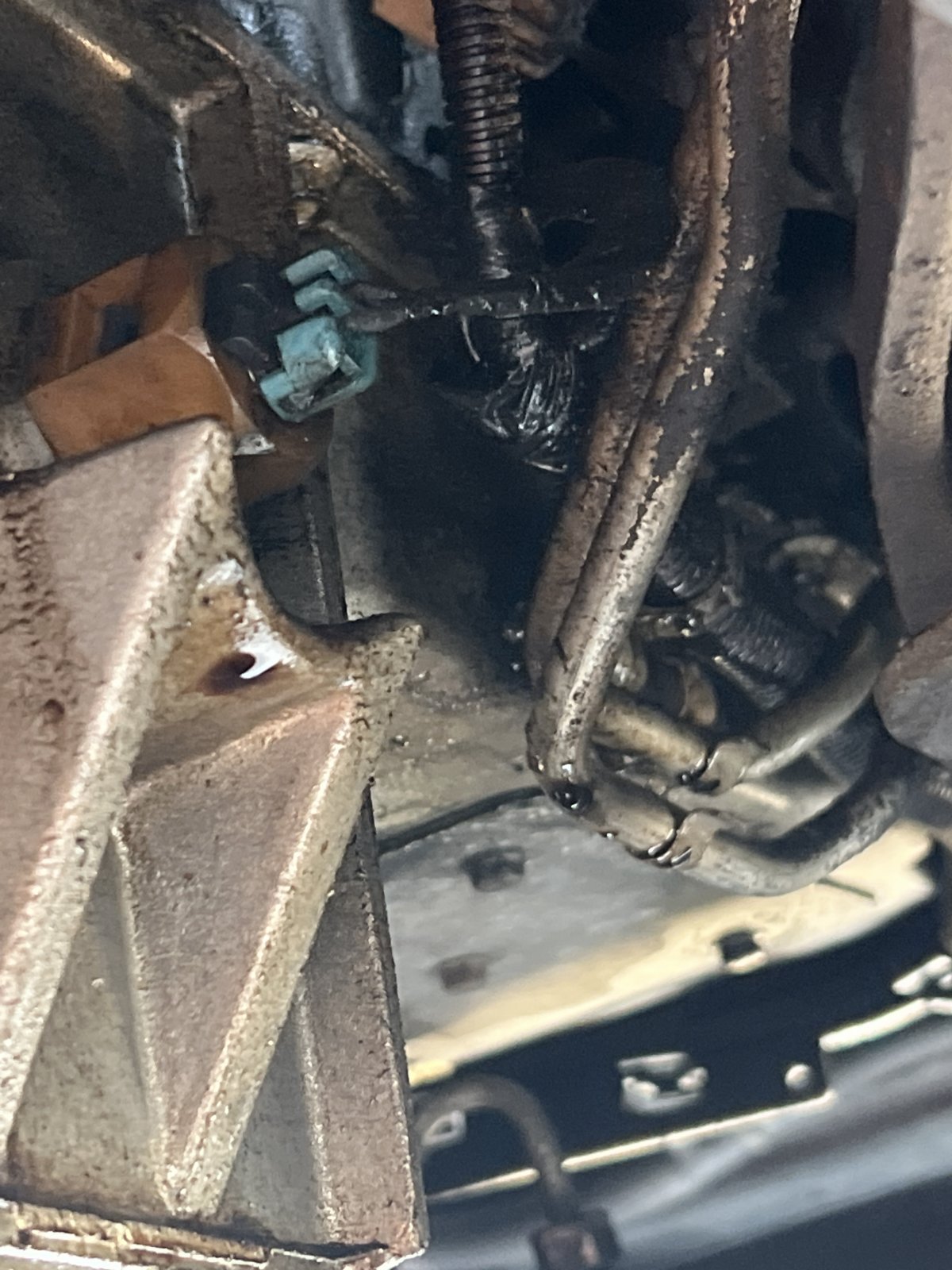

Looks like you got yourself a good old fashioned rear main seal leak there sonny. Along with possibly an oil sender,valve cover gaskets, and whatever can give up at 325k. LOL

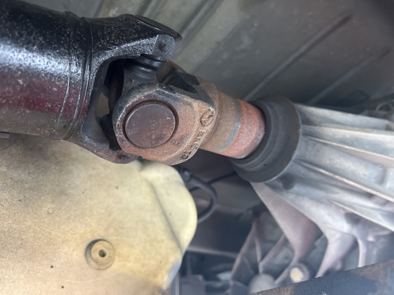

I'd probably address the driveshaft sooner than later. I know they slide in quite a bit to make up for suspension travel, etc. But seeing your suspension is always traveling......away, you'll probably want more contact on the output shaft splines before they cease to exist.
Just cleaned up the valve covers the best I could I’ve ruled them out I believe it’s the oil sender possibly a pan gasket but more then likely the rear main seal leak I’ve had since I got it. That’s not getting fixed until I go to do a transmission or rebuild the motor

View attachment 392759View attachment 392760View attachment 392761
Not horrible but still want to trace it out if possible
Also my yoke has been like this ever since lifting it im assuming I would need a longer yoke or extended driveshaft? Not problems so far but figured I’d get y’all’s opinions
Got new u joints I have to make the time to install
Welcome to the RM seal club. I have been chasing down oil leaks on this old girl since I bought it. Seems like every time I replace a gasket another old one blows out form the high mileage and crankcase pressure from blowby. I have 4WD so no way am I going to lay on my back to pull the trans and install a new RMS. Getting to old for that S.
Which means I would have to pay somebody a few grand to do it. I can't justify that expense for an engine getting ready to hit 350K.
