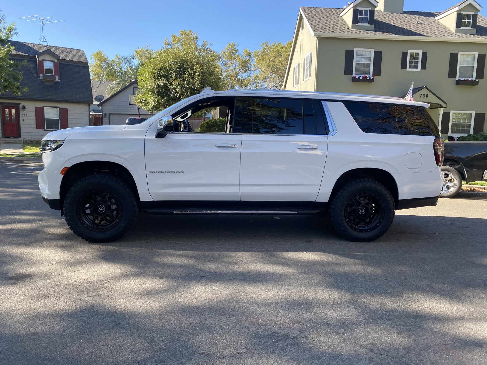

Lifted/Leveled 2021 - Postem Up
22burban
Aug 4, 2024
2022 Suburban Premier. RC 3.5 kit
Black Rhino Kelso wheels 20x9 +0 offset
Toyo Open Country ATIII 285/65/20
Had to trim some plastic and will have to pull back fender liner. Slight rub at full turn

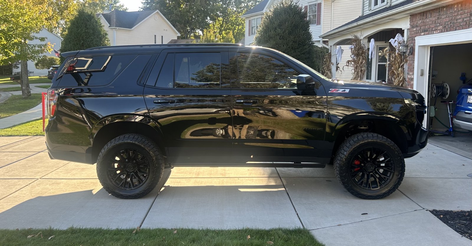

Seems most kits put the z71 slightly nose high. I agree on being level from factory. Rough country is 2” front 1” rear. The 3.5” rough country also lifts the front higher. And the readylift 3”, that I have, does 3” front 2” rear.
With all of these kits the other trims look level, just seems to be the z71 that end up nose high from what I’ve seen.
One person reported an upper ball joint failure on the stock UCA’s and 2” RC. That’s what I had at first and wanted to go higher anyway so helped sway the decision to go 3” readylift.
And the 2” RC does fit the z71, that’s a mistake on their site that shockingly sounds like they still haven’t changed since 2021!
