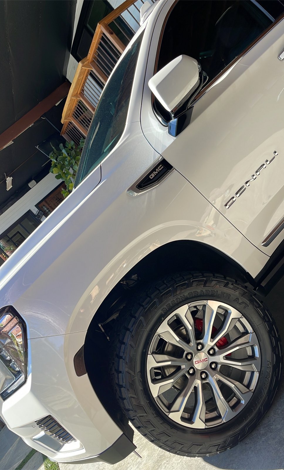

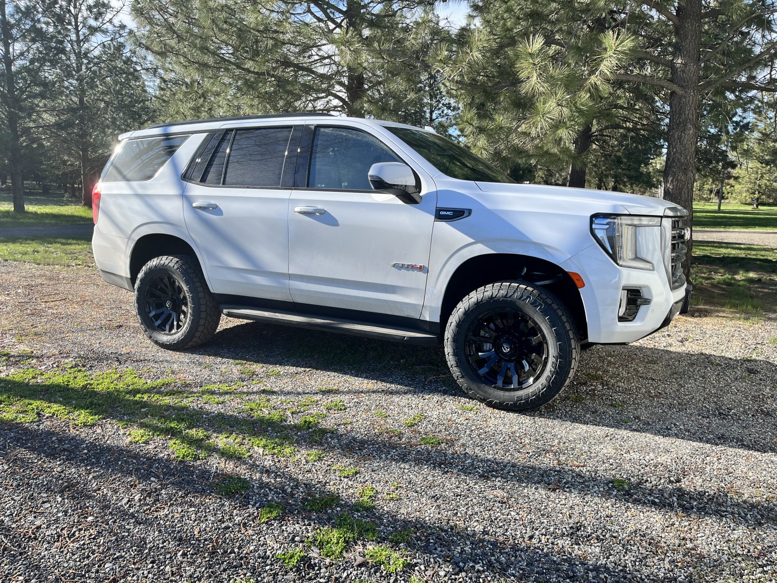

Thanks for everyone’s help on here. Just thought I add a bit more detail into the installation with a clean OEM look and maximum tire height.
With 2 weeks since install. No issues, no rubbing and drives completely stock if not better.
Pictures are in park. Once on drive. Lifts another inch.

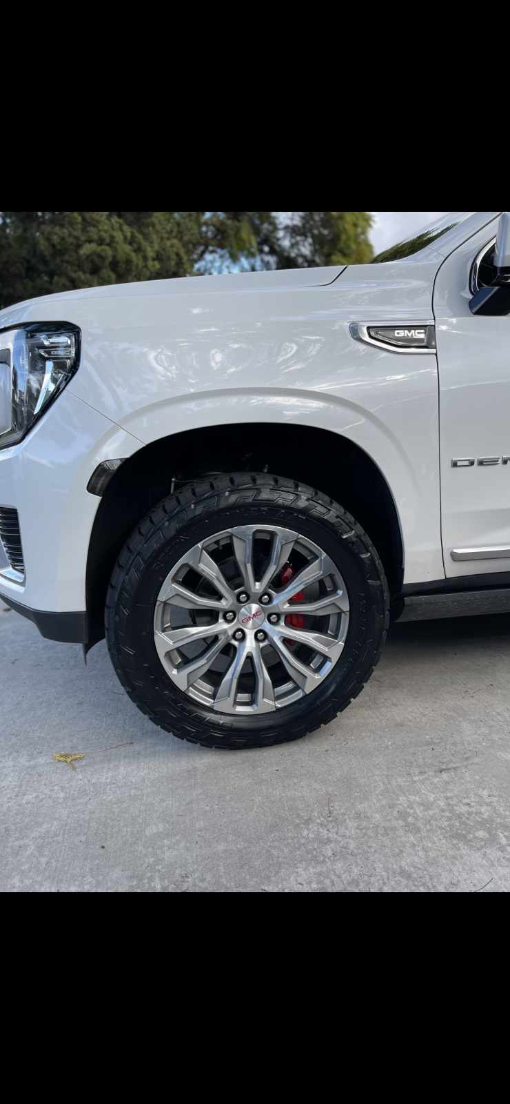

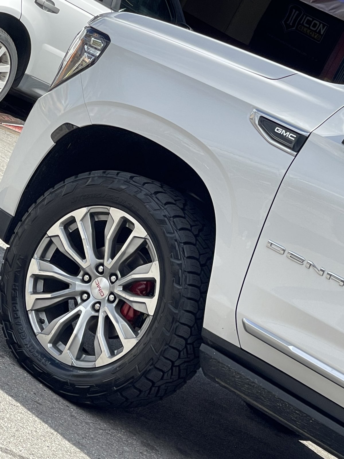

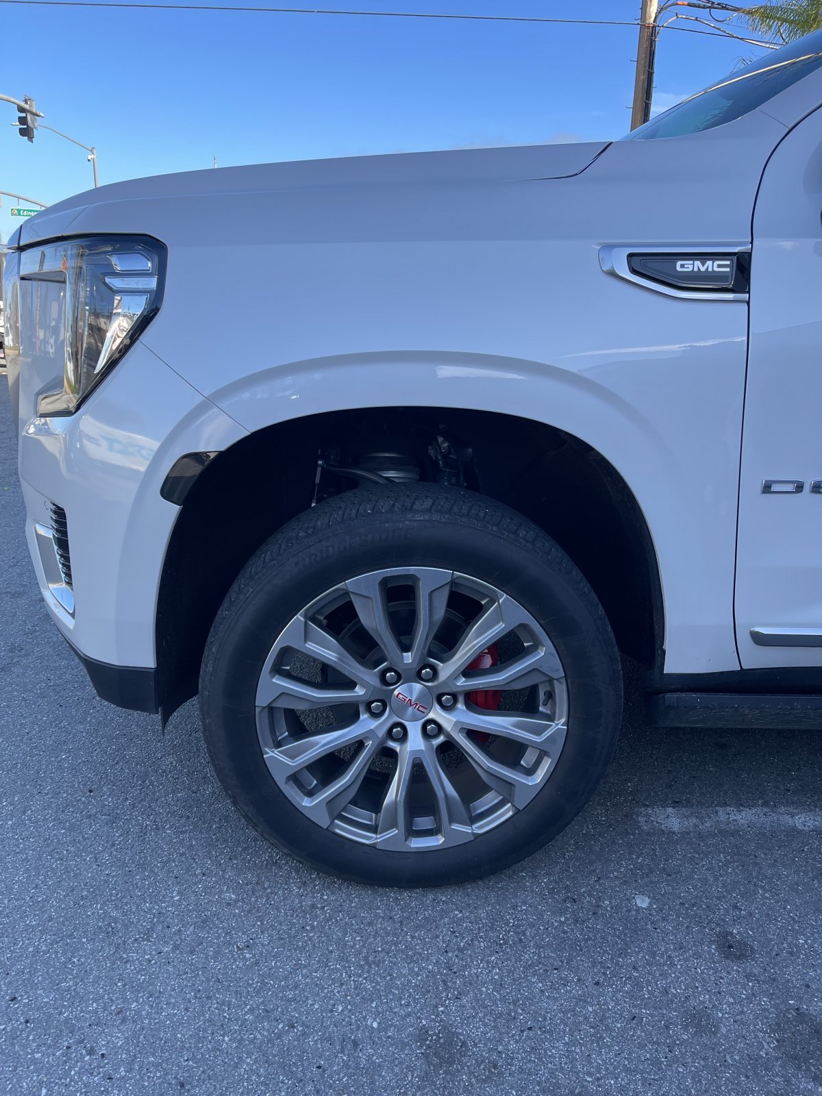

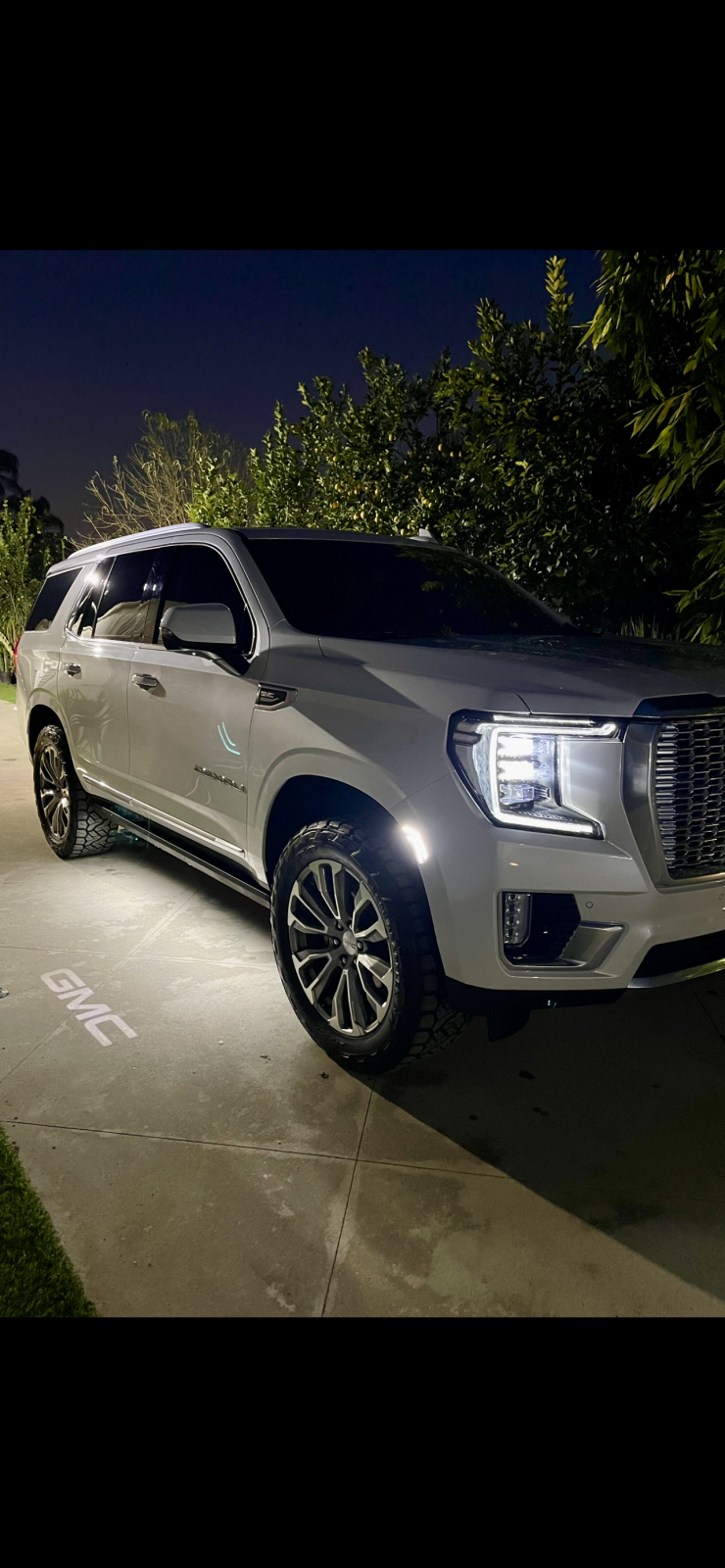

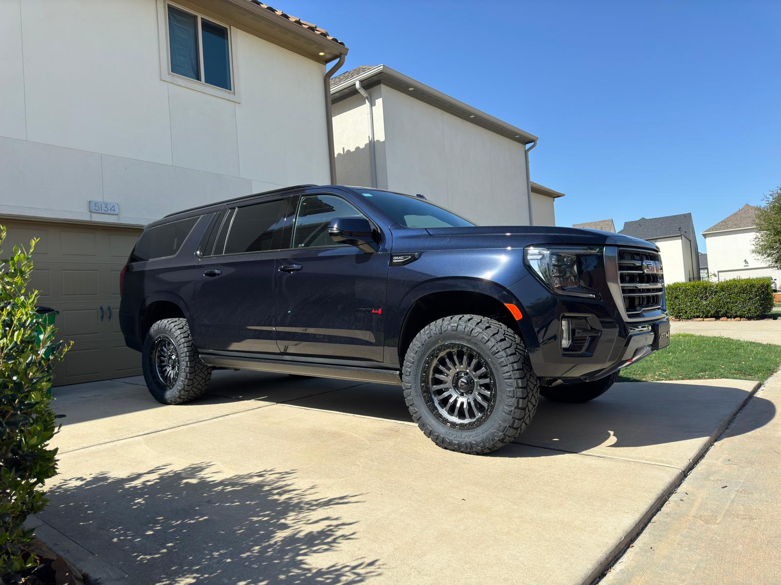

2021 GMC Yukon Denali air suspension
2” link lift front/ 1”rear from edgymods
Tires 285/55r22 (34.37x11.69)
Nitto Recon Grappler
OEM wheels +28 no UCA rubbing
No rubbing
Front tire clearance of about .25-.375”
With pullback over an inch clearance.
Minor trimming of plastic
Pullback from Wescott designs
Stock measurement front 36.5” rear 37”
Links installed front 38.5 rear 38”
With new tires 39.375 front 38.875
Truck on&running air lifts 41 front 39.5 rear
I have entry/exit turned off. View attachment 422818View attachment 422819View attachment 422820View attachment 422821View attachment 422822

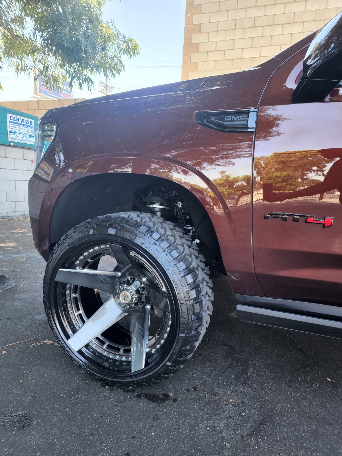

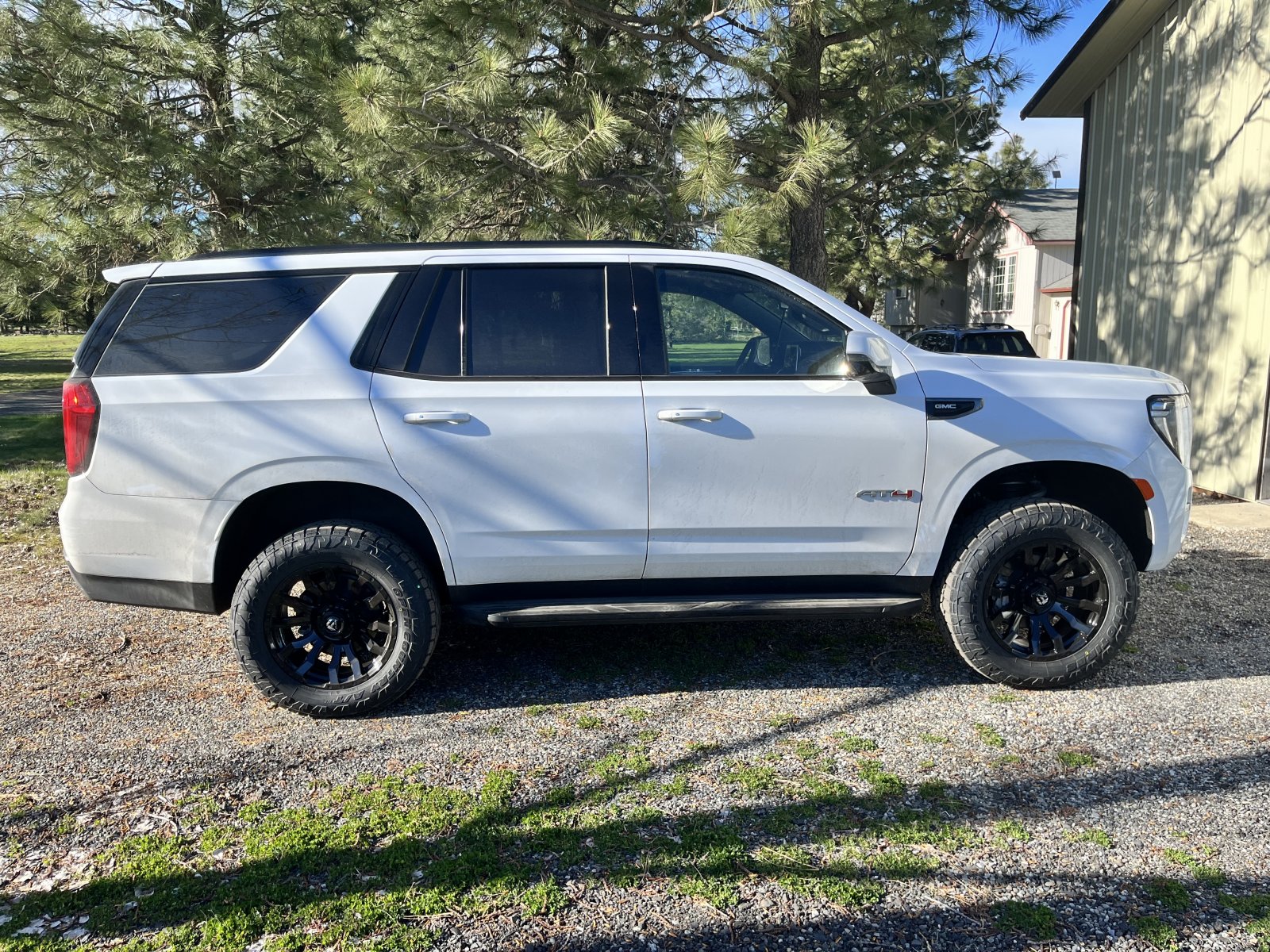

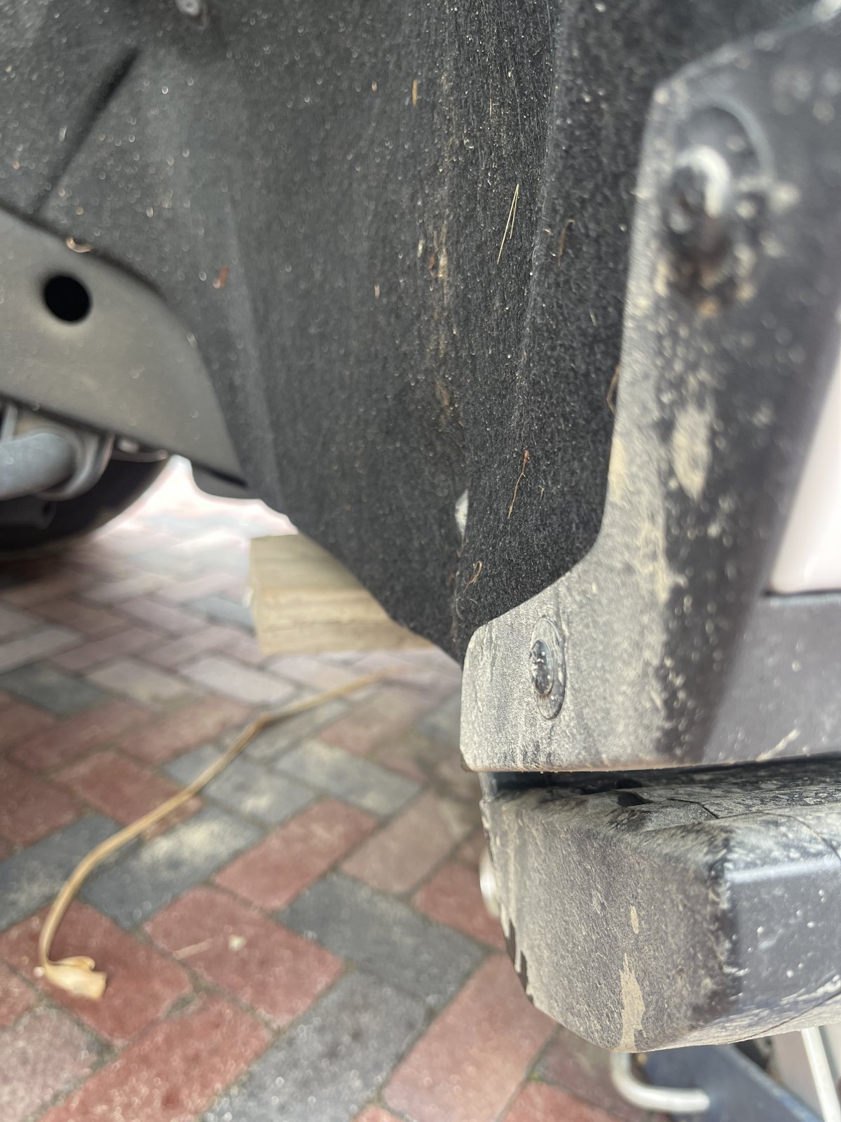

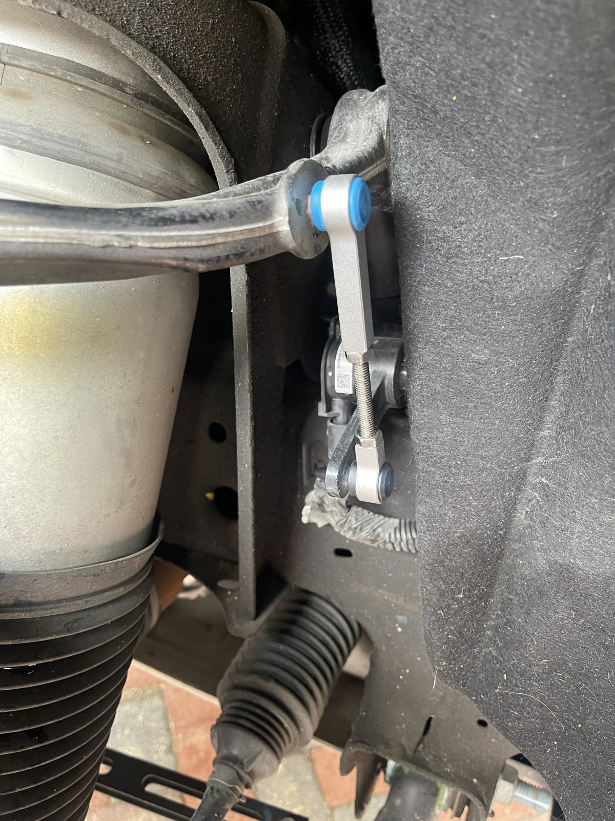

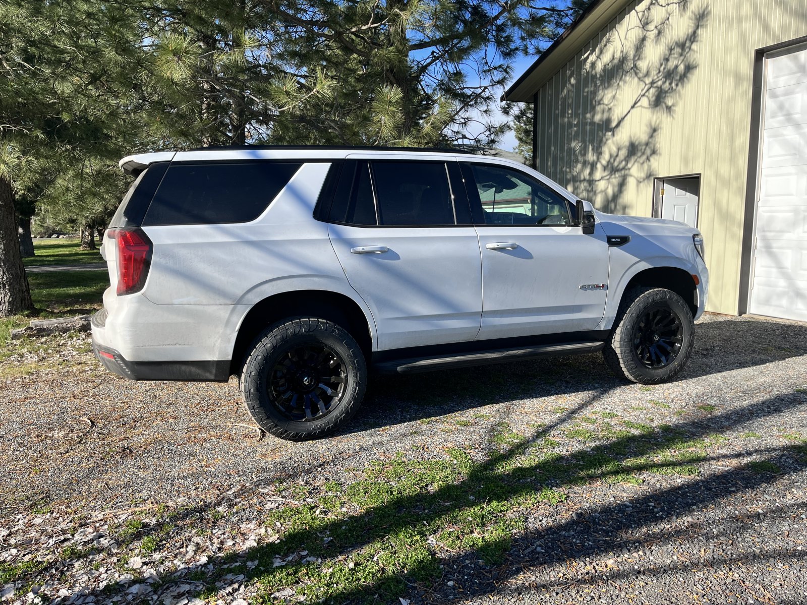

Installed Rough Country 2.5" lift on my 2024 Yukon AT4 myself so learned about the pros and cons.
- Plastic strut spacers
- Plastic front spring spacer
- Steel rear spring spacer does not have centering ring for spring
- Requires bending front droop stop. Upper control arm will automatically bend the droop stop when you put it together.
- Does not come with ABS sensor bracket relocation brackets. This might be okay for street driving. However, if you go full droop and full lock right or left the spring will hit the sensors, wiring, and brackets at the OEM location. I made my own relocators.
Lift amount:
Front stock fender height = 37 1/8"; Lifted front height = 39 3/4"
Rear stock fender height = 38"; Lifted rear height = 40"
Wheels are Fuel Blitz 22x9 with +1 offset. Tires are Toyo AT3 P285/60R20, passenger rated not LT. BTW, the passenger load rating exceeds rim rating and rear axle rating. Tires are quiet, slight hum at 45 mph. Tires do rub at rear of wheel well where the bracket is at. I plan to modify the bracket.
Before mods photo added for reference.

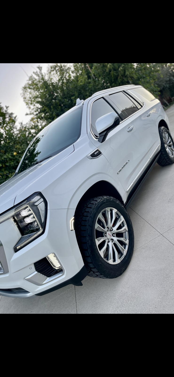

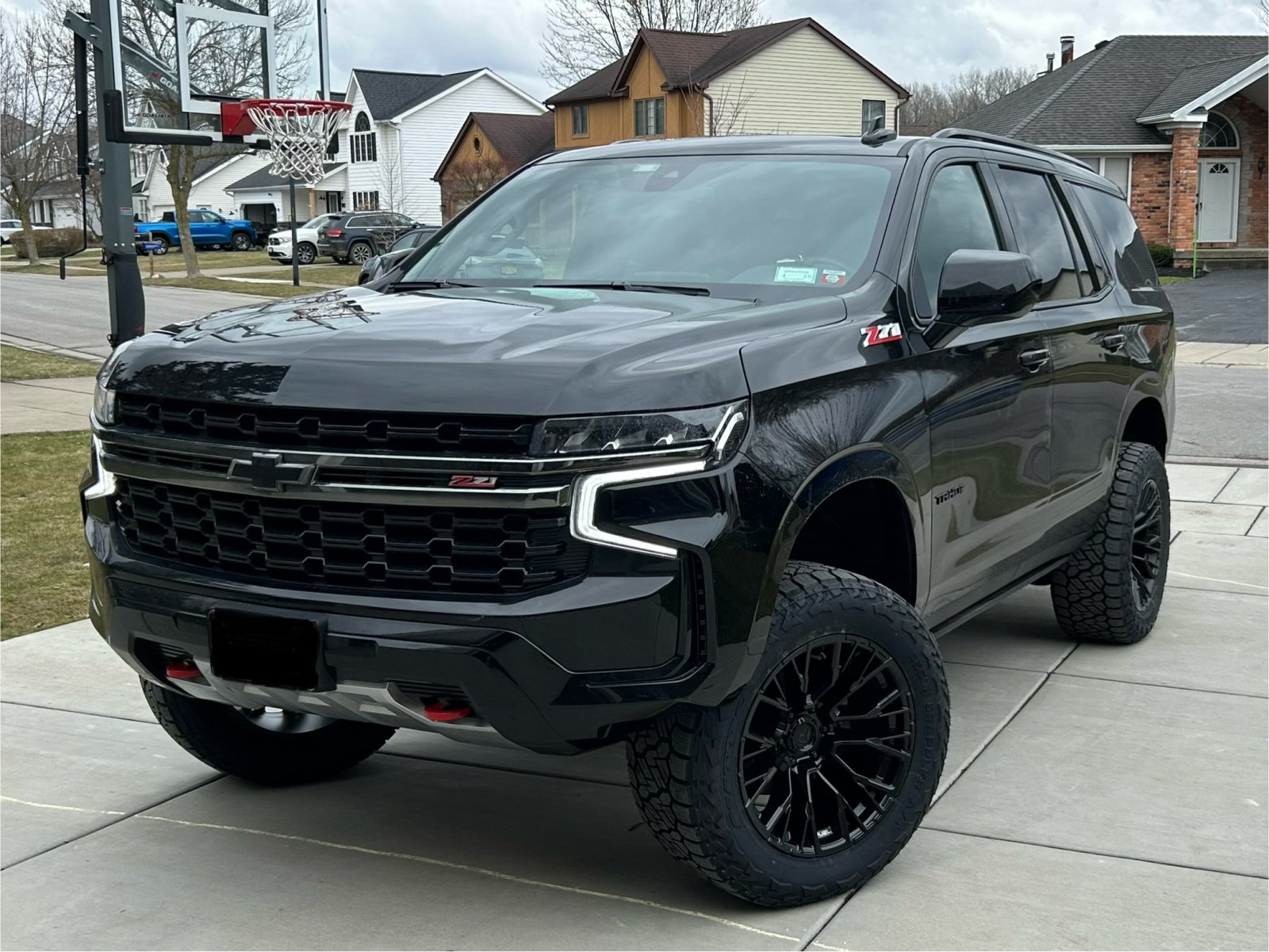

Alright. I’ve stalked this page for years and never actually posted any pics of our previous leveled vehicles. Looking back they were all white with black wheels. Not much changes I guess. Suspension maxx 2.5 front with new uca and 1.5 in the rear. Tires are 295/65/20 Toyo at2. Yes it’s tight, yes it required trimming and some more to be done this weekend. The grocery getter will definitely be set apart now.
