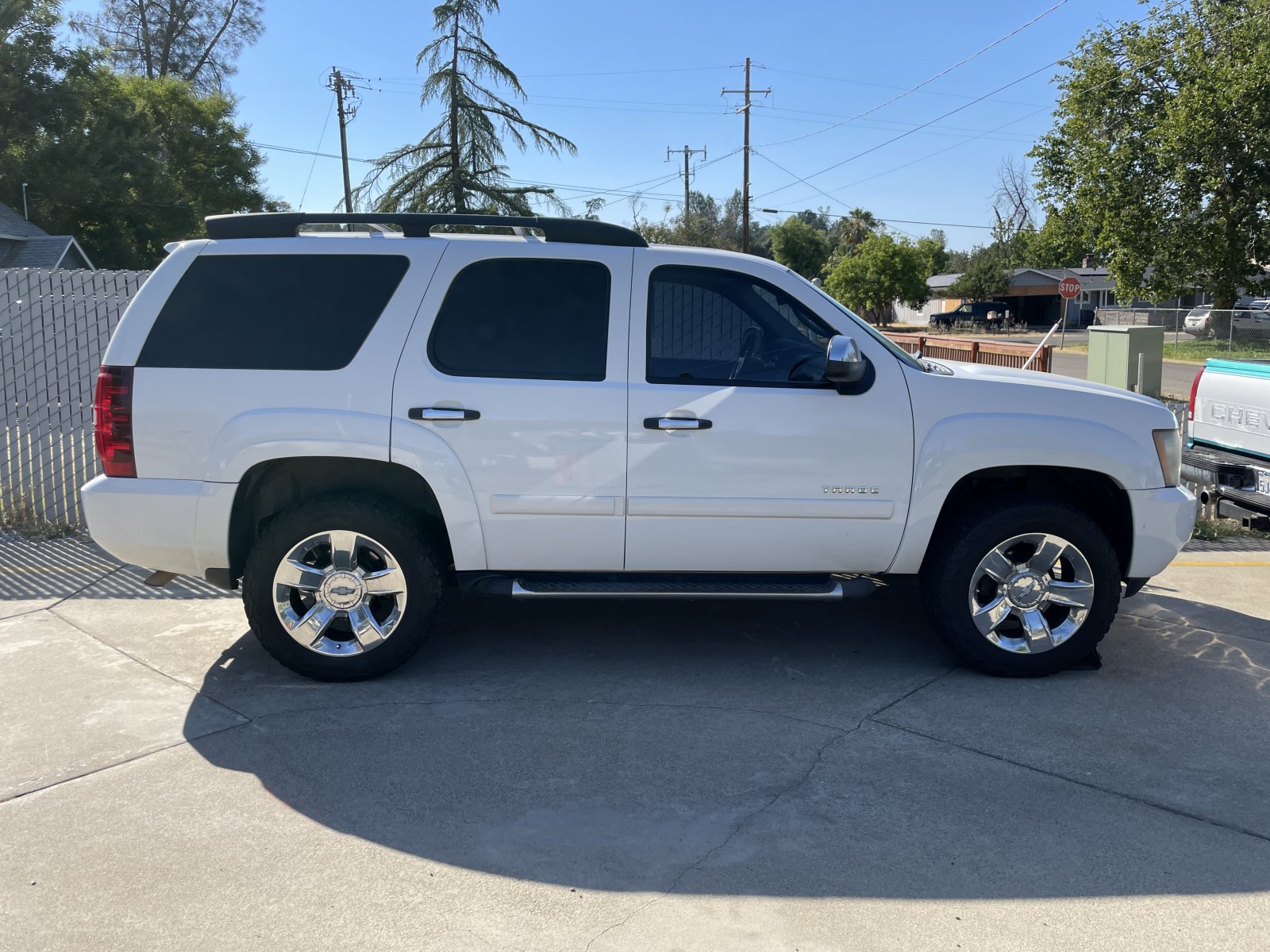

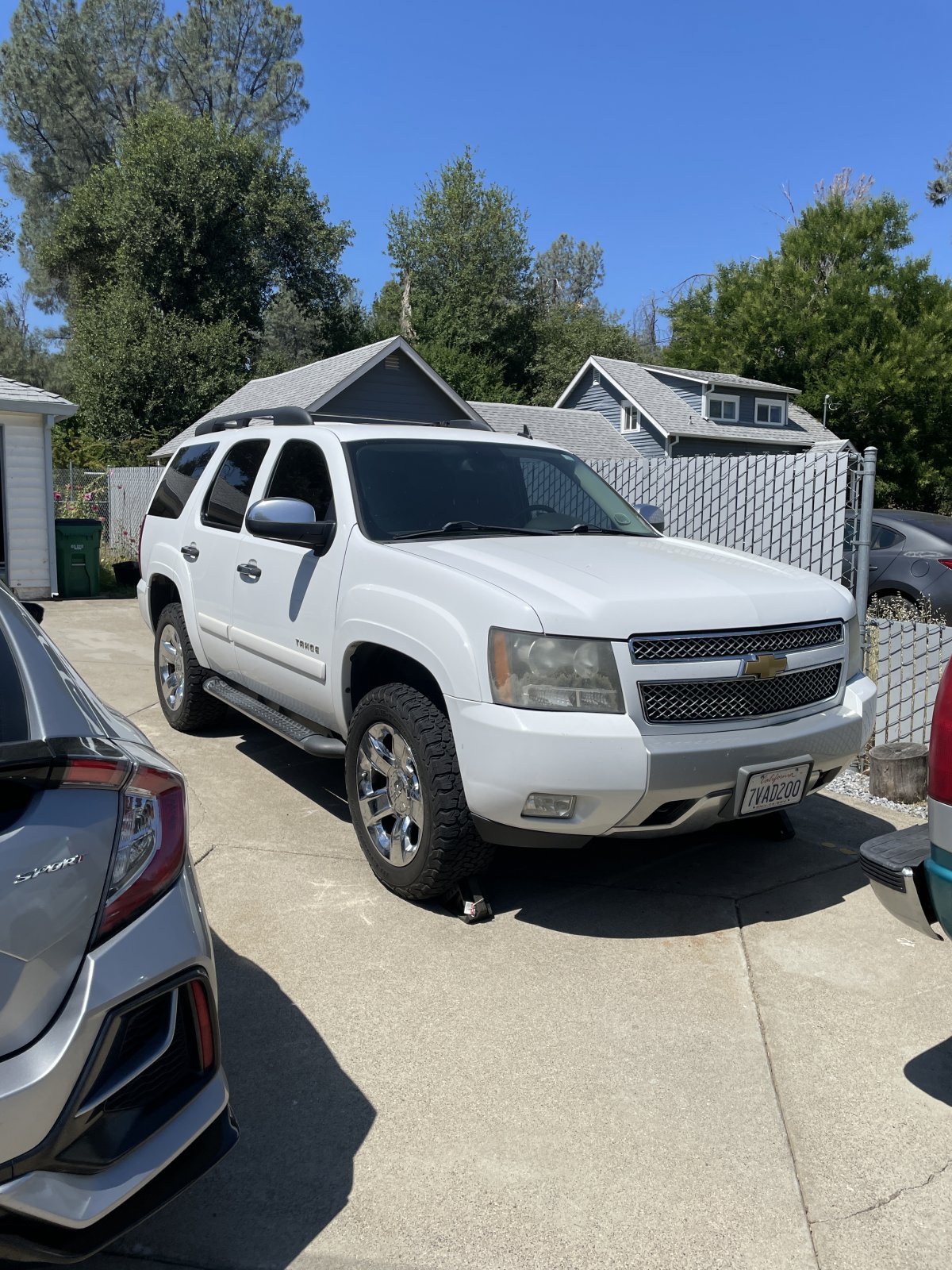

It was nice knowing all the good people here but I regret to inform you that I have unlifted my Tahoe.
My setup, while great, wasn’t perfect and with the ball joints in my Rough Country forged upper control arms going out I decided to take this opportunity to remove the lift. I ended up going with some Mevotech TTX control arms the green ones.
The change in front included removing the front 2.5 inch over strut spacer, swapping in the Mevotech control arms, and removing my CV axles since it seems the front diff has developed a problem.
In the rear I removed the 2.5 inch lift block under my springs, removed the rough country shock extension bracket, and swapping factory length rear sway bar end links back in.
I also removed my 1.5 or 1.75 inch wheels spacers on all 4 corners so she lost some of her wide stance look as well.
I am happy that she still looks great at this height and I am looking forward to a slightly more comfortable ride and a suspension that isn’t fighting itself like it was before, the 2.5 inch spacer was too much for the rough country arms to handle and the upper ball joint was binding at full extension.

After is better than before. I never saw before but am not a fan of the lifted Tahoes or Yukons. All that does is add more stress to the steering/suspension/frame.

Welcome back to the world of OEM suspensions. Yes, suspension preference/beauty is in the eye of the beholder, OEM suspension design is in the eye of the Design Engineer.

Looks a wee lil bit taller than OE, like it'd still be too tall for many NYC parking garages.
Looks right nice, to me, anyway.
@Marky Dissod I have Moog 81244 springs in the front and 81069 in the rear so it is still probably a bit taller than the average Tahoe but from the angles of the suspension now it looks a lot more comfortable within factory geometry, hopefully it rides a little nicer now.

@Actifenpleinair I think so, it is now lower to the ground the wheels are closer to the body. I suspect I picked up at least 1mpg since I removed the lift and wheel spacers.
