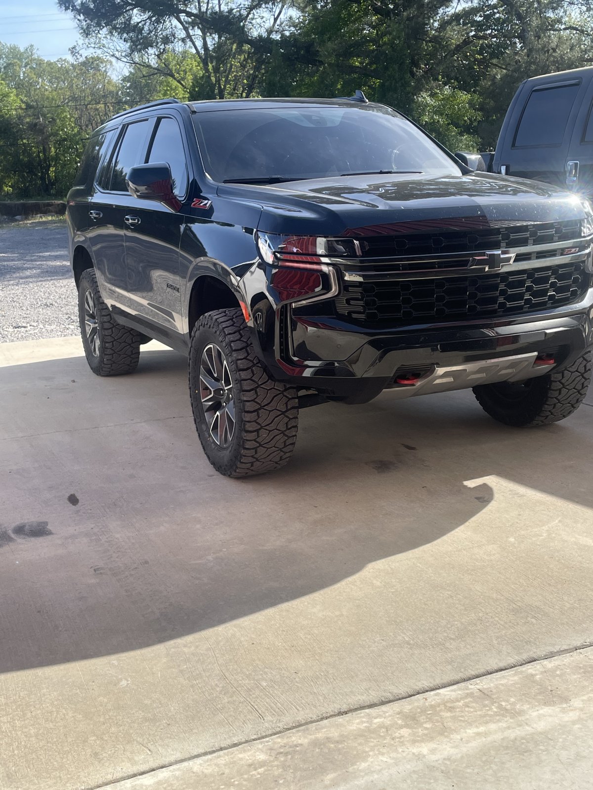

What’s the offset on those?? That’s a good looking Yukon. What’s kind of rubbing and trimming did you need to do?
The offset on my 24x14's are -76. I knew what I was getting into a couple of years ago before I even ordered these wheels. I just didn't like the "flush" look on current gen Yukon/Tahoes, and wanted to do something different. I did have to cut away some of the wheel well closer to the bottom, but otherwise, it turns just fine.
The only thing I'm waiting for now is for my current tread to wear down so I can upgrade my tires to 35's. I should have done it the first time around, but I found myself listening to too many haters and decided to play it safe by getting 33's.

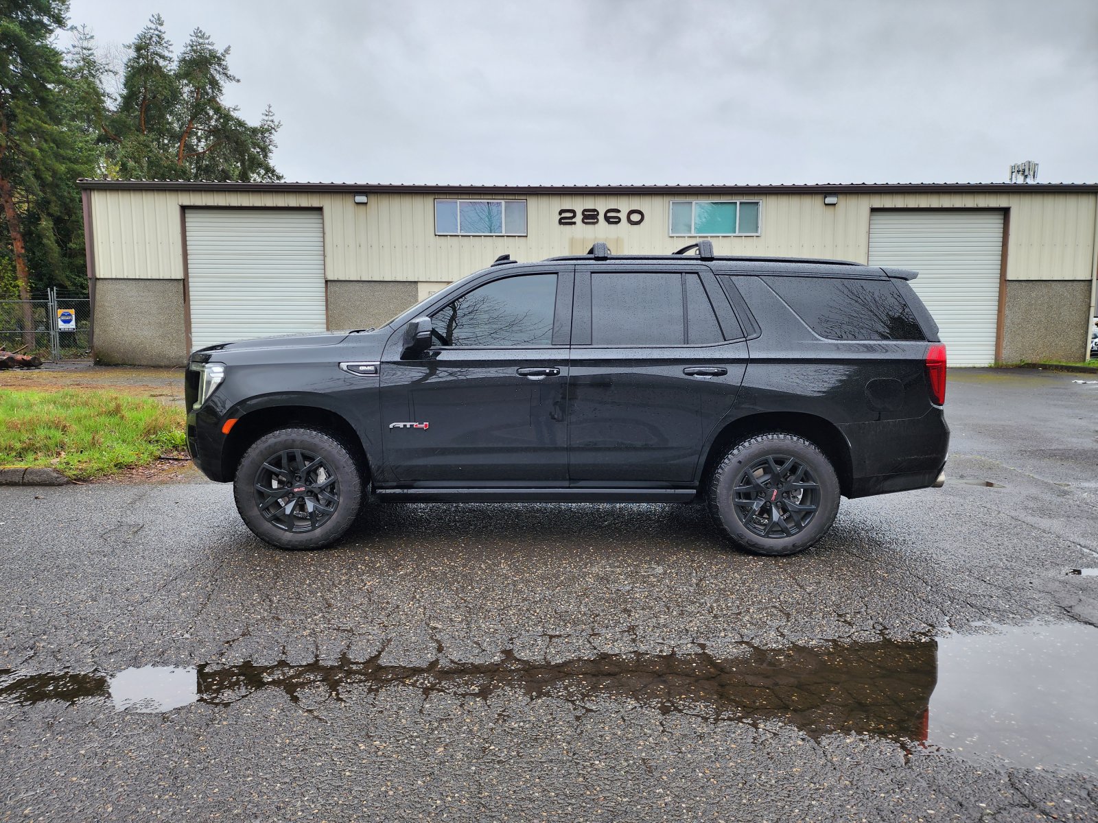

I'm not sure the specifics of your ride (I have a 22 Yukon AT4 w/ Magnaride) and I missed the memo that you need the Magnaride relocation bracket. So I just ordered that and now delayed another week until that arrives.
Just wanted to give a heads up to you and anyone who might be considering this.
No you dont. At least not with my wifes ‘22 high country.
Post pics of the bracket…links…or whatever it is. I couldnt even find it when i installed the kit on hers.
To update this, Went to install my Motofab 1" level lift on my 22 and confirmed I did NOT need the bracket that Motofab said I did.
But do love the 1". Leveled my AT4 perfectly.

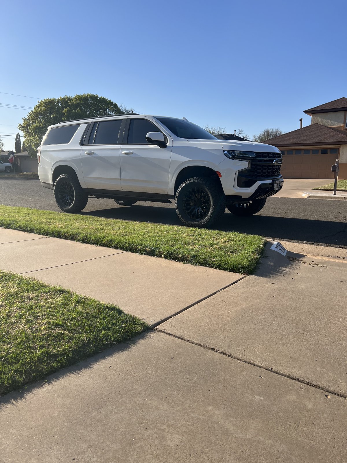

So I finally got my RC 3.5” lift on yesterday afternoon with 35x12.5 Venom RT tires (I know I will get push back for these but I got them at a steal) and Bora 1.5” spacers on front (they only had 2 in stock yesterday) the rear spacers will be sent to my house next week and I will put them on then. Here’s one photo. I will get more this weekend.
Hunter Linn
Nov 3, 2019
24
11
Tuscaloosa, Alabama
It does sit level but the photo was taken on a slanted parking spot

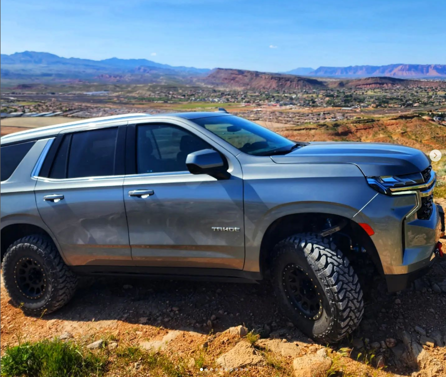

I ended up going #kingshocks, 285/75-17 #toyotmt #methodracewheels #mazzulaoffoad UCA's #amppowerboards I need to re-valve the kings for rutted fire roads. I will try front 10/10-Flutter-17/17 and rear 10/10-Flutter-15/15 I did have to do some triming for the front. Once I can afford to do LT right I will see what #lsk has to offer.
d_hawk
Jun 24, 2021
54
62
A little off topic from shock valving…. I notice you have added an aftermarket recovery point to the front of your Tahoe. Could you post some closeup pictures, manufacturer and part number for the shackle setup and any installation notes you might have?
I have a high country suburban (same non Z71 bumper setup as you) and have wanted to add a front recovery point, the Z71 recovery hooks bolt up but don’t have bumper clearance to be useful.
