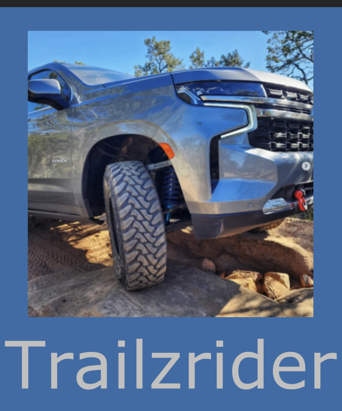

His isnt a z71? Fooled me for a second!
If you zoom in on trailzrider’s profile picture you can see the non Z71 front bumper and what looks like a rough country shackle setup for what I assume is a GM 1500 pickup truck.

A little off topic from shock valving…. I notice you have added an aftermarket recovery point to the front of your Tahoe. Could you post some closeup pictures, manufacturer and part number for the shackle setup and any installation notes you might have?
I have a high country suburban (same non Z71 bumper setup as you) and have wanted to add a front recovery point, the Z71 recovery hooks bolt up but don’t have bumper clearance to be useful.
I bought the OEM hooks and they were worthless.

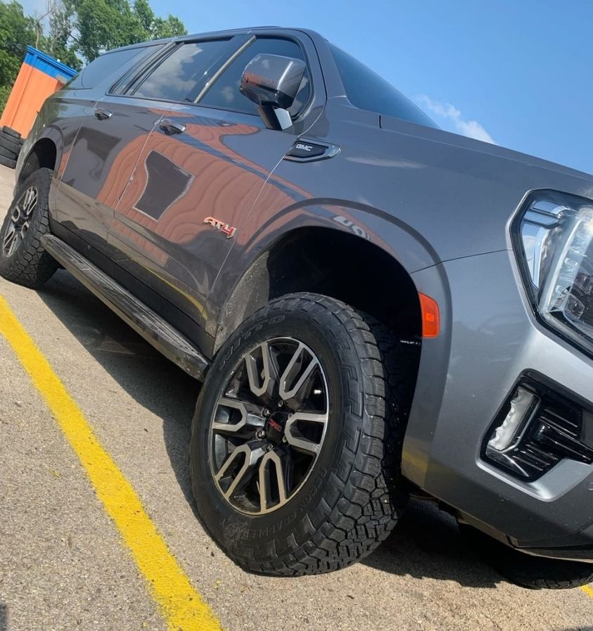

absolutely hate how my '22 AT4 turned out with the 3" leveling kit and 1.5" lift in rear turned out with the 275/65/20 Nittos. Do they not make a 1" , 1.5" or 2" leveling kit for these AT4s with magnetic ride control?

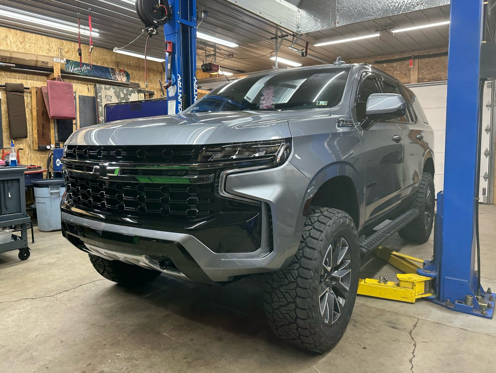

Yes standard suspension. I haven’t driven it yet, still need to trim a little more of the fender liners. Install was straight forward, and took about 5 hours. I’ll post again once I get it on the road.

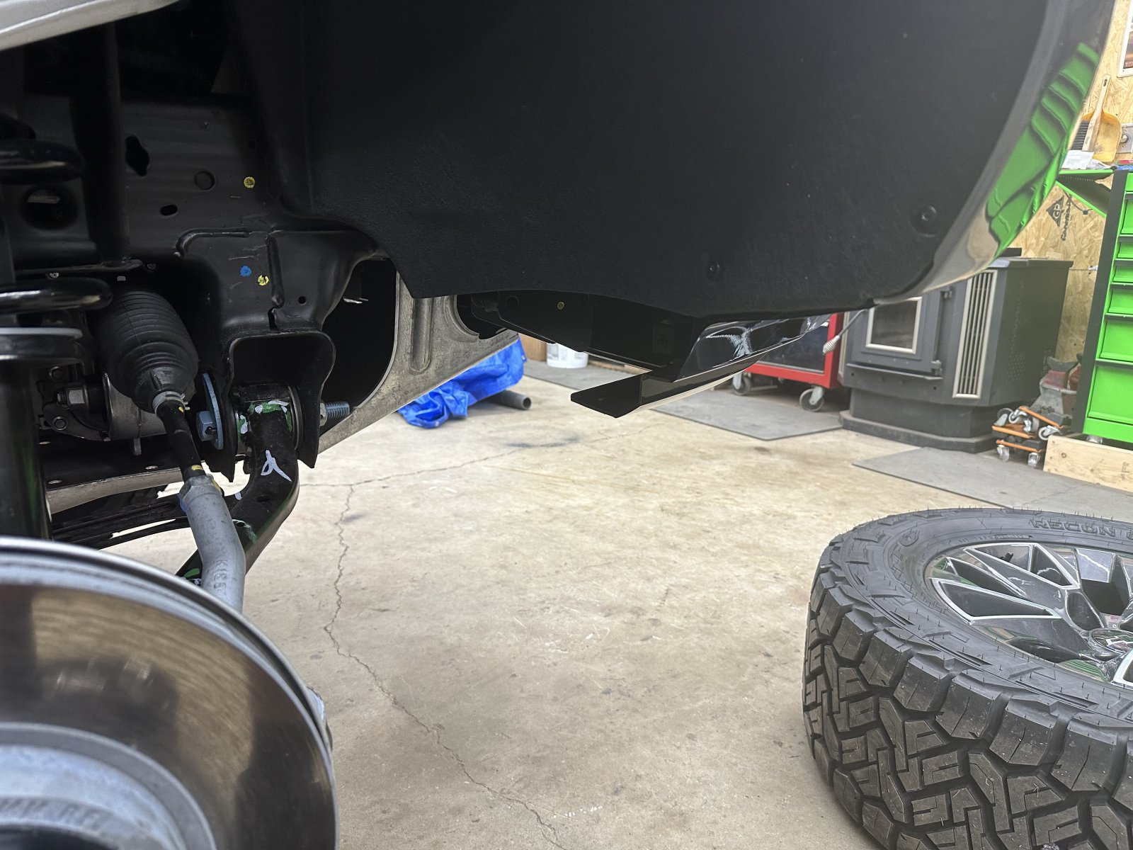

That pull back kit is interesting. So after removing the gm supplied brackets behind the fender liners you bolt those new brackets up? I achieved the same thing with a hole and a zip tie, but that’s certainly a more legit way to do it.

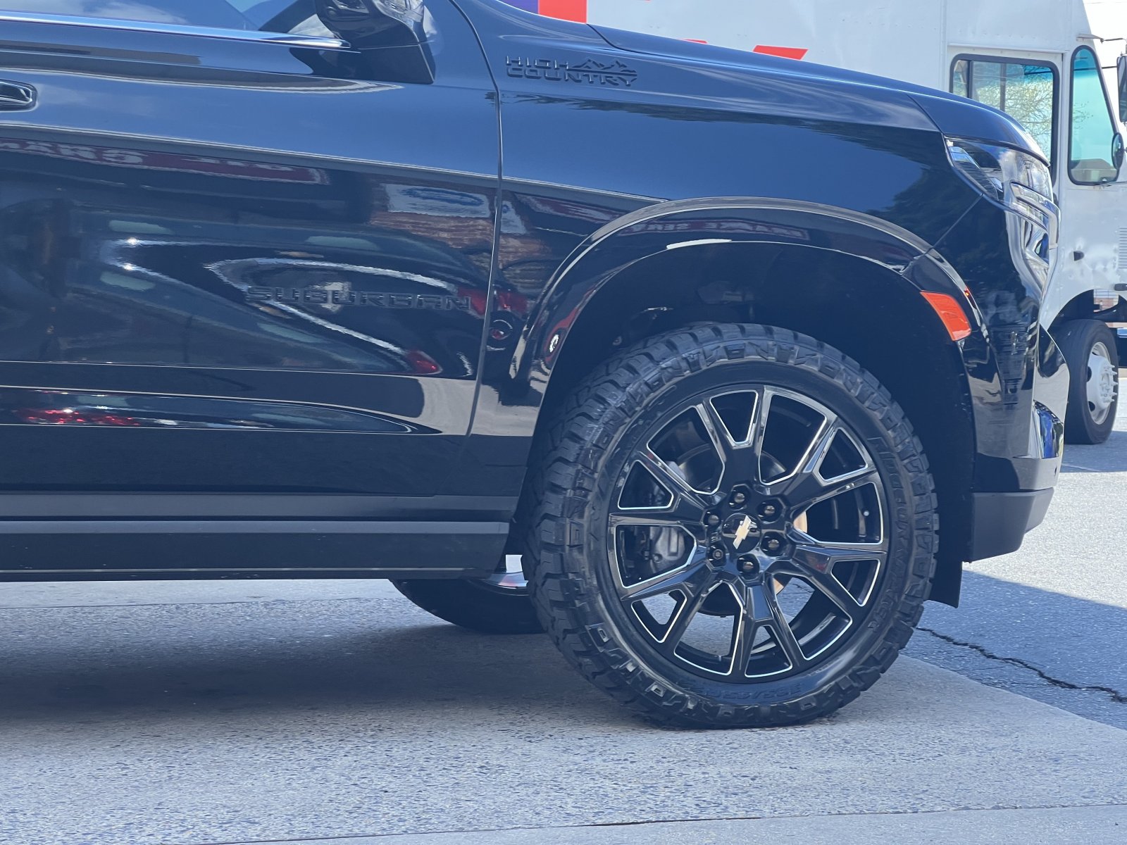

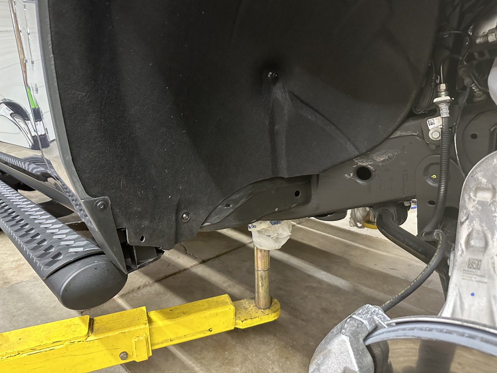

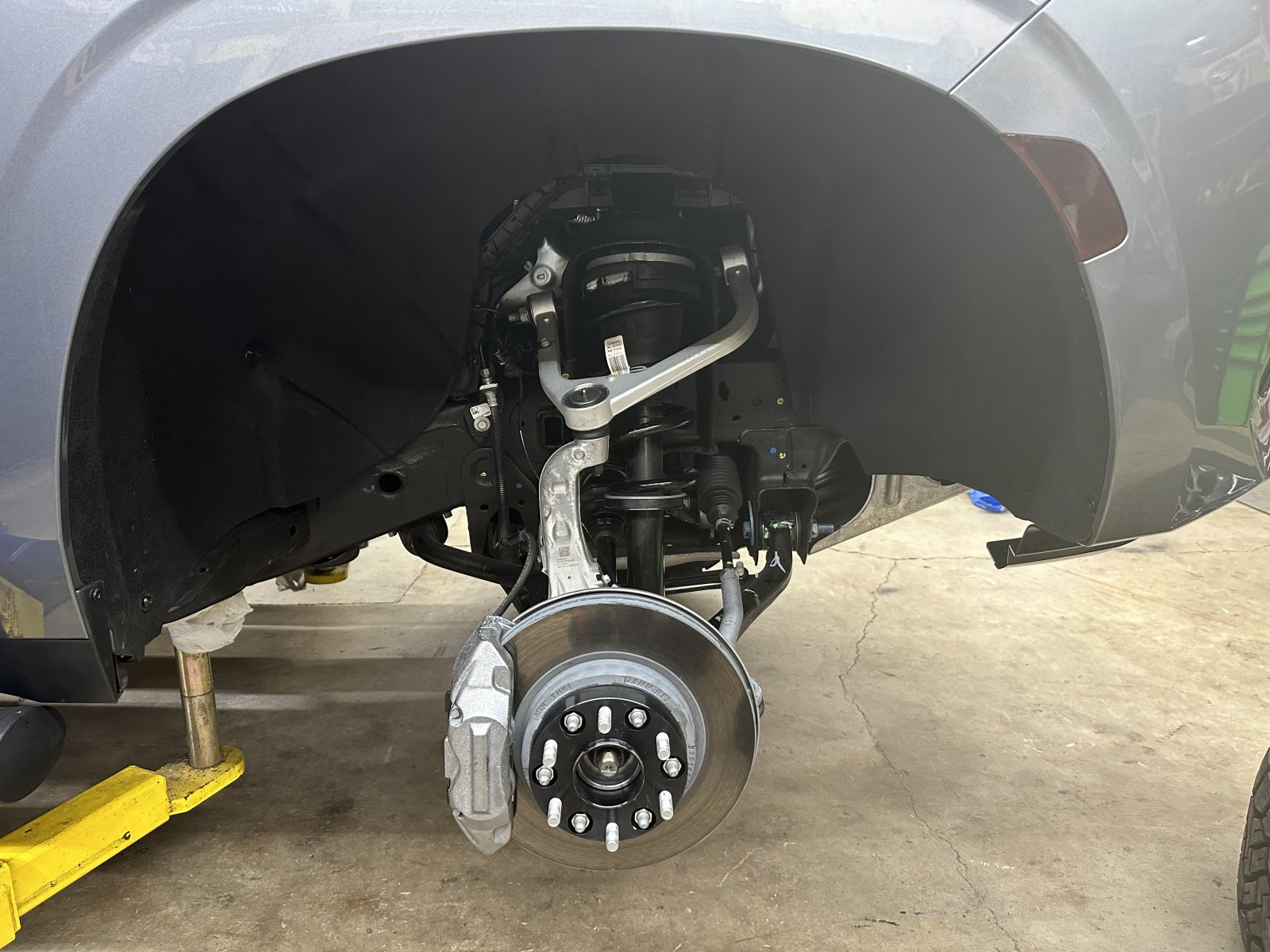

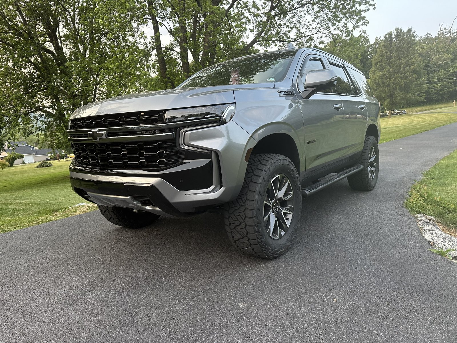

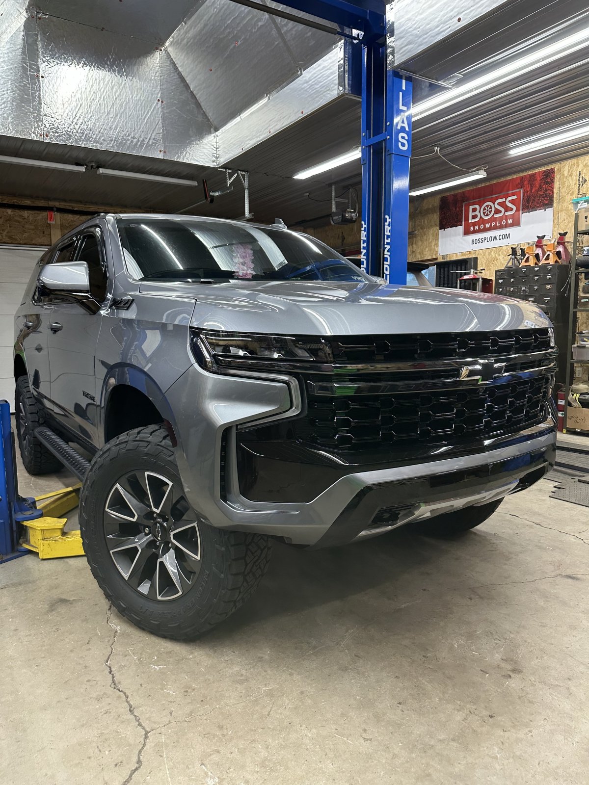

Honestly if I had it to do over I’d probably save the $$ and just go the zip tie route. As far as the ride goes, it’s just as smooth as stock and the recon grapplers are really quiet. (Don’t mind the bags on the lift pads, the undercoating GM uses on the frame is some nasty stuff)View attachment 402057View attachment 402062View attachment 402058
I ended up zip tying mine sometime last year, before those pull back kits were made. The zip tie route wasn't pretty, but it got the job done. Since I had to shave off a considerable amount of bumper behind the front fender liners, it limited my options for places I could graft the zip ties to. I'll redo them in a few months, so I can properly fit 35's, but for now, they're fine.
When I initially had my fenders shaved, the shop I went to was a little impatient and frustrated that they had to keep shaving material off the inner bumper a couple of times because it kept rubbing, so they weren't as forgiving with the aesthetic look when it was all said and done. I have a small 2x2 tab on the fender liner that was drooping, so I attempted to tuck it under. Instead, it gets caught on the tire lug when I turn left, and it flaps. It's an easy fix though....
Oh, and for those that ended up having to replace your two front felt fender liners for whatever reason, you're looking at around $75 from GM.

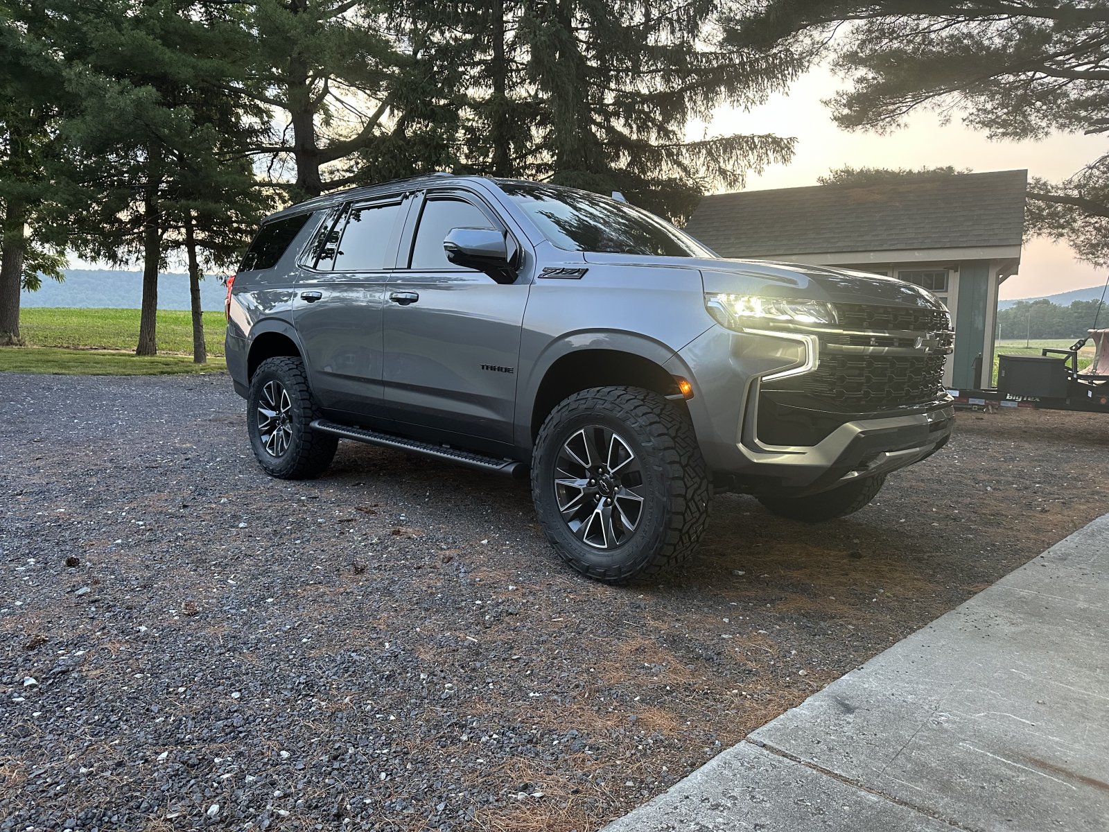

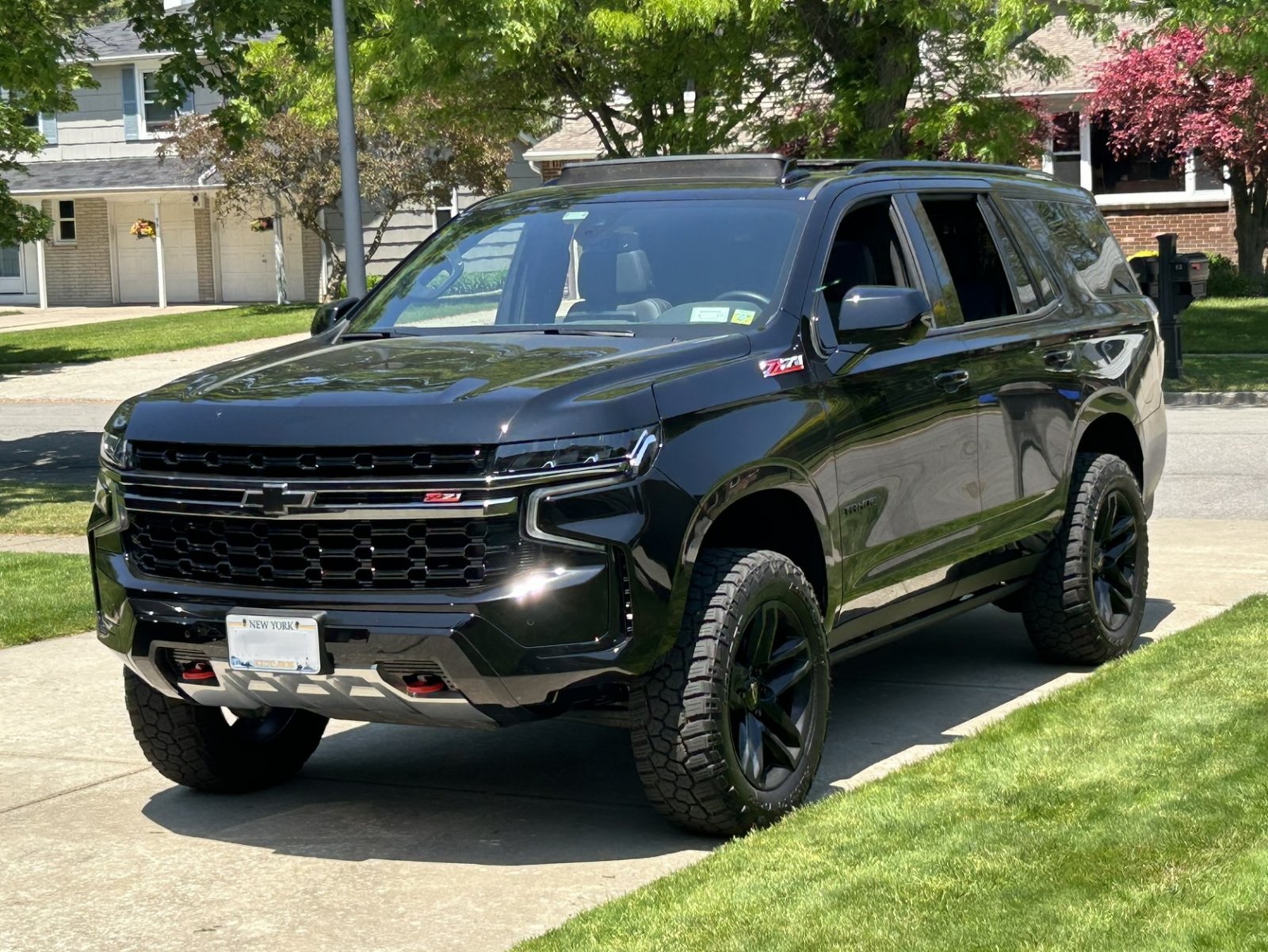

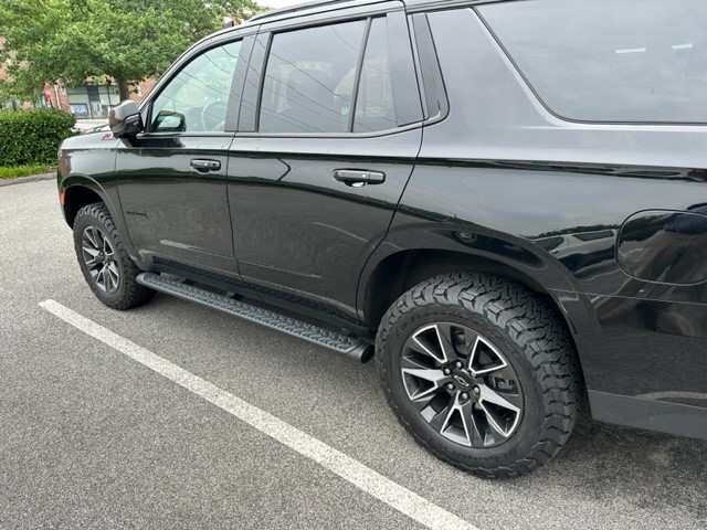

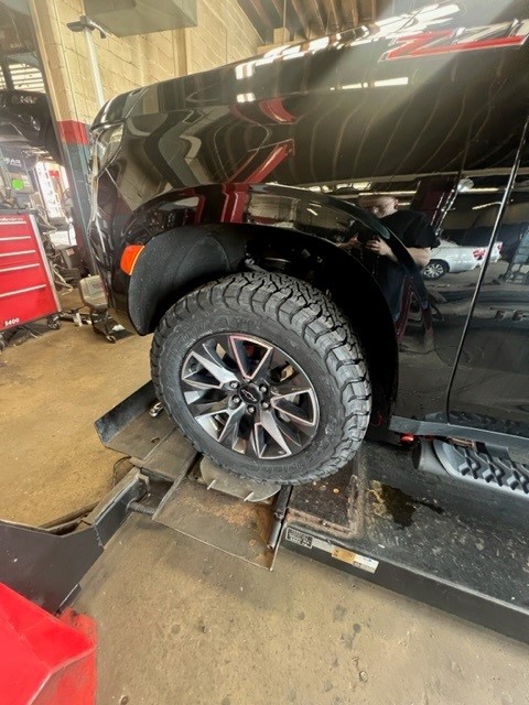

Just leveled my 21 Tahoe Z71, 2 in front, had to add 1 in the back. Mounted new KO3 ATs on Z71 20" Rims. Very happy with the look and more importantly the ride, which changed minimally (for once)...
