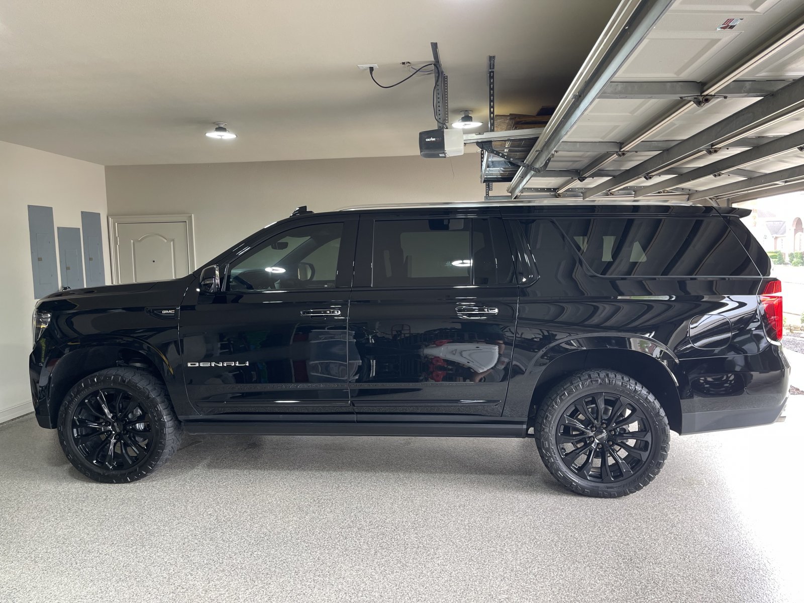

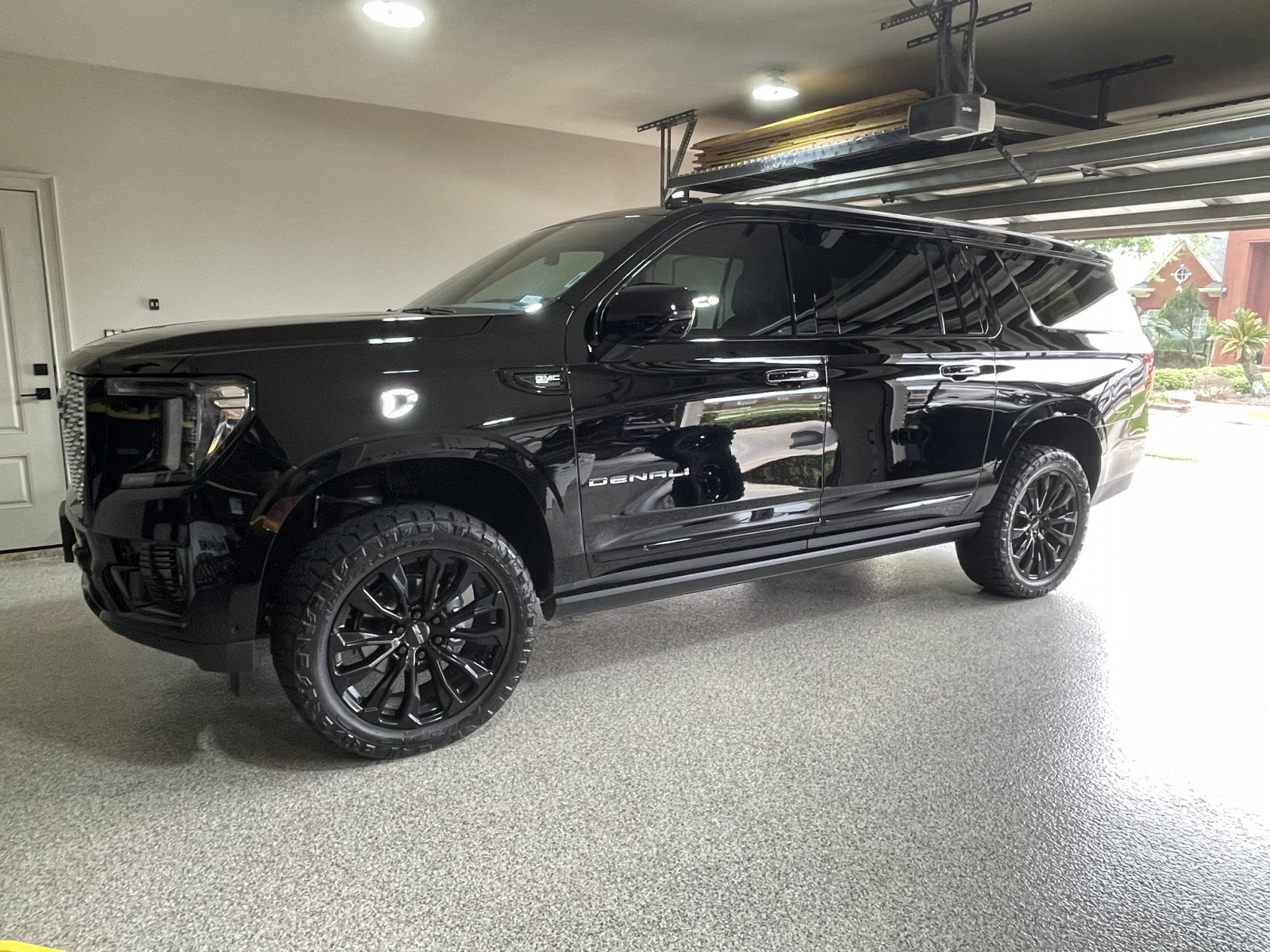

Dropped off today for AMP. 3.5” RC.
20x9 +1mm Fuel Quake
35x12.5x20 BFG KO2
Painting Skid plate and tow rings Black and debadging as well.
Will post pics this next week when I pick up!
