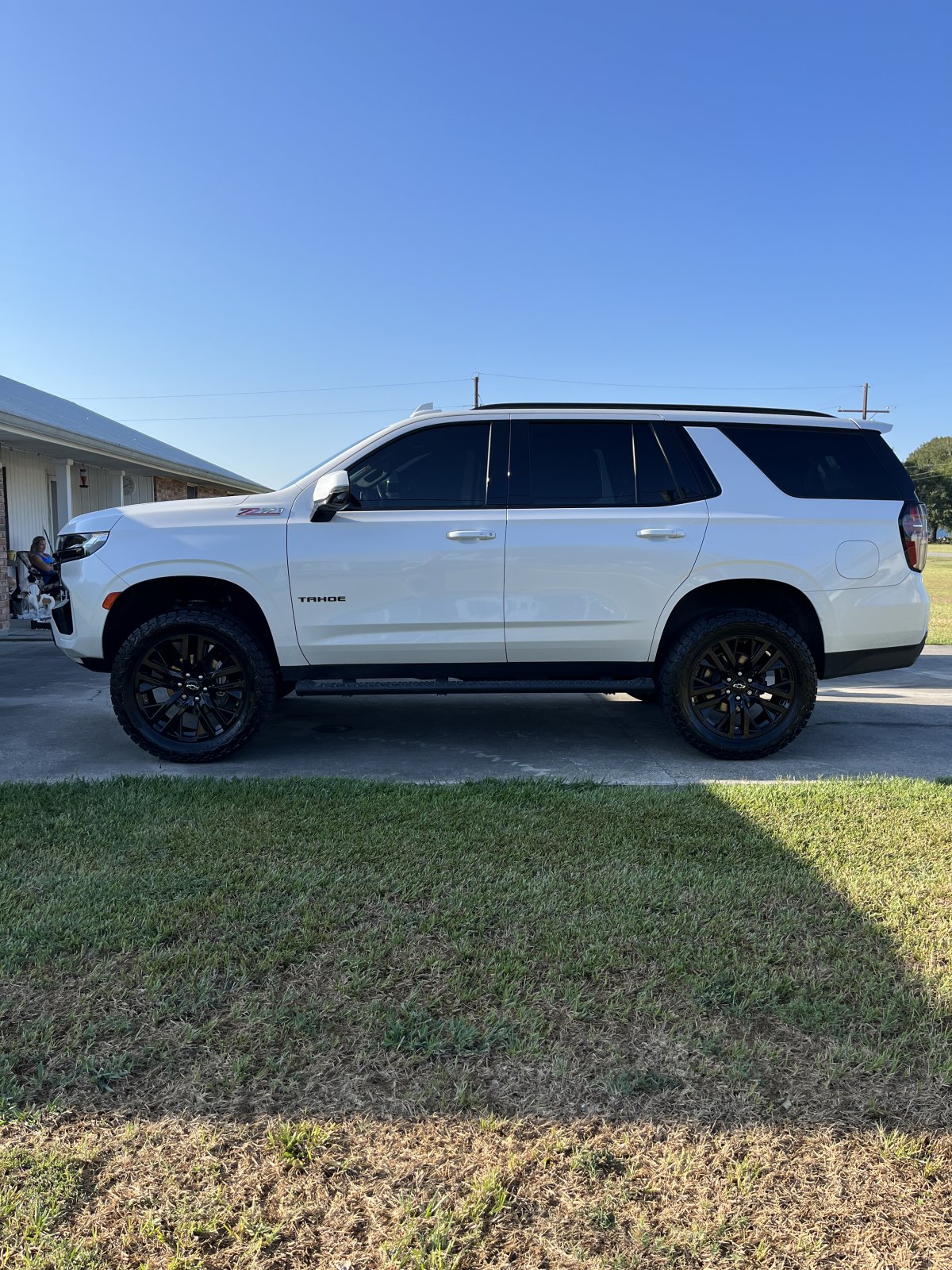

-Tires35x12.50r22 Nitto Recon Grapplers
-Wheels: Vossen HF61 22x9.5 offset 20 Anthracite
-Lift: OEM air suspension,
Front/Rear bag links swap mod
-Exhaust: Corsa cat back system

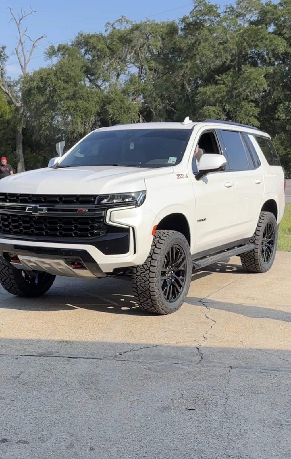

- 3 inch SST readylift
- Fuel heater 20x9 +1 offset
- Stock Wrangler AT's 275/60/20
Will run ridge grapplers or AT3's in one size up once these wear out.
Even without going up in tire size, the offset change from stock wheels is causing a slight rub on the bottom front liner and plastic at full lock in reverse on any elevation change. Surprising given the 3 inch lift, but there's not a lot of room in these fenders. Going to trim it slightly. Anyone relocate the two plastic mounting points behind the front liner on the bottom and relocate where the liner screws in? I have the wescott pullback for the back but it's not needed right now, and I didnt see where to mount it on the front but maybe I missed that?
Overall height seems to be barely under 6'7". Ride quality is 99% unchanged on this lift, slight stiffness increase in the rear end which was expected. But safe to say it "retains stock ride".

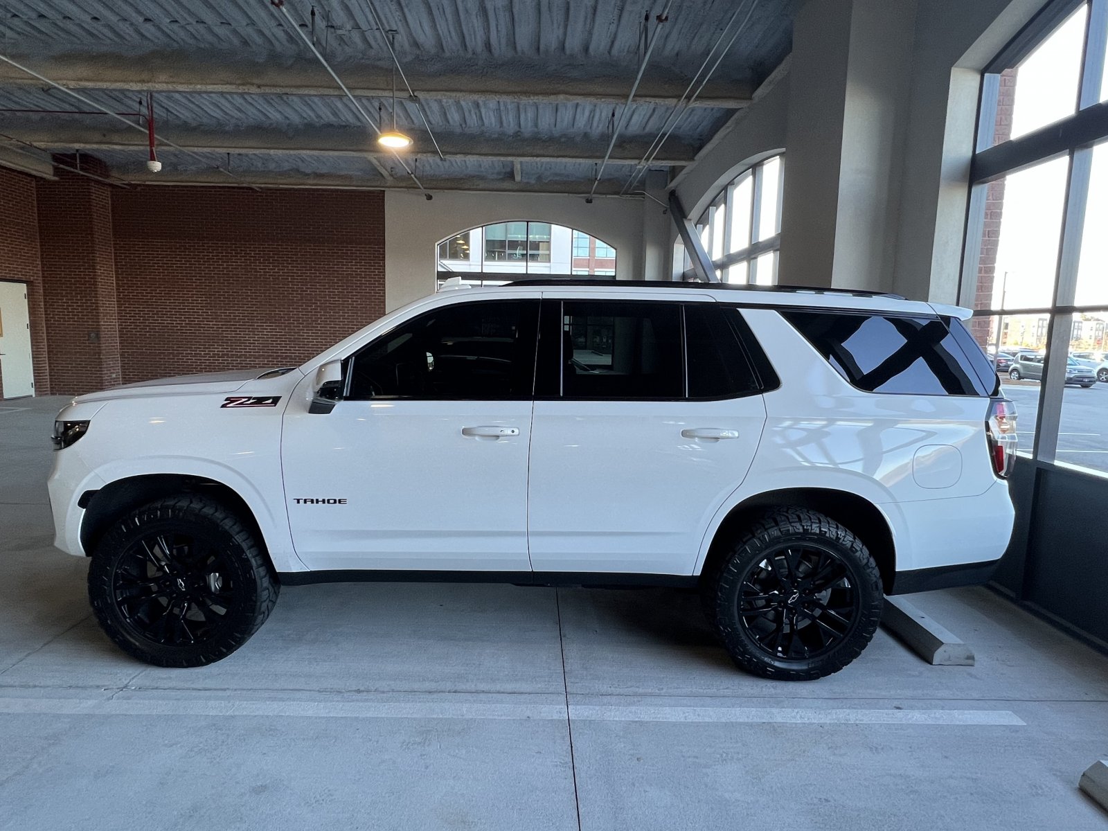

Honestly if I had it to do over I’d probably save the $$ and just go the zip tie route. As far as the ride goes, it’s just as smooth as stock and the recon grapplers are really quiet. (Don’t mind the bags on the lift pads, the undercoating GM uses on the frame is some nasty stuff)View attachment 402057View attachment 402062View attachment 402058View attachment 402060View attachment 402061
Oh my god, how clean. It seems that the car was just bought and did not go on the roads)))

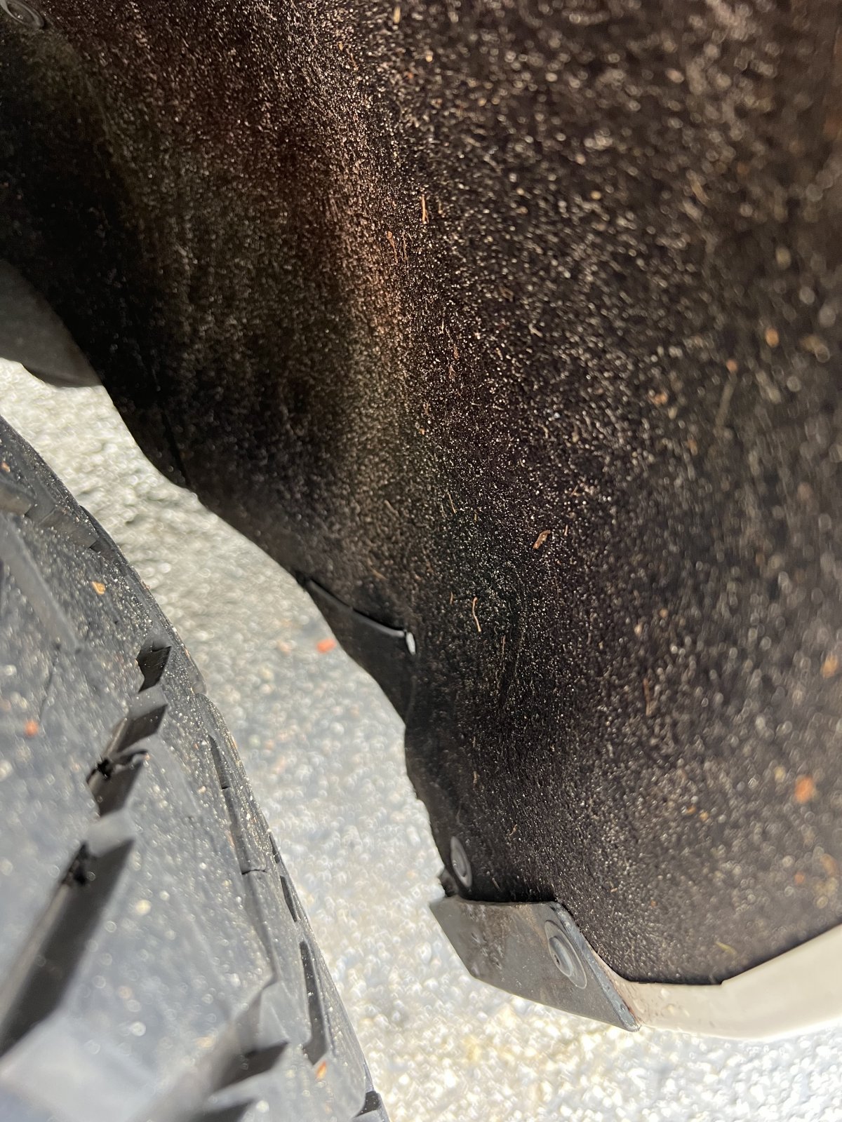

Im having issues with my 21 Z71. It’s identical to yours with same tires and same rims. I put the 3.5 RC lift and to fit the 285/55R22 i had to go with a 1-1/4” spacer because the RC control arms hit the tires. This cause serious rubbing. I’m thinking of going down to the 2” to do away with the RC arms and would also do away with 1-1/4” spacers. My guy installing says the rubbing will be too bad and we need to go down to a 285/50R22. How bad is your rubbing with the 285/55? I really do not want the 285/50.

@DWSmoot You had less rubbing with 2” lift and no spacers? What made u put spacers? I’m thinking about going down to 2” lift to keep factory control arms and removing spacers. My guy installing thinks that will make the rubbing worse.

You had less rubbing with 2” lift and no spacers? What made u put spacers? I’m thinking about going down to 2” lift to keep factory struts and removing spacers. My guy installing thinks that will make the rubbing worse.
Probably not the struts, it’s the upper control arms that are hitting your wheels without the spacers. I’m running 2” RC, 1.25” spacers, stock size tires and had to remove the brackets behind the fender liners and do a little trimming. Did you remove the brackets?
That’s correct- Control Arms not struts- my bad. Yes, we removed brackets and pushed the felt back. No felt trimming though. I wonder what part of the felt that Westcott pullback kit pulls. I will look to see where the major rubbing was. I have the vehicle with factories back on them now. I might just put the 285/55r22 on and drive for a while and just constantly trim. I dont think I will be happy with 285/50r22 with a 3.5” lift.

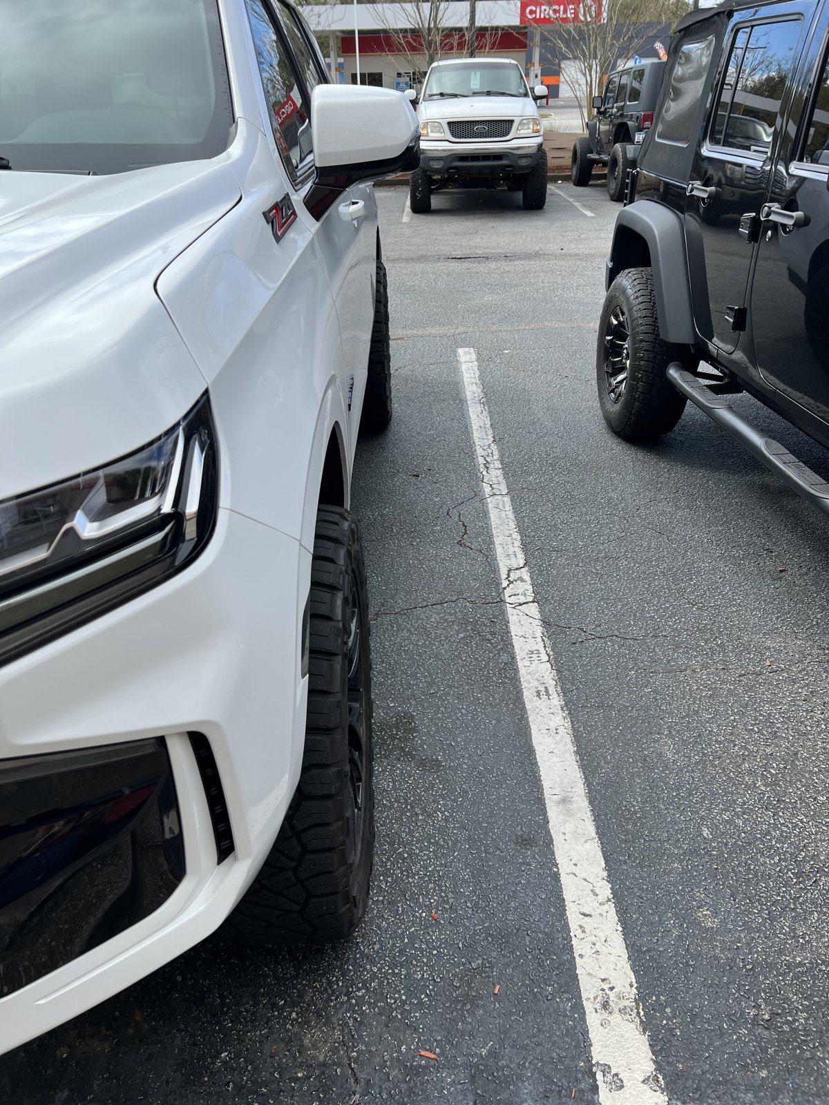

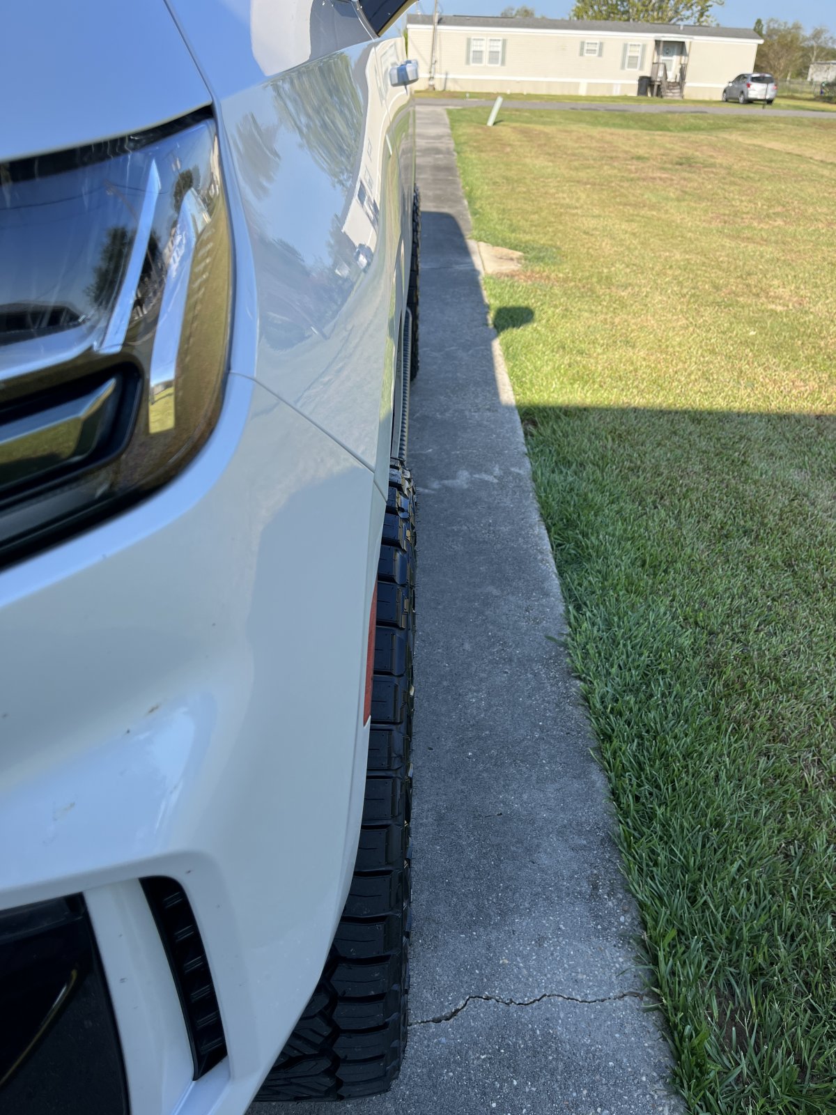

Finally finished… 3.5” RC lift 1.25” spacers 285/55R22 Nitto Recon Grapplers. Trimmed and zip tied felt back. Minor rubbing on sharp right turn. Wife is happy so I guess we good. Love the tires!! I have the Ridge Grapplers on my F250 and I think I’m going with the Recon next.
Yes more rubbing with the spacers, but I wanted to move the tire away from the control arm a bit as it was close. Also like the look of the stance with the 1.25 Spacers.
