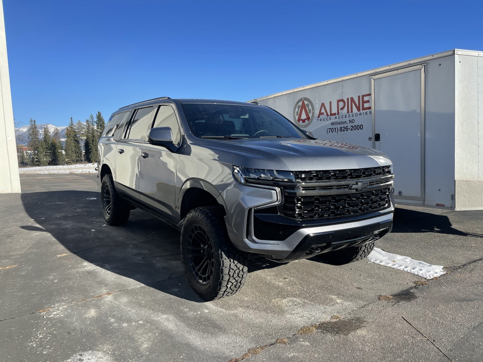

Going to switch things up for the wife soon. She wants smaller wheels with bigger tires. If anyone wants these wheels let me know! 20x9 295/60/20 less than 2k on them!
Z71 standard suspension, removed all red and silver.

what is your location ?
i am looking to pull the trigger very soon on the following...
Ready lift 3" lift w/ arms
20x9 or very close to it wheel and tire combo, and tire choice being Toyo AT 3.
really like you set up and how it fits the rig...nicely done.

Sure that’s stock suspension? Looks like at least a 2” lift.
Either way, looks sweet!!

We are in Montana. 3" for us too. They fit great. I did some trimming on the "cab" side to the brackets and drilled a hole to pull the fender lining back. Used stock hardware so it made it look OEM+.

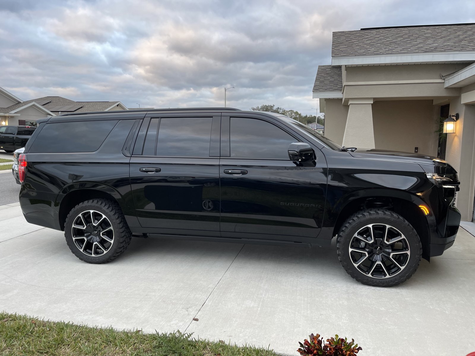

Well here it is. 2” rough country up front only with 33s and Amp steps. Honestly kinda wish I’d have put a larger tire on it and or went with a 3.5” kit. We will see how long this last. We came from a 21 Duramax Denali on 37s. So this thing feels small. View attachment 389532

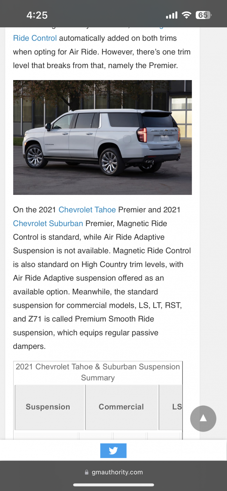

Picture is of details stating Premium Ride Suspension a green light for all major aftermarket lift kits. Magnaride even has some options. It’s the Air Ride Suspension that is a definite no go on all kits. You have to use the Edgymods and air ride z71 bags to achieve any lift and are capped at 3” max and open to all sorts of potential issues with air ride components.

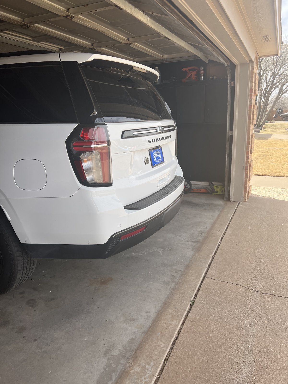

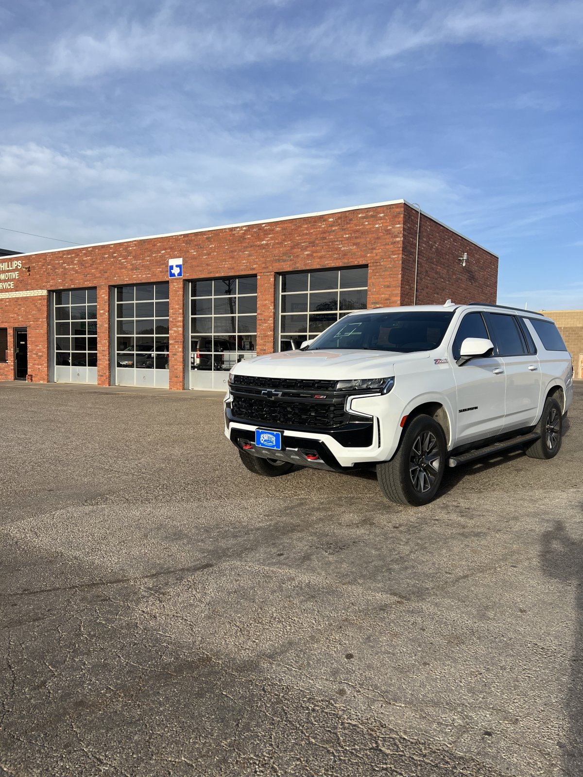

Well fellas of all places a 21 Burban z71 landed 20 miles away in little ol Levelland. Z71 no air ride! Pulled trigger.
It’s on!
Btw for all interested…RC 6” kit and 35” measures 7 feet 1 inch on these new body. RC 3.5” it is

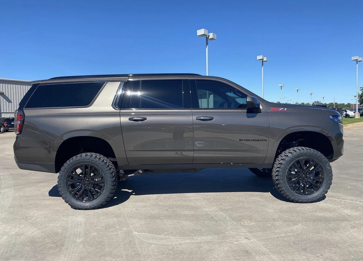

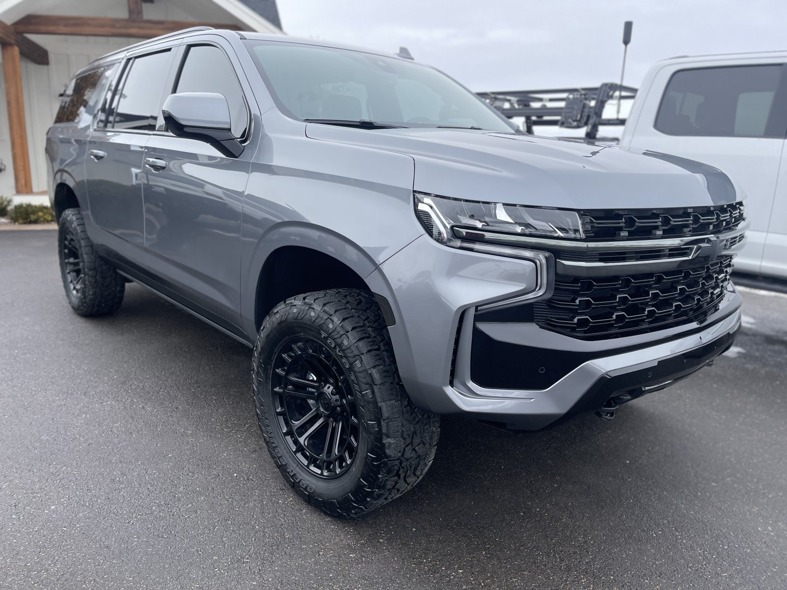

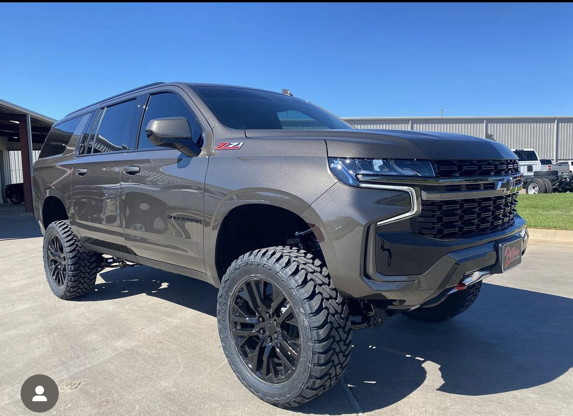

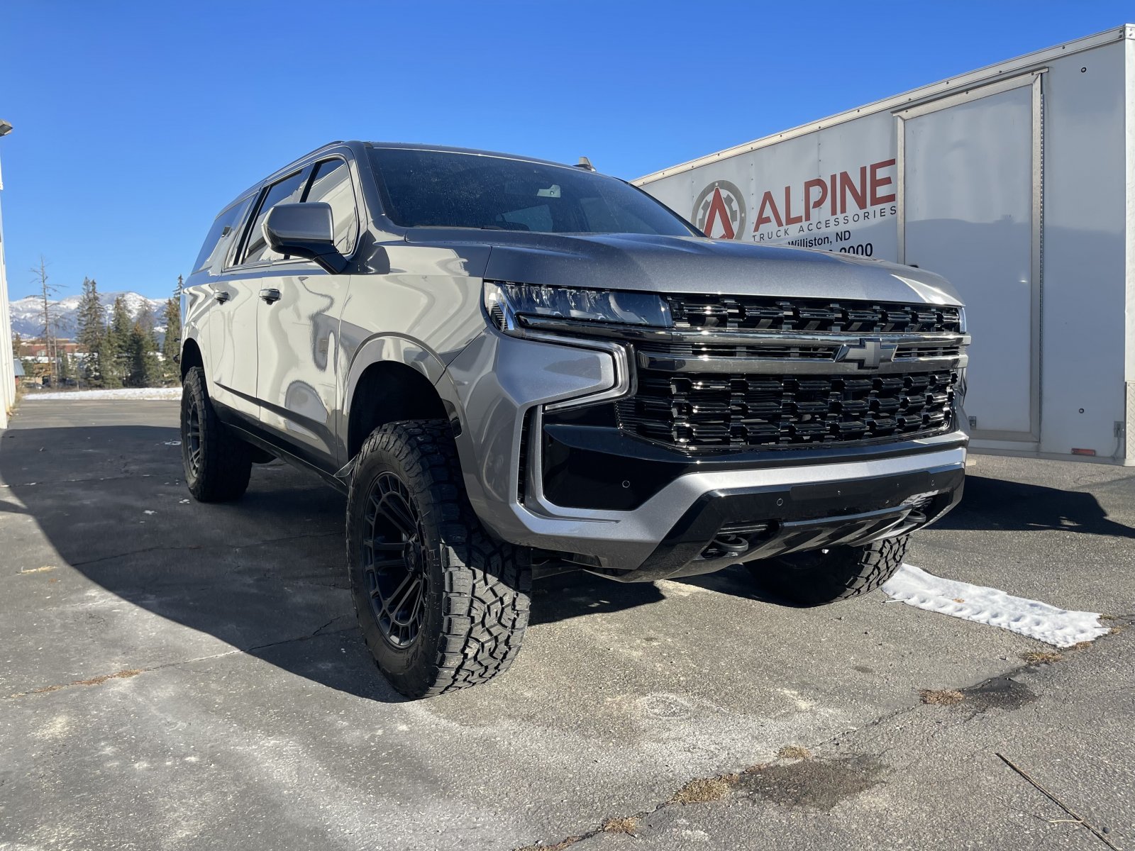

God these things look so mean lifted! 6” RC & 35” on the Brown One ❤️

they do llok good, but in person...the 3.5" with the right W/T combo looks perfect. totally useable in all reagrds, but looks much more sinister.
my 17 stood out everywhere with a 2.5" and a 33.5.
i cant wait to complete this new one, just looking at wheels now.
