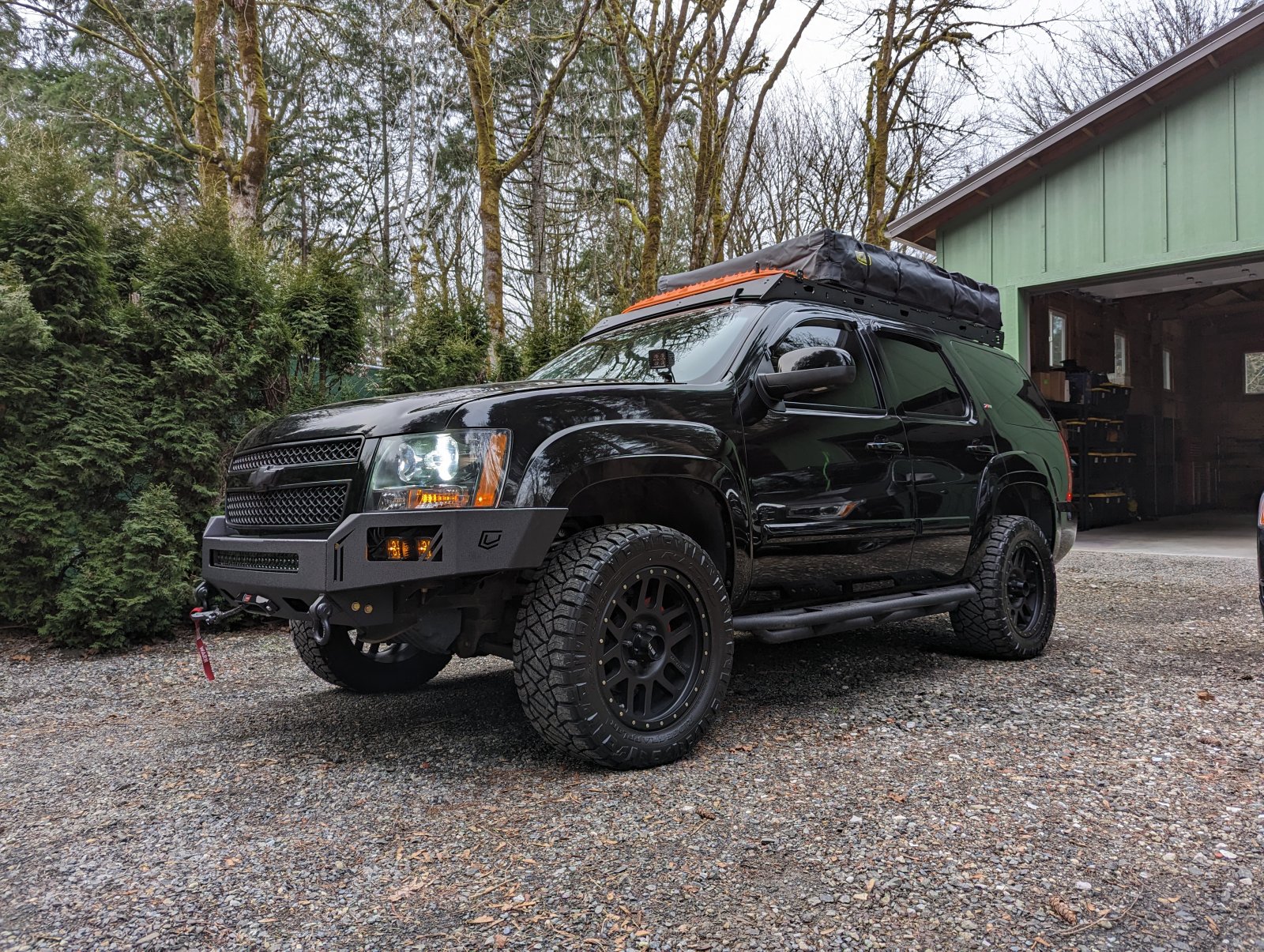

So… I went under the truck the other day and my UCA’s were at a terrifying angle… lol. And… After driving around post level, the front was sitting just high enough to be visibly higher than the rear.
Sooo…. Replaced my upper control arms with some Cognito’s, front shocks went to Bilstein 5100’s and I put a 1” spacer under the rear springs.
Now she’s about 40” in the front, 40.5 in the rear. All the angles in the front suspension look /so much/ better. Is it safe to assume I need to get another alignment? Lol

We’ll post alignment, she rides sweet. Apparently my eyeball alignment was… meh. Camber was spot on, but toe was off the charts and caster was like 6.5 lol. She’s still “out” on caster at 4.5 but we decided equal caster on both sides was better than one side at 4.5 and the other at 3.7

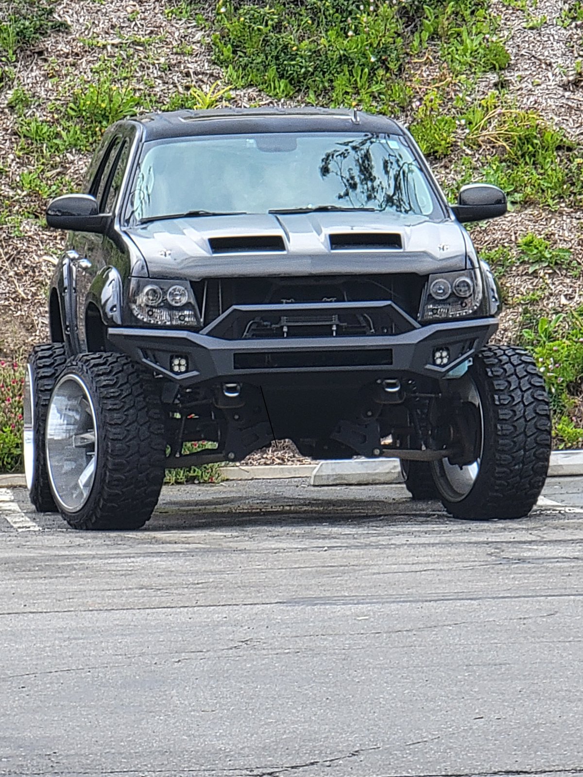

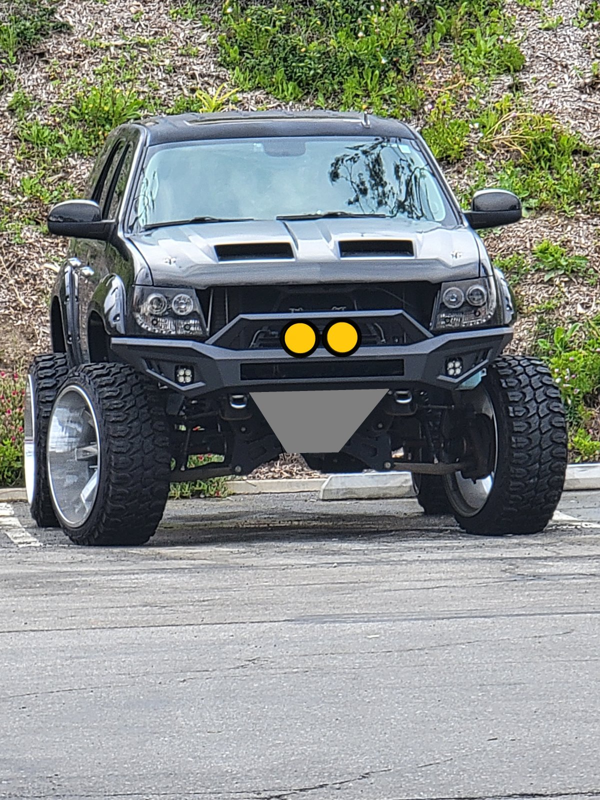

Finally got some good weather to figure out a solid solution to the bottom skid plate mount; M8 stainless nutserts, 50mm stainless M8 bolts, and 25mm stainless spacers. In the meantime, I'm thinking a wider aluminum skid with 5 inch fog lights.
Damn, THAT looks a gooooooood
I like the plans for skid and fogs
You need post more pics of your ride :)
