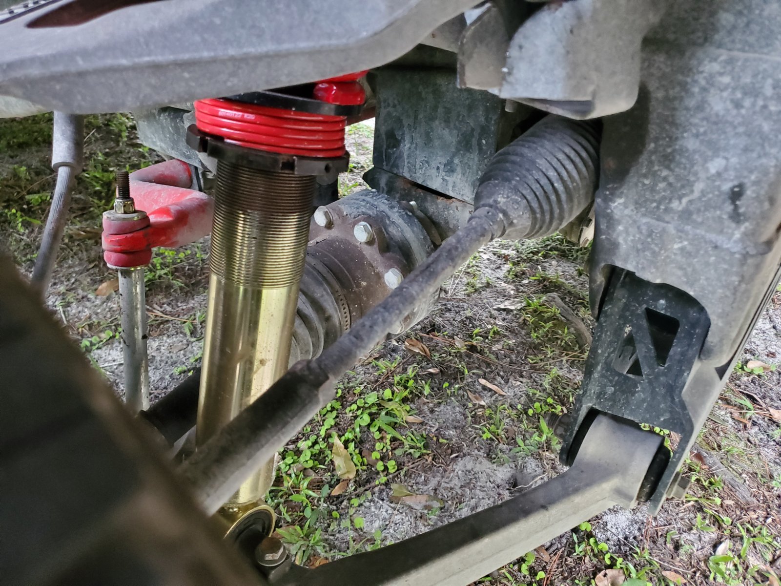

Guess my UCAs aren't too bad with it on the ground, with the front end up its pretty bad. And cv axles don't even like to be turned. Broke down and ordered the RCVs a while ago, not sure when they're coming

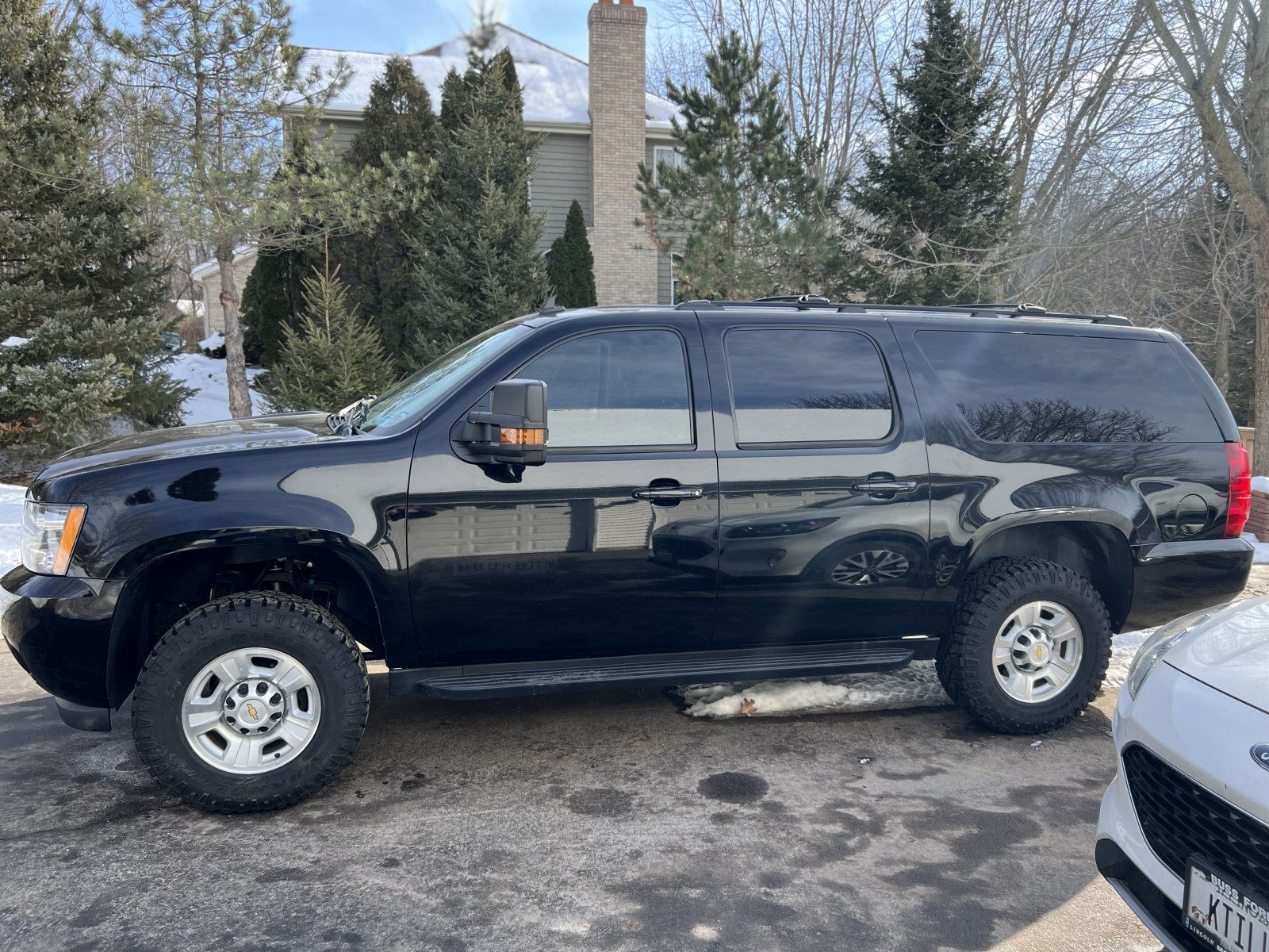

mrpeterclark
Jan 12, 2022
129
153
Boulder, CO

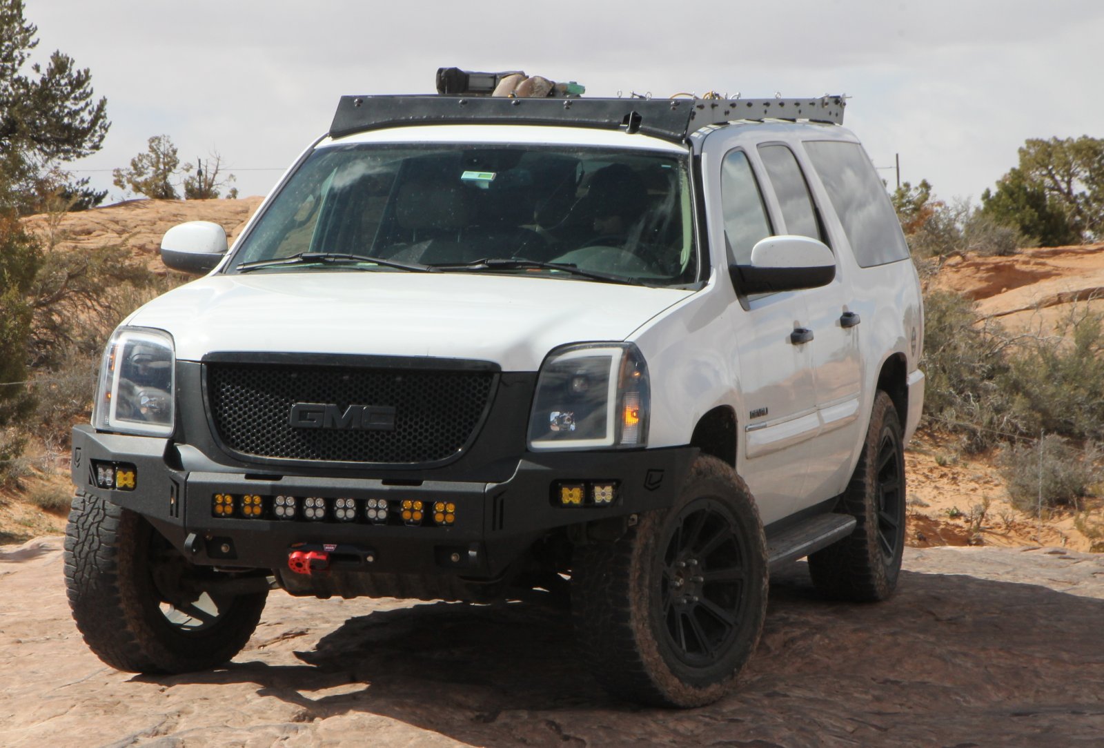

2007 GMC Yukon XL Denali​
Roof Rack - Baseline Overland baselineoverland.com
Front Bumper - Chassis Unlimited baselineoverland.com
Warn EVO 12S w/ Factor 55 flat link
Icon 2.5 Coilovers at 2.5" lift front (71505)Icon 2.0 rear shocks (76526)Cognito Upper Control Arms
Dobinson 2" lift rear springs (C09-045)
Air Lift helper bags (you need 60912 or 60913 for Dobinson springs)
SDE magneride and autoride delete shockdeletes.com
Redarc Tow Pro Elite trailer brake controller
K&N cold air intake
JET Performance Throttle Body
33" Goodyear Ultraterrain tires on Vision Turbine wheels (20"). (for sale in the Boulder, CO area) going to 17s and 35s.​

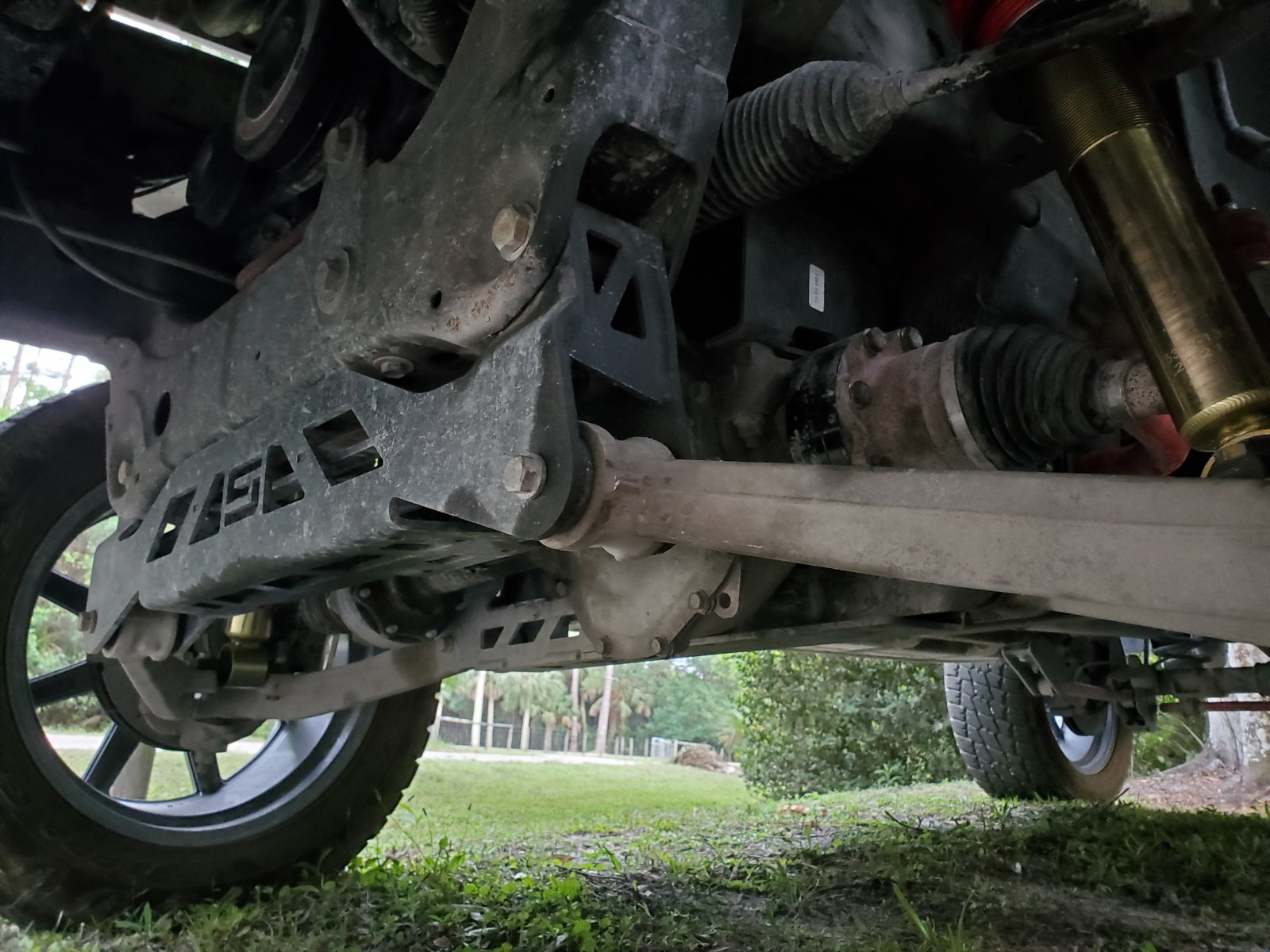

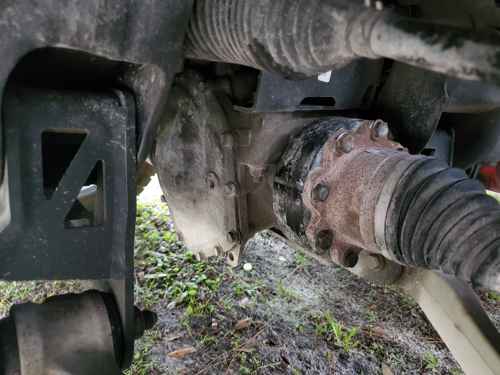

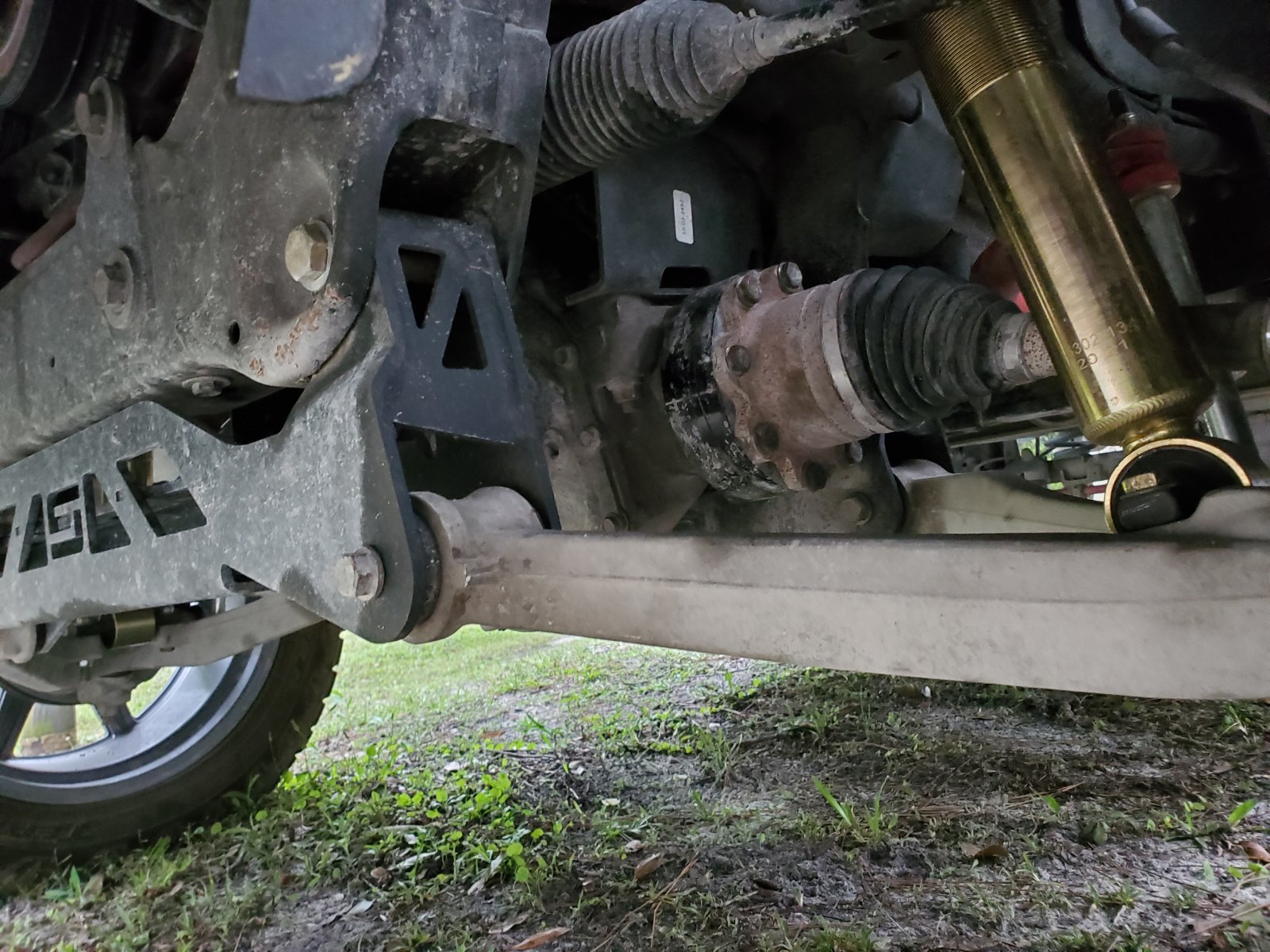

So what was involved with the 14 bolt ifs swap?
Page 4-5-6 should explain, pretty simple except axles lol. Install was done when this was lowered a couple inches in the front.
Rcv axles finally came in after a couple months, they are beefy, prob a couple more lbs than the stockers. I should have ordered them the same size and just used spacers on one side to make up the difference- I guess I could order a spare shorter one and keep spacers with it if needed at this point anyway
A word of warning i guess, these axles apparently just spit grease out, pretty well documented on jeep forums. Heard it gets better after the first 1000miles or so. Kind of annoying but whatever I don't really keep it clean so not a huge deal breaker for me

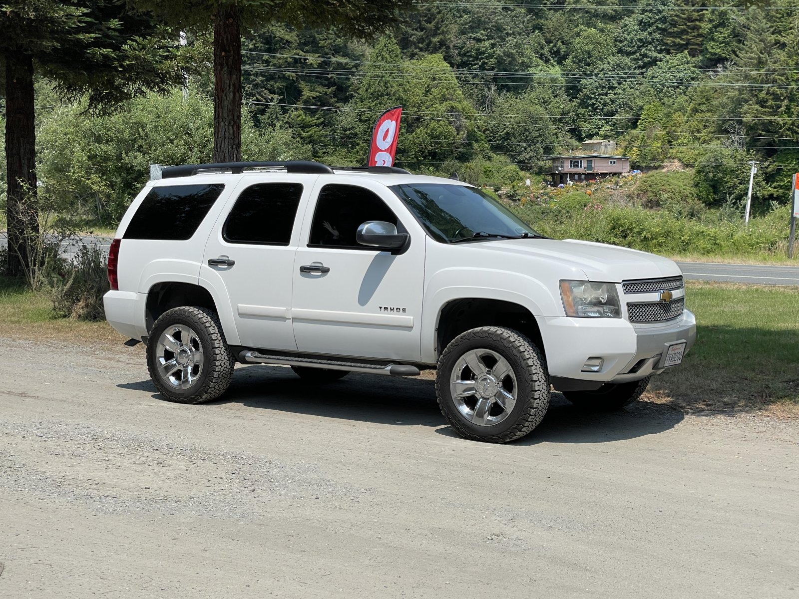

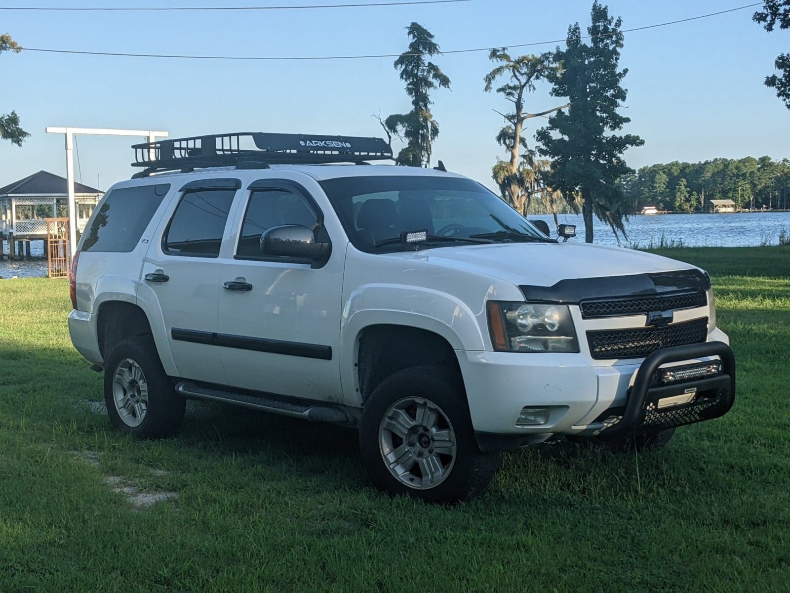

Supreme 3.5 and 3 in the rear. Upper control arm RC. Ordered adaptors for my 20" I want on there guy never sent them so ordering them from a local 4x4 shop so still on factory tires. Going 285s . Beach Buggy.

That doesn't look bad at all, I like it.
You need to post more pics of your Tahoe :)

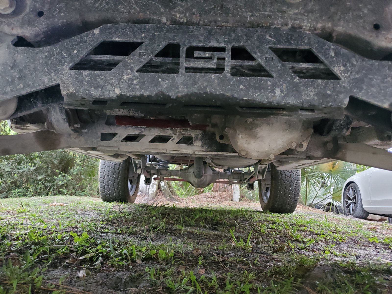

bumper looks good, all them crossmembers tho. prerunner type front skid plate would help*, but those look ugly also imo

bumper looks good, all them crossmembers tho. prerunner type front skid plate, but those look ugly also imo
That's the only thing I don't like about lifting a independent front, stacking crossmembers is not very attractive.
I think a well thought out skid looks pretty good but they are hard to find and find people to actually build them.

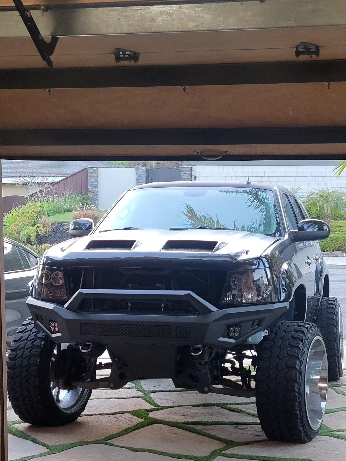

It's a work in progress but I roughed in the skid plate without a bottom bracket support. It's just bolted on top. First pic is skid attached. Second is without from a distance. Still trying to decide on grille options.
skid plate does look much better
