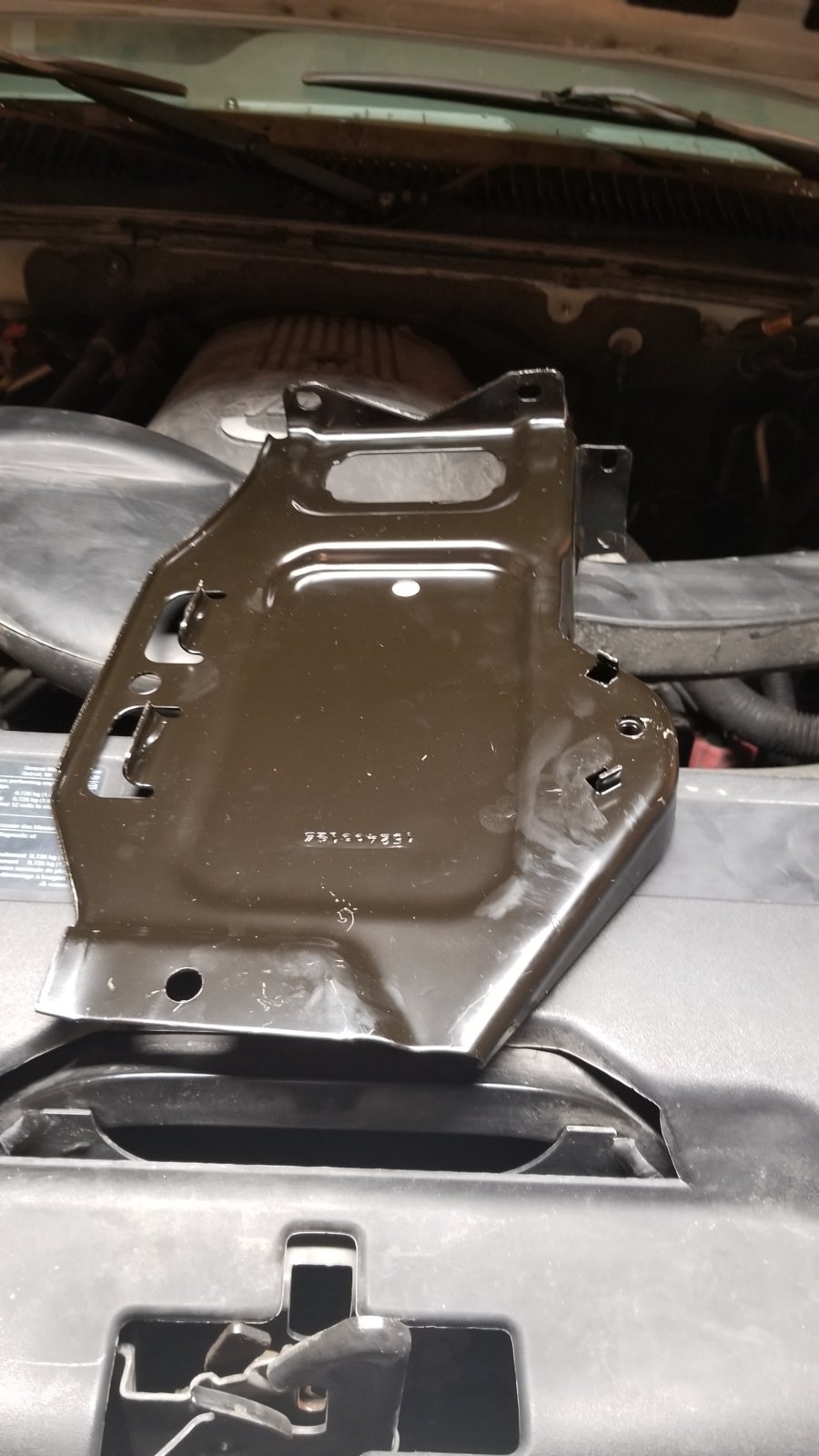

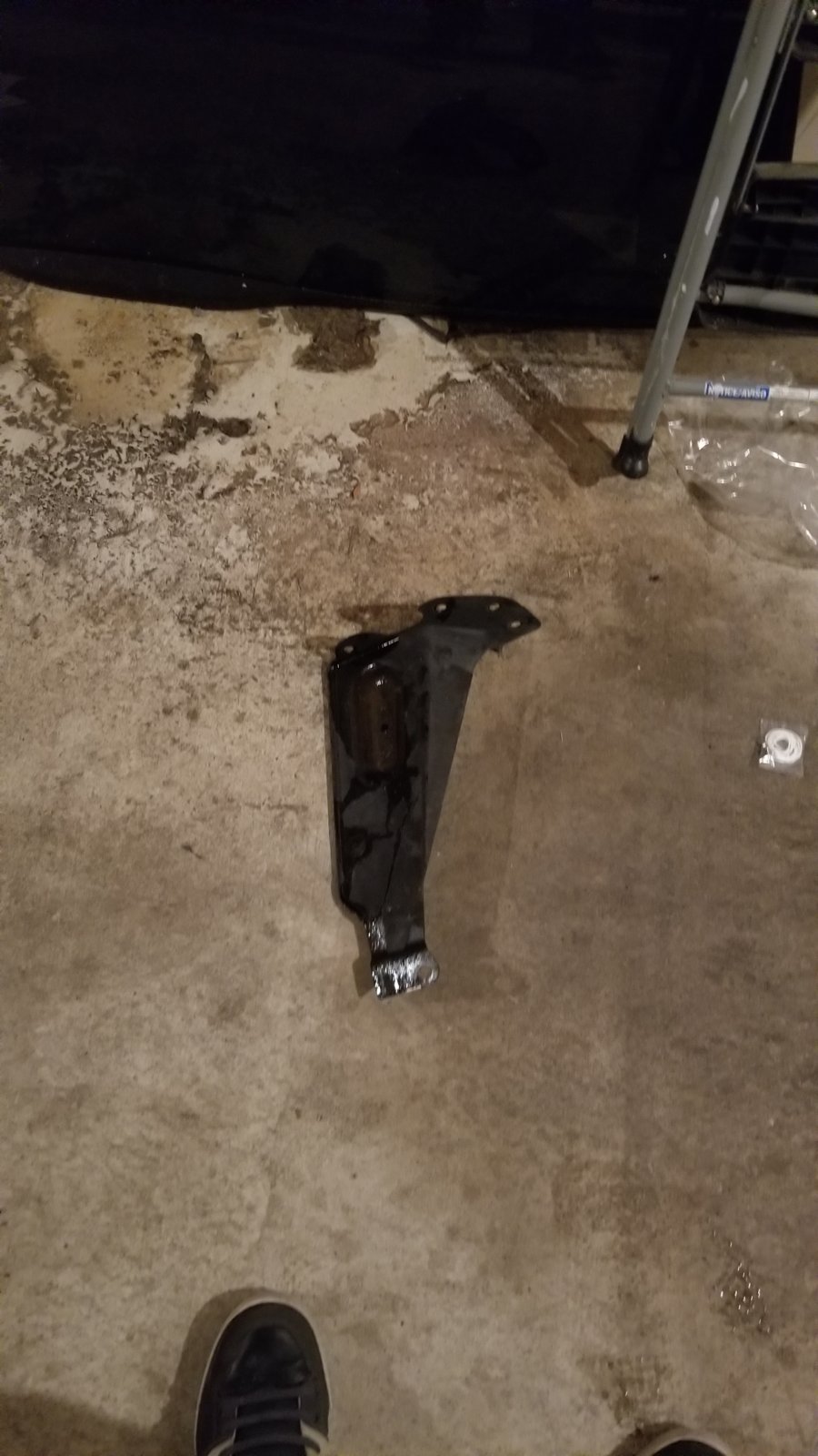

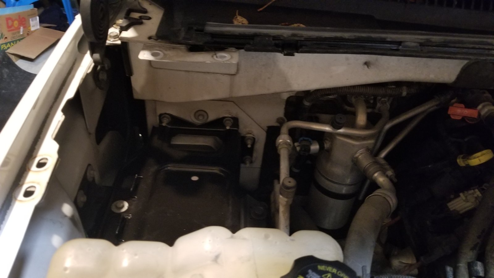

Didnt get alot done today but I did get my second battery tray for under the hood and some stuff for my big 3 upgrade. Mounted up the New bracket/battery tray, spent more time messing with coolant overflow container than getting mount flipped
pulled old one out
This is new one I mounted
Now I gotta get another agm for under the hood and order some more 1/0 wire so i can get it wired up. Talked to my stereo buddy trying to find a weekend to get down there so we can rebuild the amp rack and sub box. Need to get more sound deadner in the truck but being lazy waiting on color matched handles so I can do it all at once.
For anyone who would like to know, In order to add the battery tray. You will need ,The second battery tray out of a 2500 with second battery option, doorman Battery Tie-down and Bolt
1. GM 15246518
2. GM 11509853 (Bolt for Battery Tie-Down)
3. Dorman 00587 Battery Hold-Down Kit
Also note all that is need for install is a 10mm socket, 13mm deep well, and a 3 and 6 inch extension was all that was needed to flip tray over the bolt at front mount of your coolant overflow must be removed, both extensions were used to reach down in between air box overflow, so i could slide it out of the way to install new battery tray.
pulled old one out
Nice plan. I feel ya on waiting to do handles until you have to open the doors up lol. I'm in the same boat.
Please dont spare details or pics on the 2nd battery install. Very interested in this mod, seems pretty simple but I always over think stuff:smh:
No Problems :) if wanted i may even be able to put together a full how to on this process for our tahoes if there's an interest. I just got 20ft of 1/0 wire ordered still trying to figure out what i want to do on my battery setup in the end, Thinking of NorthStar AGM's

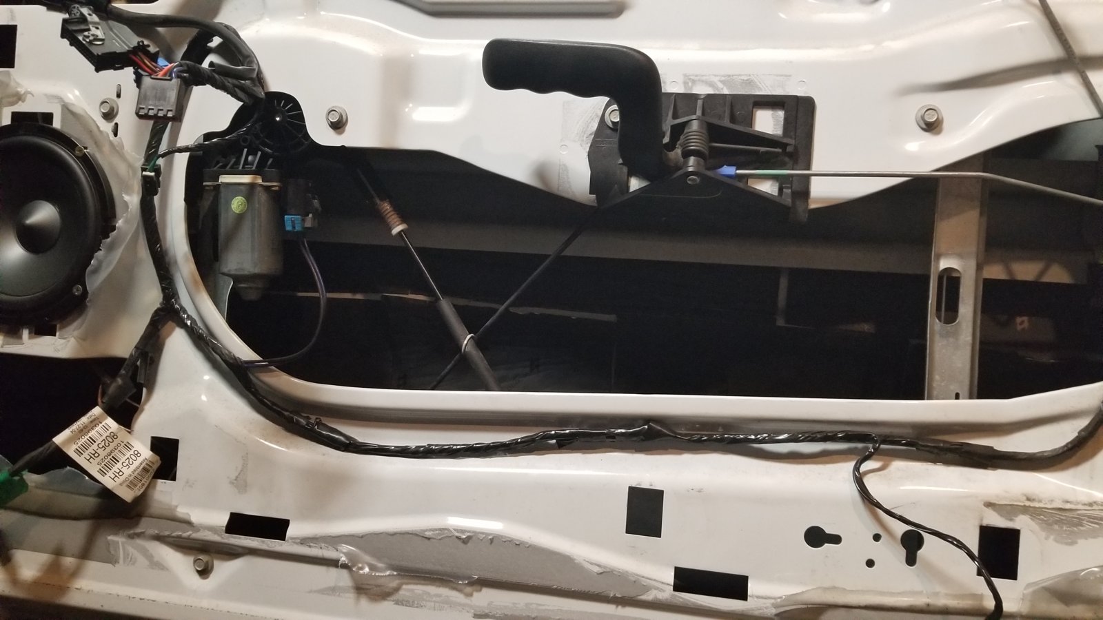

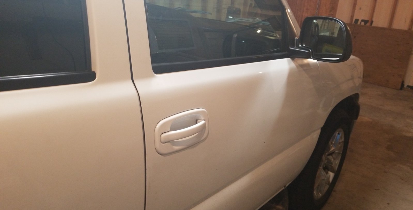

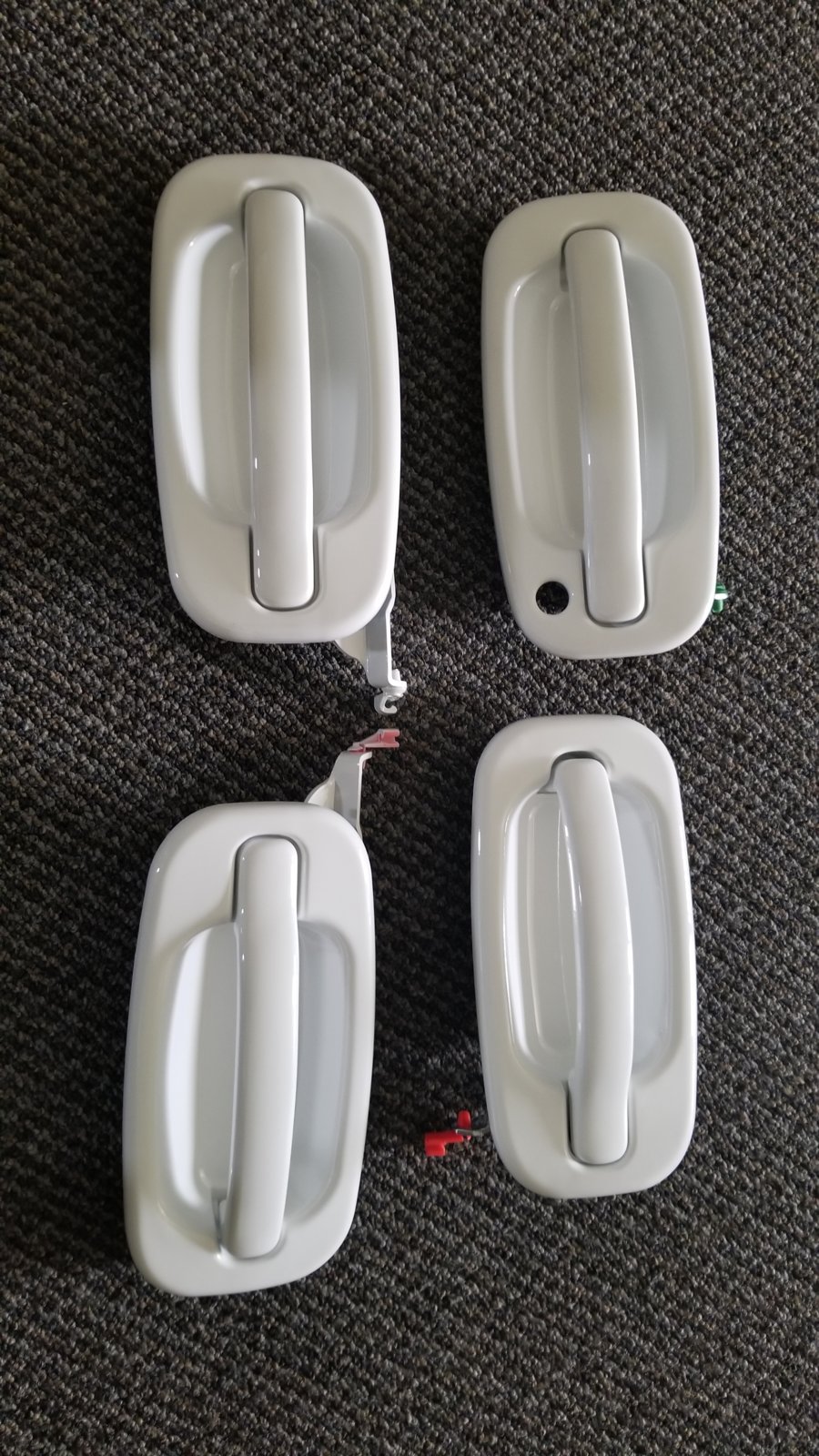

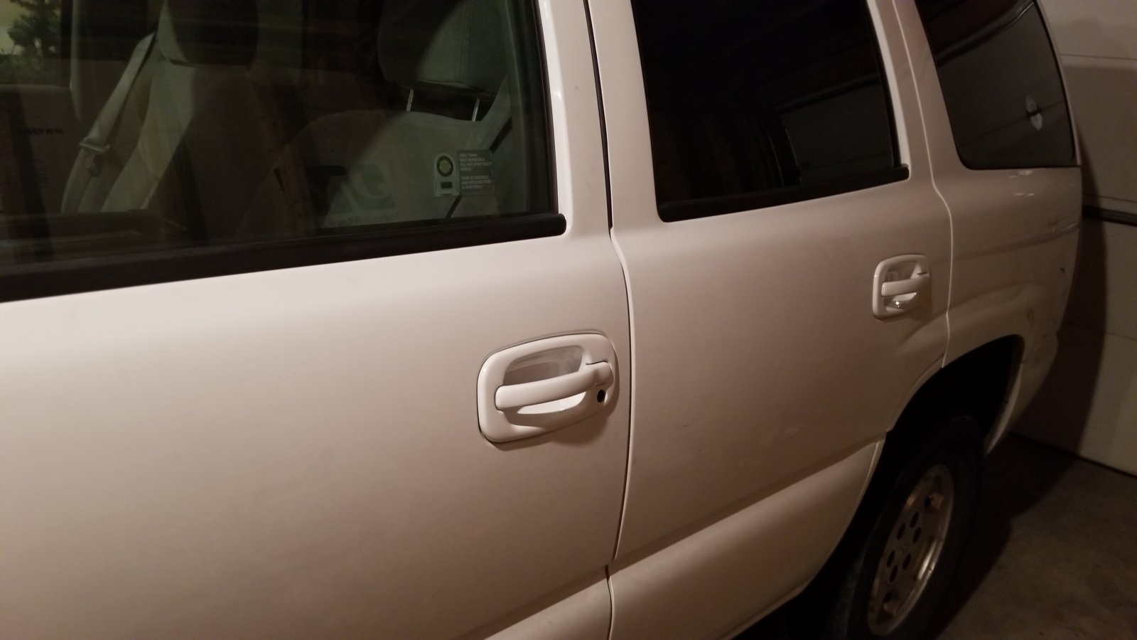

Well I got my door handles back from painter they came out really good, maybe to good for my doors I got my first door opened up changed handle, swivel adapter and a long extension made this possible without pulling regulator or having to mess with window

Productive day today, I got my front doors hit with some more sound deadner, and all of my door handles changed out
need to get the back gate handle down to the painter so I can have them all change out, tomarrow I may get wires ready for second battery under hood

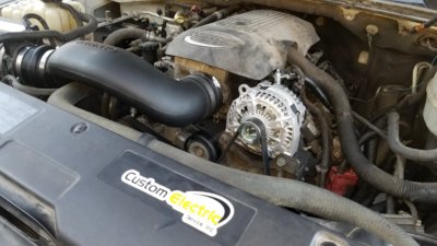

Been busy, but happy Thanksgiving everyone today I was able to get my alt on I ordered a 270 amp Custom Electric Services. The stock cable was to short due to the fact that the post was on the top of the new alt instead of on the back like the old one, I ended up making a new cable from the alt to the battery distribution block. Since I used 1/0 I had to trim out the cover for the block to accommodate the larger lug. Also put my airaid in a couple of weeks ago.
