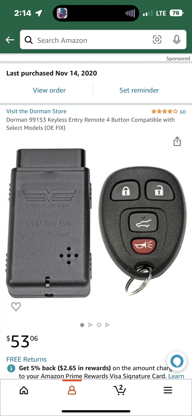

Didn’t use the fob, bought the aftermarket upgrades from boost auto that look like the ‘14+ worked great, no problems out of the fobs either other then the chrome started peeling probably buy the cases i saw linked on here and try to swap the guts into the new case eventually pretty sure you plug in the dongle the horn honks and you press lock and unlock at the same time then you will hear the locks cycle and its programmed, but its been a while. 2C181318-C35A-4FB4-A26D-D1D7B3205D97.png

If you have a tech2 its special function under bcm i believe you should have clear and add as an option, could be under the rcdlr but i feel like that might have been a chrysler programming option but same thing once you start the procedure you just hold lock and unlock. Random thought alot ‘06+ of trucks that had power locks and no fobs were also capable of adding keyless entry for without calling in the upgrade did it for alot of my friends when i worked at the dealership just by programming the keyfobs.
