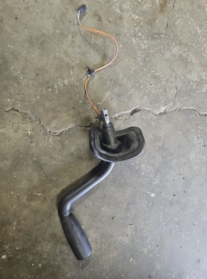

I purchased a new dorman shift lever boot.
Anything I need to watch out for? I don't want to lose any small parts that may come flying out..
I do see a torx screw on top that should release the lever..

the dealer can cut a key from the key code they get from gm
there is no chip or transponder on the key on the gmt800, the HALL sensor is in the ignition housing
as for the boot, I could never get one on over the shifter arm without it ripping
if you remove the shifter arm there's a pretty good chance the tow wire will break unless you are very careful it has to be removed from the harness
the wire is thin and already weakened from the up/down movement of the arm.

I replaced the shift lever on my 99 Silverado because the wire had broken for the tow_haul mode.
This was around 2019 maybe and also used the Dorman version. No issues. I don't recall any complications replacing it.

Great tip, I totally forgot about the tow mode button! Will look for the harness connector before removing...
