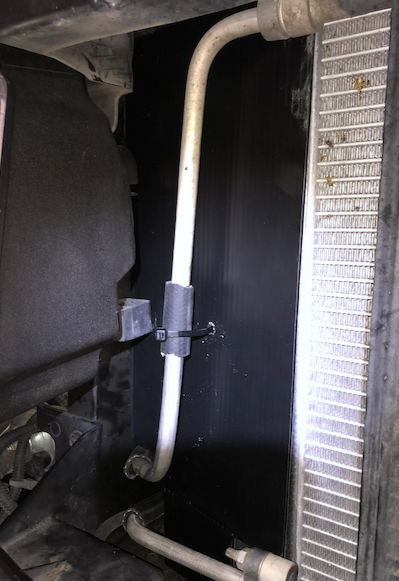

Replaced the baffles beside the radiator this week with black coroplast, zip ties and some rubber hose to protect the A/C piping. Hopefully it will help with cooling effectiveness. Heading over the blue ridge again tomorrow afternoon with the camper with a full water tank for boondocking, and it's gonna be warm. We'll see if the new setup makes any difference to transmission temps. I'll report back here with the results.
Sparksalot
Sep 20, 2020
6,775
20,587
Bastrop County, Texas
Between the bafffles I made and ensuring both fans were running, mine stayed very nicely cool on my last trip.
I am definitely interested in how much of a difference this makes.
Mine have been MIA for a while, but I don't really do any towing.
I have a decent sized external transmission cooler I put on the Burb to replace the factory Auxiliary cooler but it isn't as big as a 40k...
You can see it is the black one in the center, not the silver one on the passenger side.
My transmission, once up to operating temperature, runs consistently 80° above ambient temperature.
